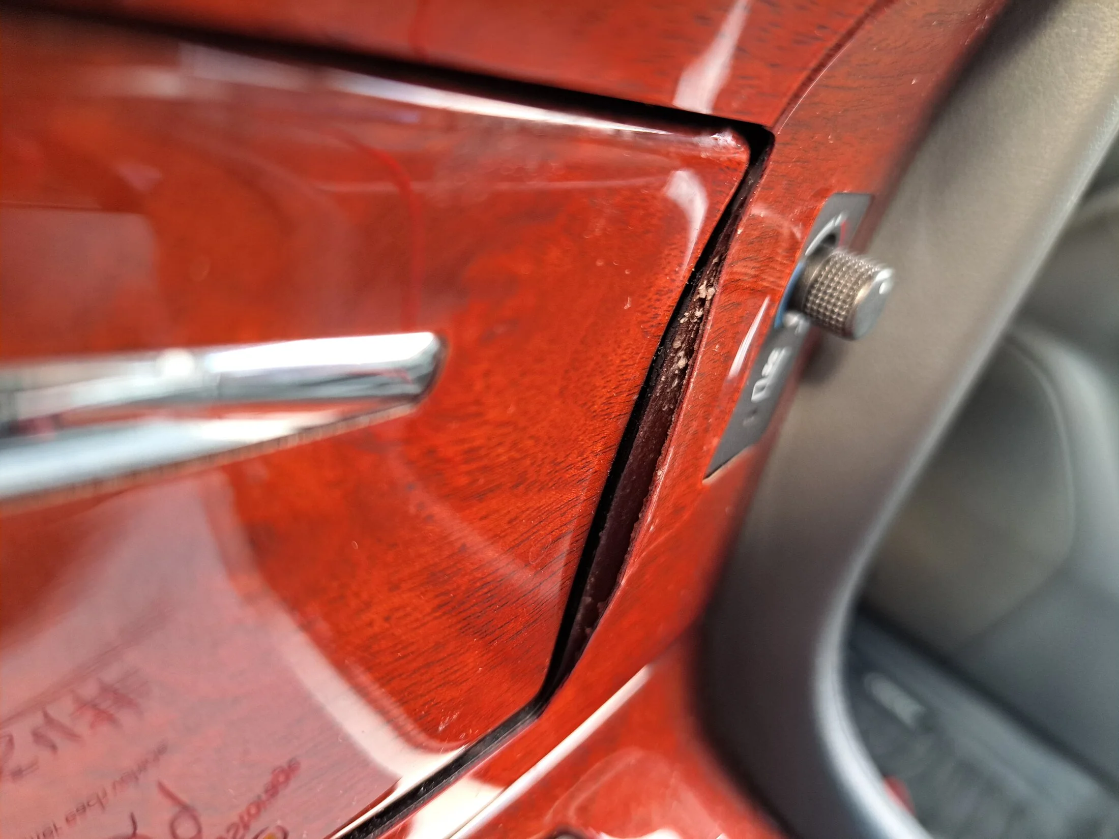

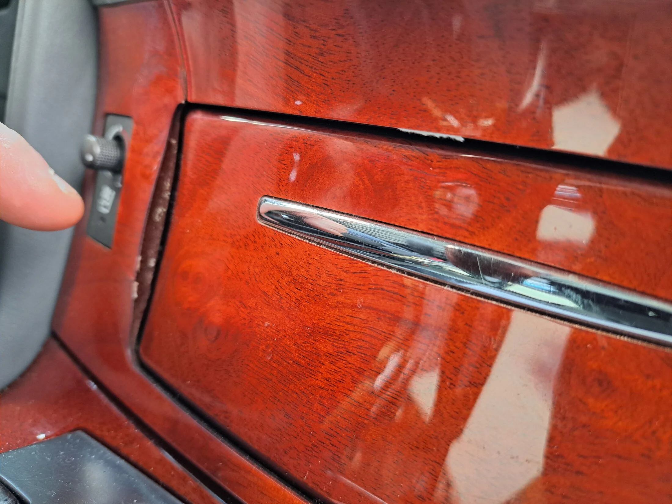

Anyone do anything about this veneer lifting next to the ashtray? 2010 lx570
How did you get it to hold until the glue set up? Painters tape?
Gorilla glue sets in like 30 seconds so I just held it in place. Glue has held for a few years now
