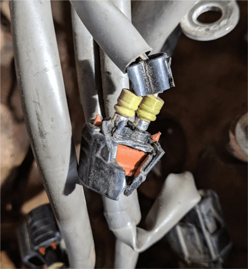

In replacing a friend's starter (2006) today, we found many damaged electrical connectors from a previous life - most missing retaining clips. One completely disintegrated, and I'm hoping to replace it prior to reassembly. Anyone have tips on where to find replacement connectors?

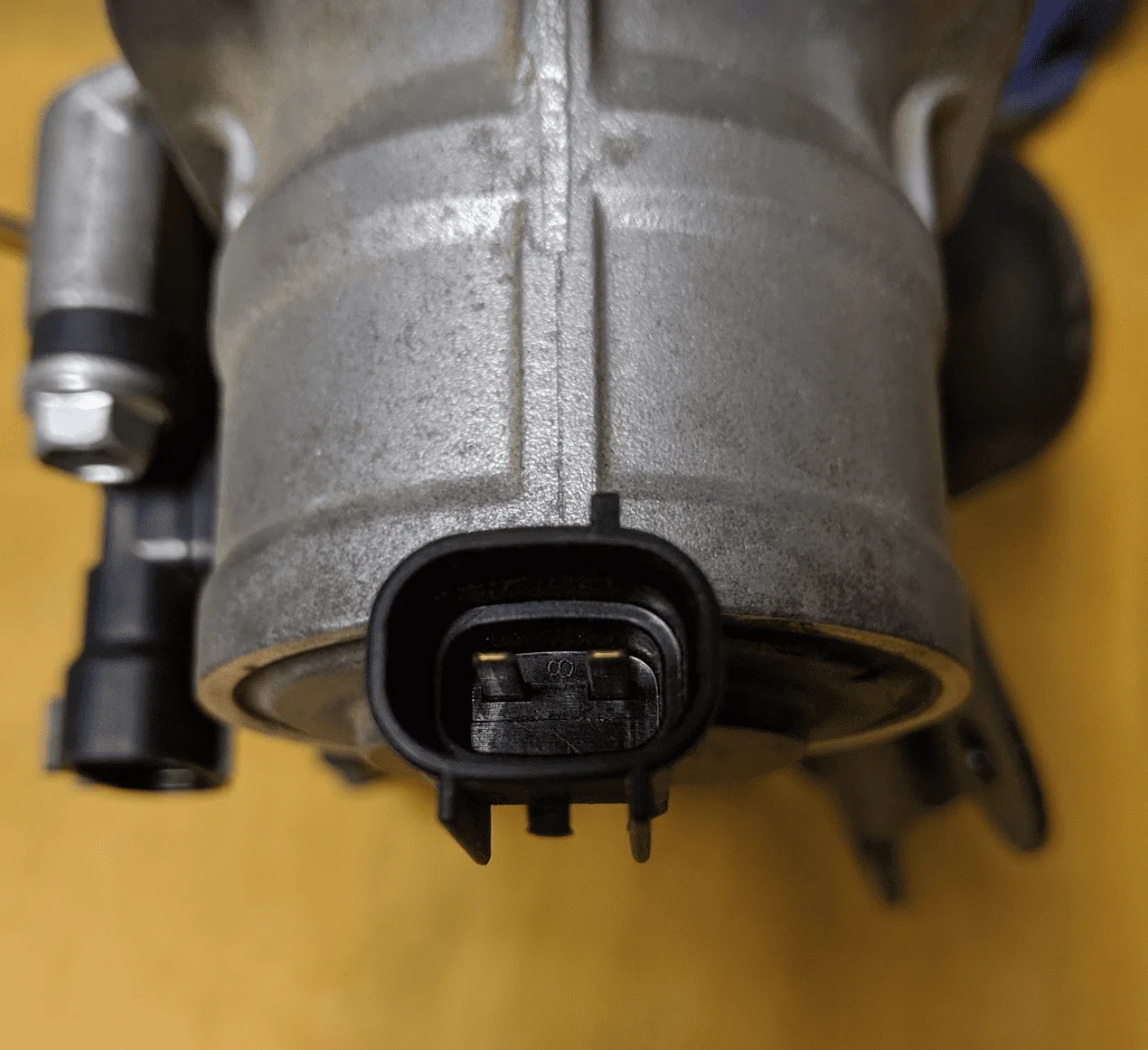

The highest priority one I'm looking for goes onto a component of the "air pump assembly w/ bracket," on 2006+ engines w/ VVTi. It's a 2-wire connector located under the intake plenum. See photos.

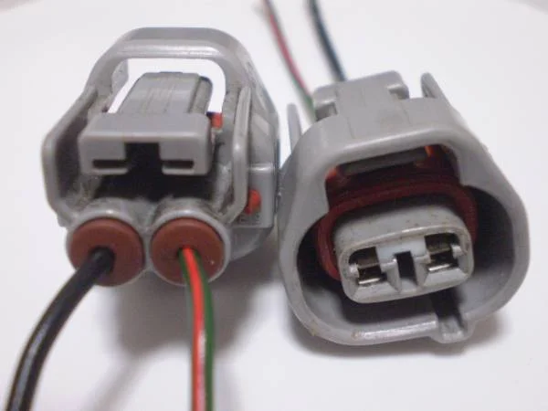

Is this the one? I can't tell for sure. The color is often different so don't go by that.
Edit: Maybe this one (90980–11149)

That main one looks like the connectors for vacuum switching valves. Most Toyota’s have them. Camrys are right under the top plastic engine cover. They are the same size but the blades make them slightly different. You could match up the connector from a junk yard if need be.
