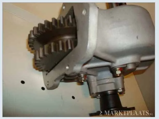

The winch (last Photo) is complete but I need all the things from the first two photos.
Gearbox / Shift / Lever.
Rufst mal beim Diebo an, der dürft das haben......:hhmm:
What parts are you lacking? I can't tell from your pix, it looks to me like it's all there. Is that 2 different winches?
The first two pictures are only examples from an auction in the Netherlands, in the moment the bit is up to 2300 Dollar for the whole stuff
It´s only to see what I need.

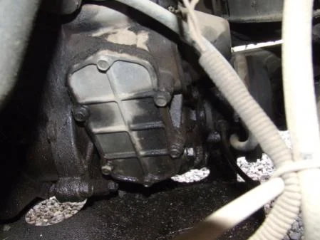

Here´s a picture from the cap at the gear box, difficult to look at without a hoist, almost broke my neck. The second photo shows the box I´ll need , Photo taken from the aution in the Netherlands ( Bit is around 670 Dollar for the Box in the moment..... grazy)
Some of the MUD supporting vendors sell PTO winch parts. Check with Spector Off Road (Specter Off-Road, Inc.-Landcruiser Parts & Accessories) or G&S cruiser parts (G&S Cruiser Parts). You should also pull the PTO cover plate off your transfer case and make sure you have the PTO gear in your transfer case. I don't know about the 40 series, but not all the 60 series come with the gear installed.

drop the skid plate, 6 bolts, then you might need to drain some oil out of the transfer case, then remove the bolts on the side cover.
MAKE SURE YOU CAN GET THE TRANFER FILL PLUG LOOSE FIRST BEFORE DRAINING OIL.
@mbb
thanks for your advice. I`ll try to open the cap but it will be very exhausting for an old man like my to corkscrew my bones to reach the bolts without a car lift.
I''ll strongly second 2mbb on making sure you have the PTO gear in the t-case before ordering a PTO drive from anyone. If you think you'd have a hard time dealing with the cover, that is nothing compared with installing the gear.

As I recall, PTO gearboxes weight just over 27 lbs. Shipping to the Canary Islands (Spain) from the US is about $95 US using USPS international shipping. A PTO gear/spacer for the t-case is about 2 additional pounds.
