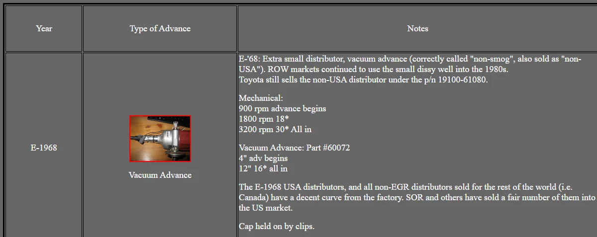

I may be wrong but based on coolermans website and some research, I'm pretty positive the distributor is vac advanced. Again, could be wrong.

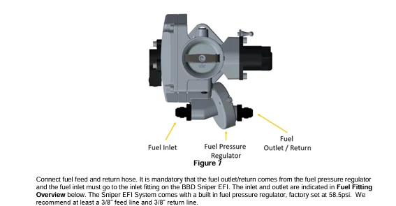

Fuel pressure? Are you using the internal fuel pressure regulator or the remote GM one? Disconnect vac advance to see if that helps. What is vacuum at idle. Where do you have your O2 tapped in?
I'm using the Walbro GCL611 external fuel pump and the EFI has a factory set fuel pressure regulator set to 58.5 psi.

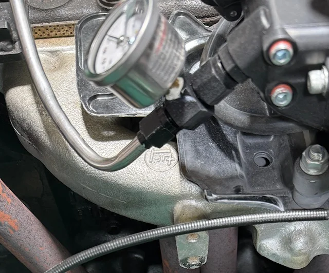

Definitely worth putting an external fuel pressure gauge on. IIRC the O2 sensor should be around 8” from the collector.
I use this Earl’s adapter and pressure gauge… it is always rock steady at 58. This is my 2nd gauge…after the first hour or so of running the original gauge popped the glass and the oil filled case drained onto the block. Holley exchanged it quickly. My O2 sensor is 6” from the three bolt flange after the header and up about 15* from horizontal]
