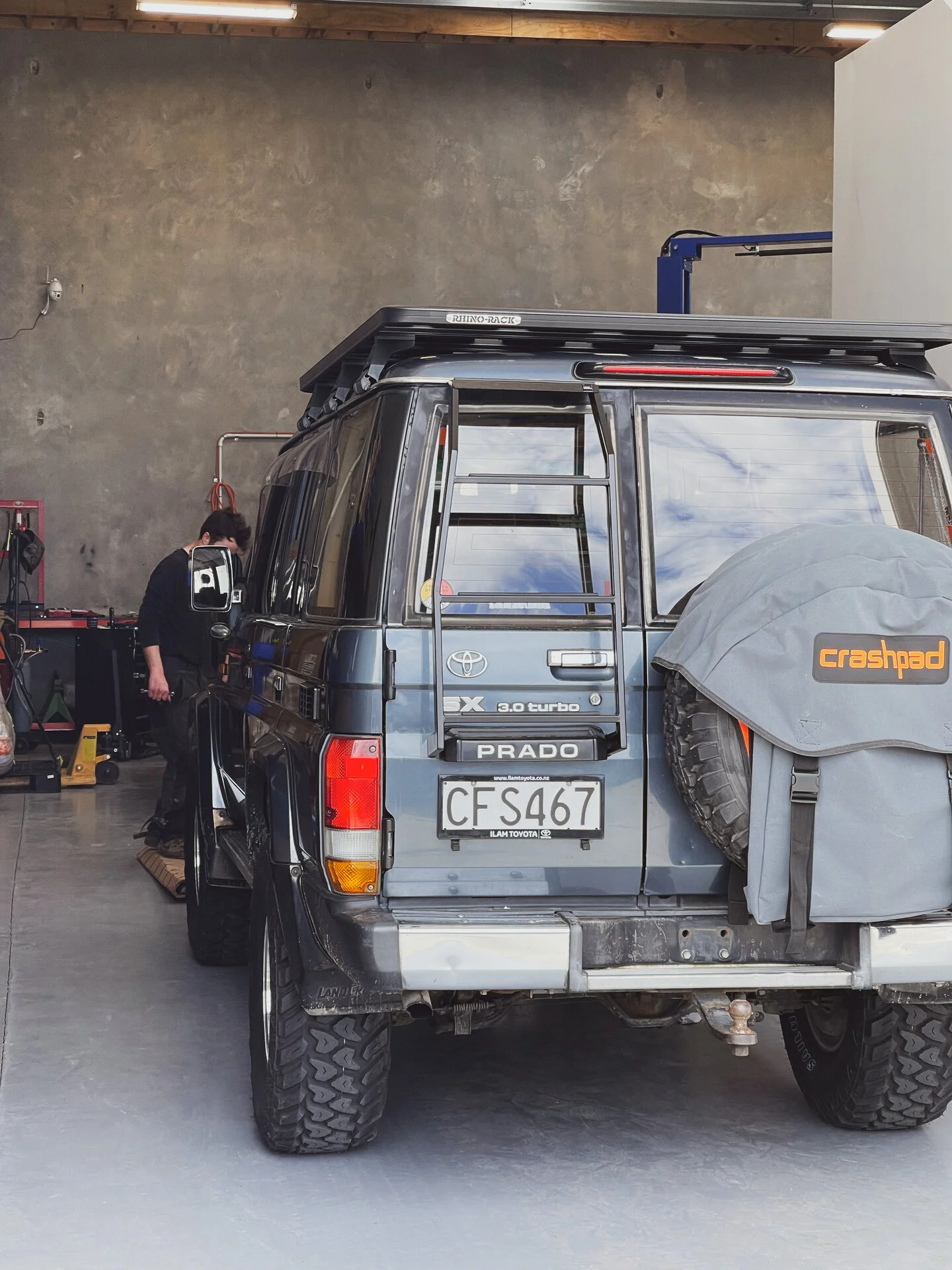

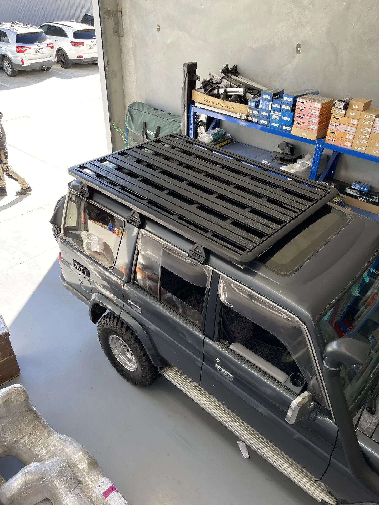

This is what I got for my troopy.
42104BF - 84"x56" Pioneer Platfrom - Flatpack - Unassembled
RL210S2 - Gutter Mount Leg Set x 3
I've seen the 72" x 56" size mounted on a 60 and should work for a 77 no problem. Depends on the length you want.
There may have been some other bits, I think the Vortex bar to RL fit kit for each leg, but I think that's it. Etrailer usually has a good range of what is needed from RhinoRack and also had the best prices that I found.

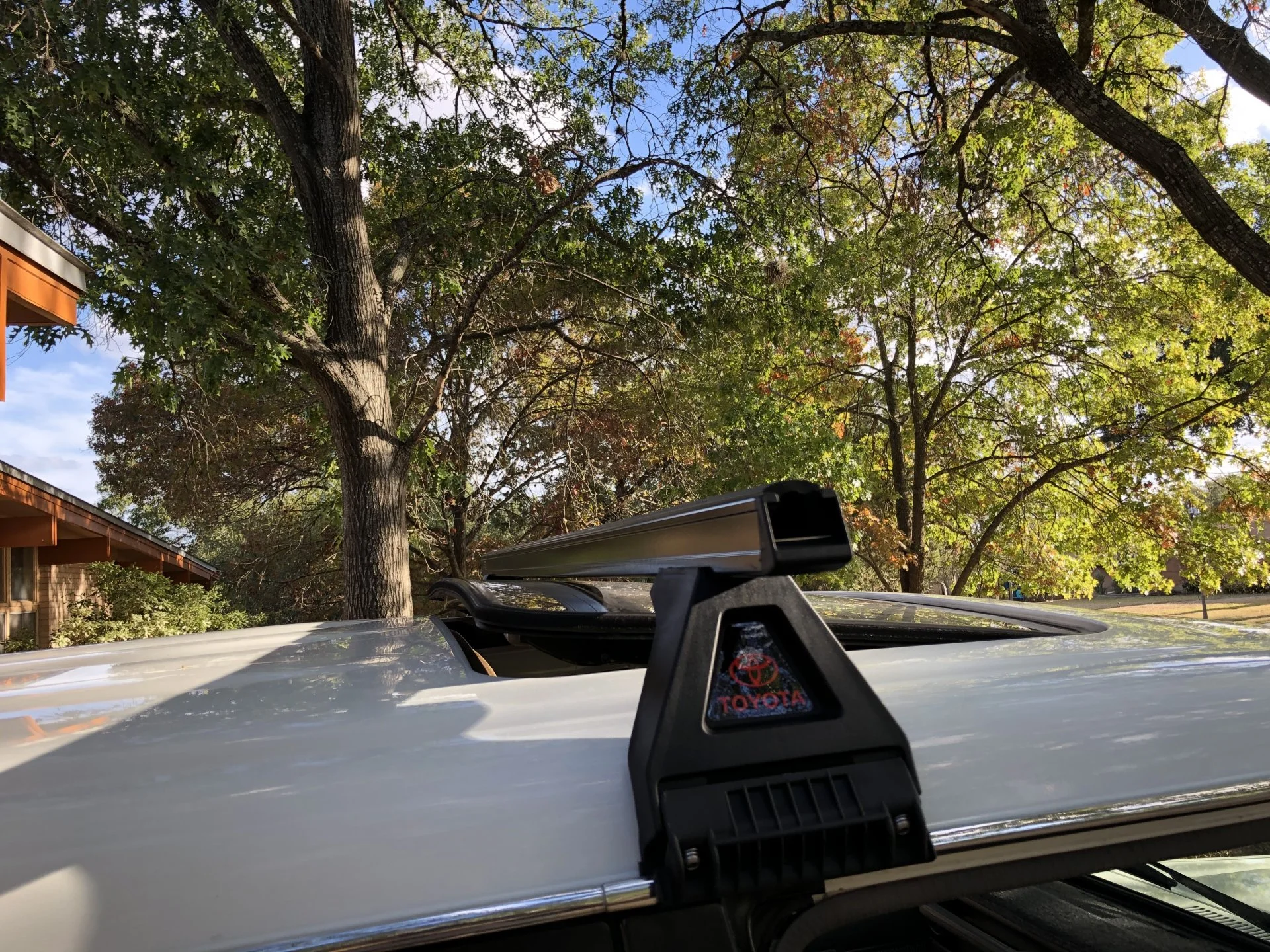

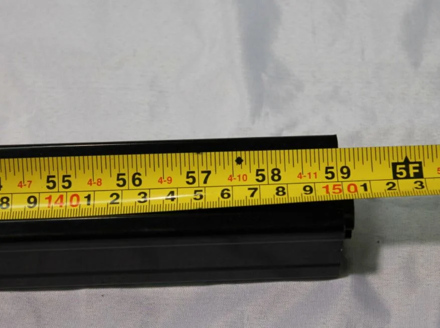

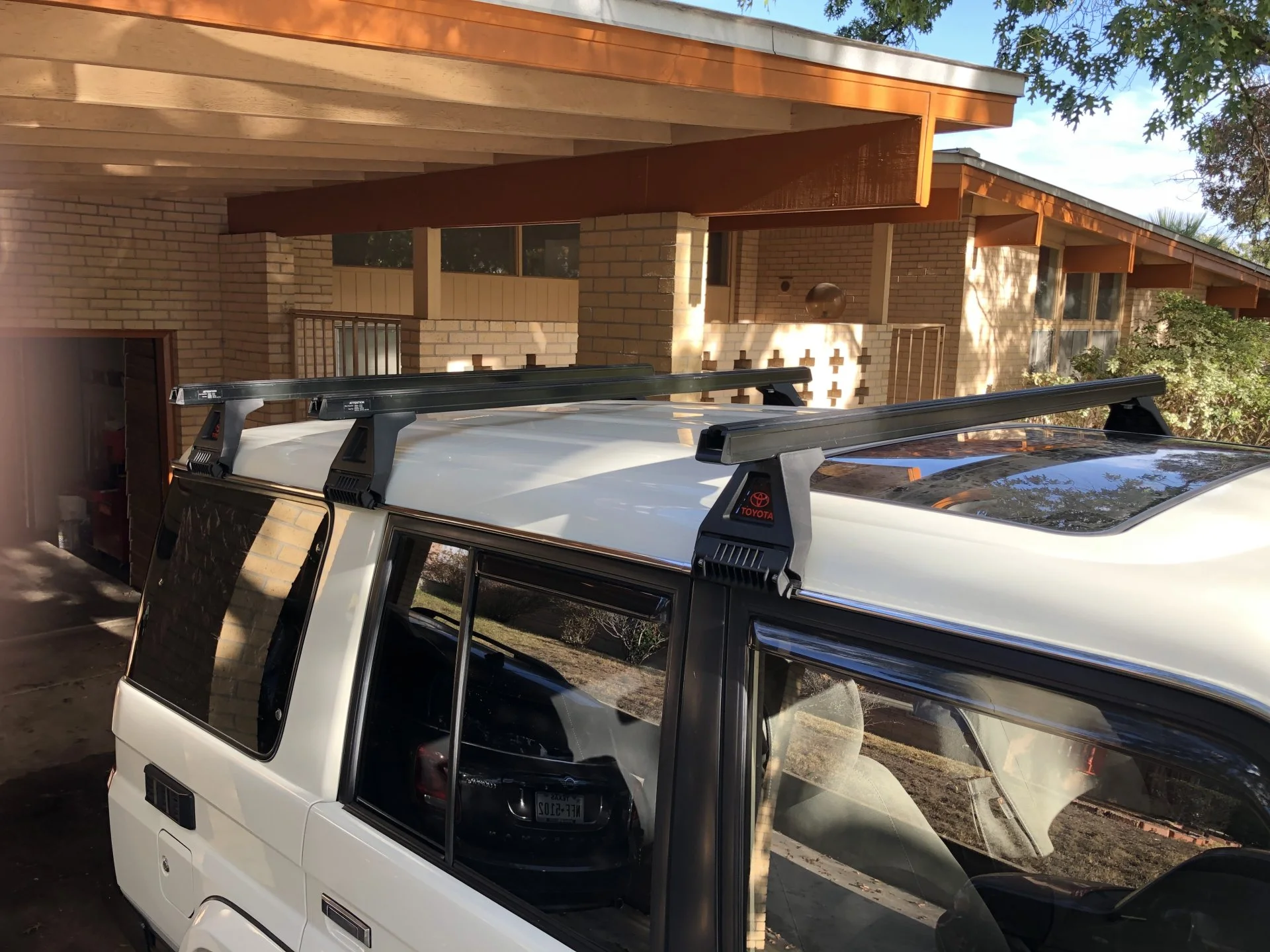

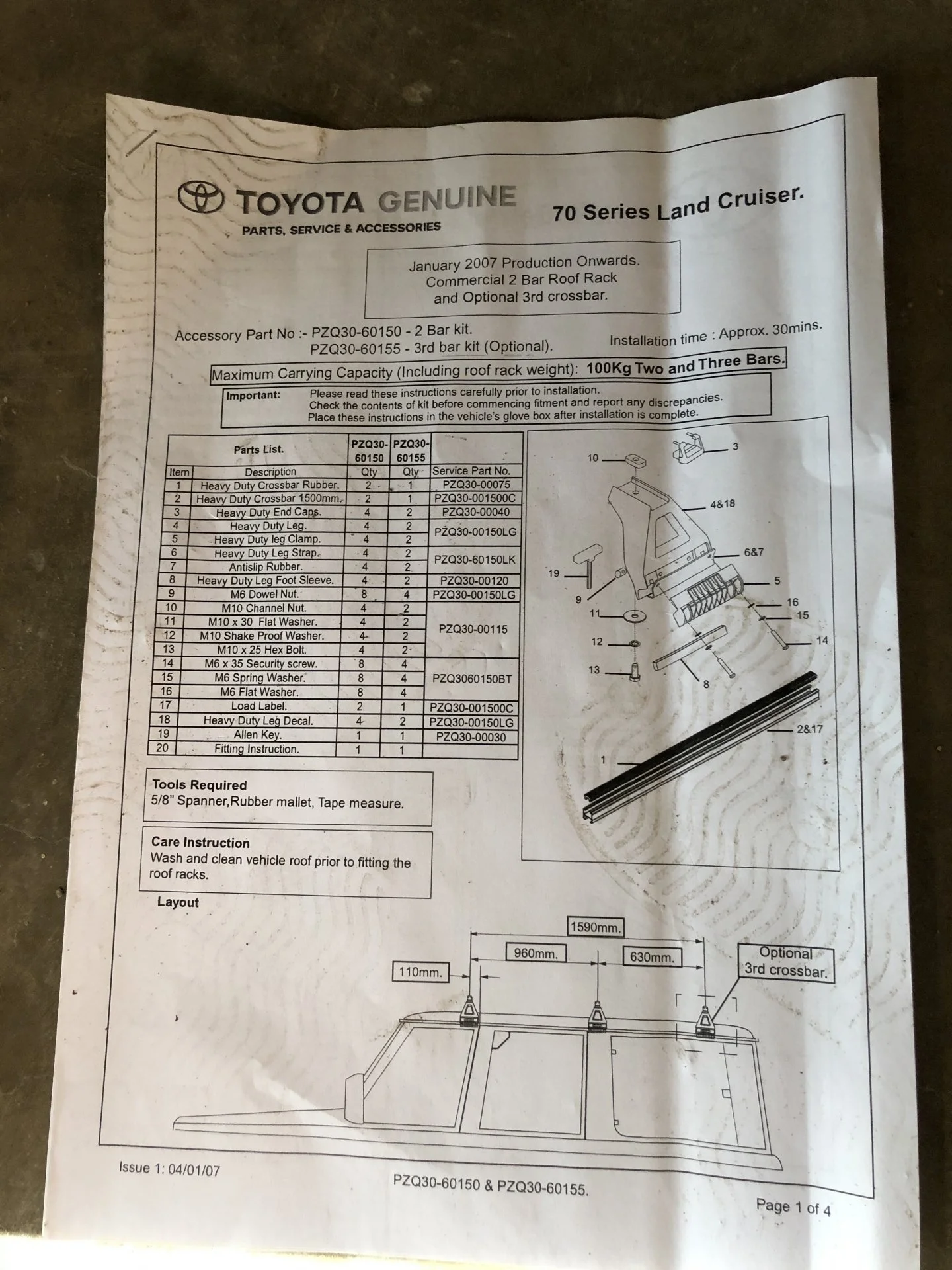

The rack with the Toyota badging that I am using is actually RL150 Rhino intended for the 76 series in the Australia market. Same size for the HZJ77.
The bars from this set up measure at 1500mm (or 59 inches).
Here are some photos. It clears the factory sunroof perfectly.

That is correct, and I think the troopy roof is higher than a 77. So, OP could use the pioneer rack I posted with the RL150S gutter mount legs.
