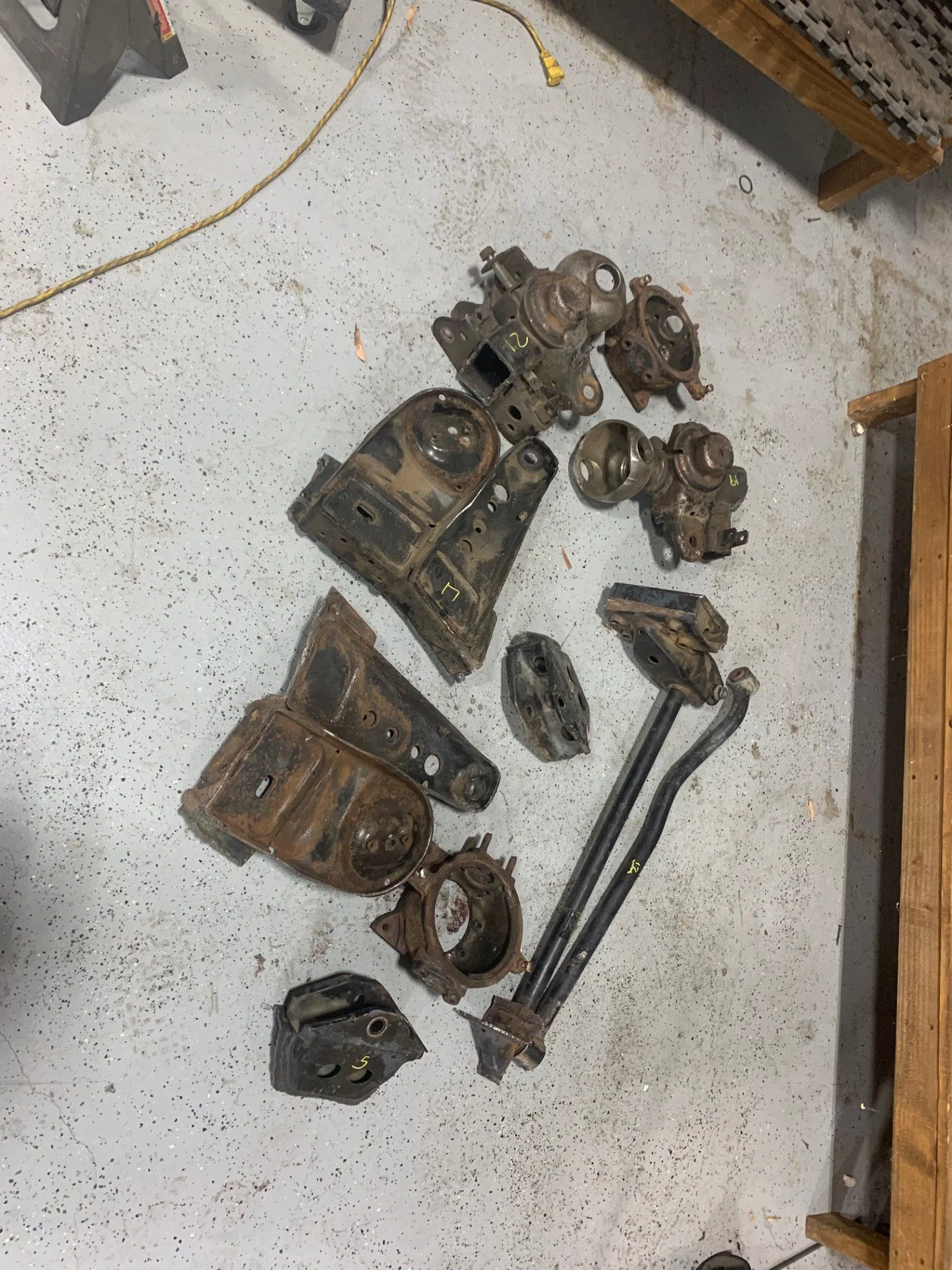

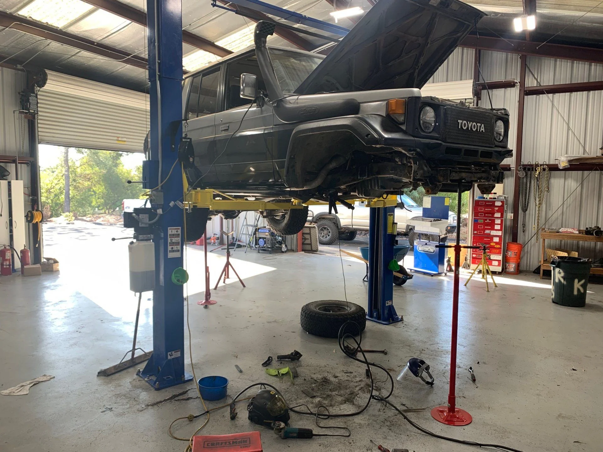

The fun has begun, scabbed a bunch of parts off an 80, got some more coming from dave at japan 4x4, started to burn off the leaf spring brackets. Burned a hole in my shoe and decided to call it a night.
Love that shop!
@saltycoconuts don't jump on that just yet, the deeper I get the more obvious it is the 80 stuff won't work that well on the 70. Having never owned a 60 so I can't compare exactly, but if its anything like the 80, it is quite a bit different then the 70, and would require a great deal of fab for those parts to work on the 70 frame, especially with the RHD. Been meaning to start a separate thread, but waiting until I get a little more progress. I ended up going Ian's route and ordered a bunch of the bracketry off the 79, waiting for it to come in so I could really compare side to side to the 80 stuff. I'll let you know when i get some parts in and have it somewhat mocked up so you can come by and check it out.

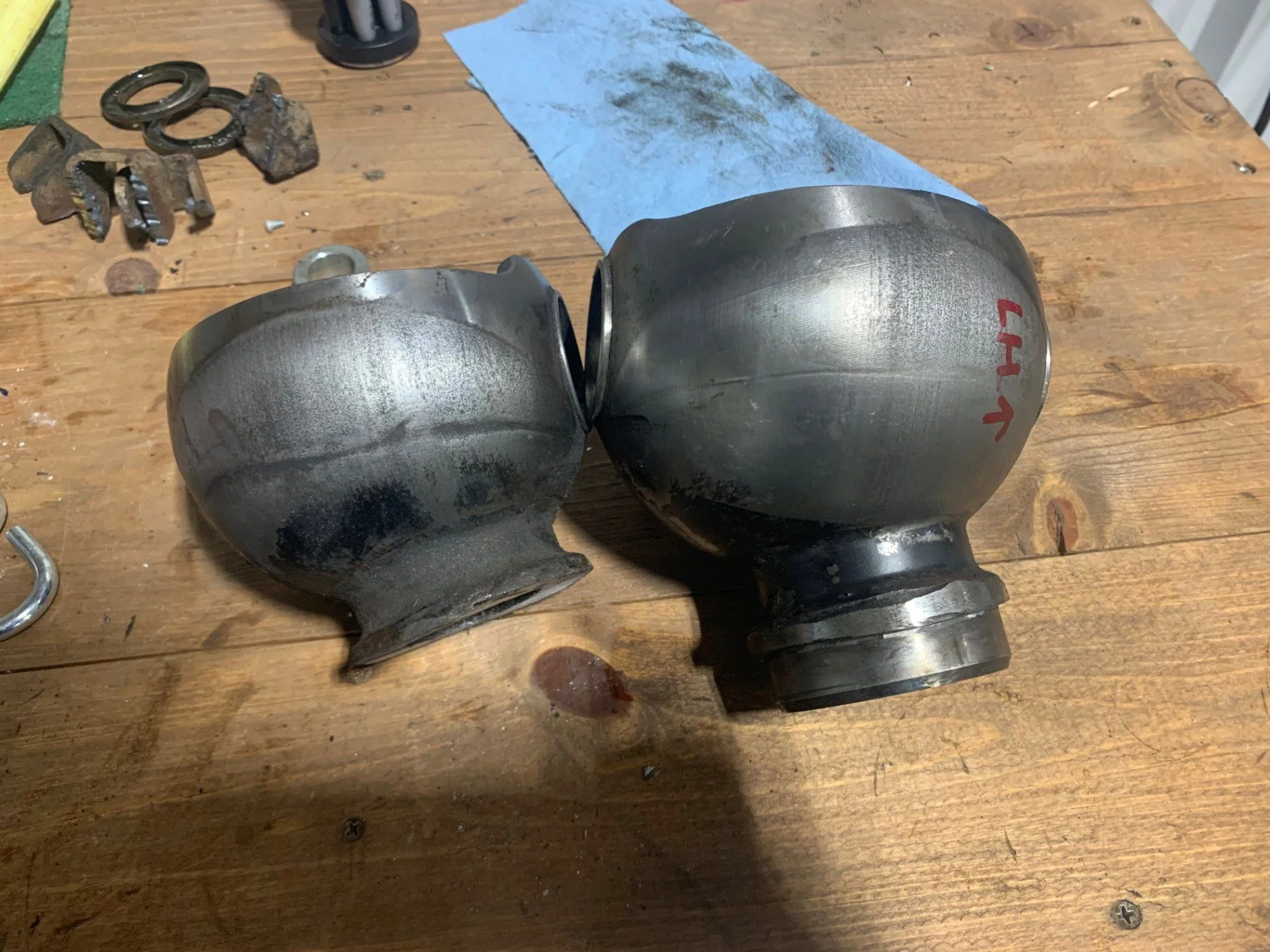

Thats just the suspension brackets, I am using all 80 series parts for the outers of the axle, which is so much more beef then the 70, check out the comparison of the knuckle balls, 80 series is almost an inch larger.

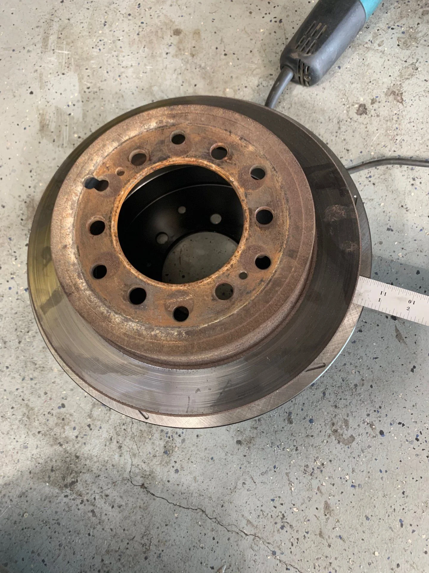

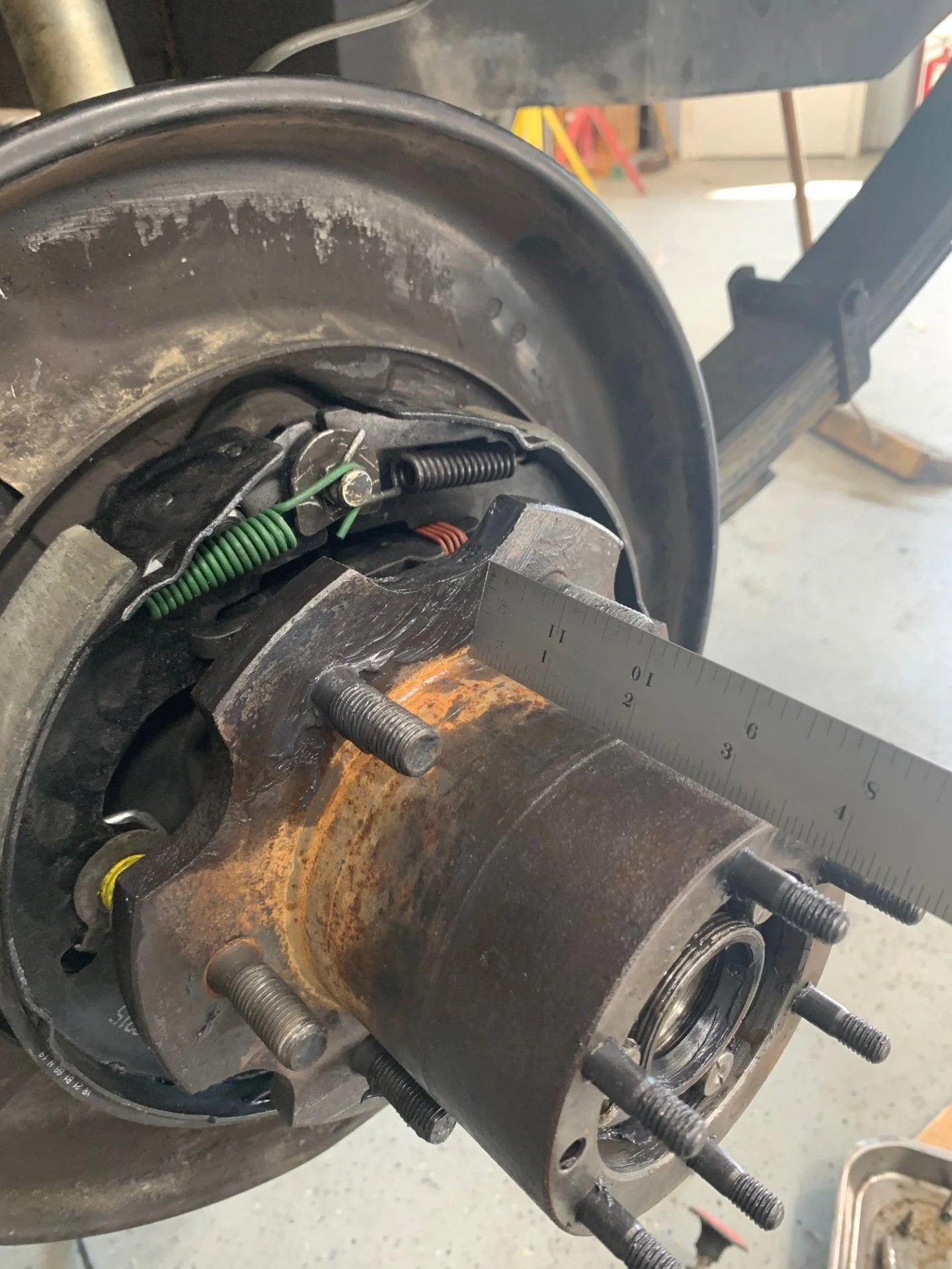

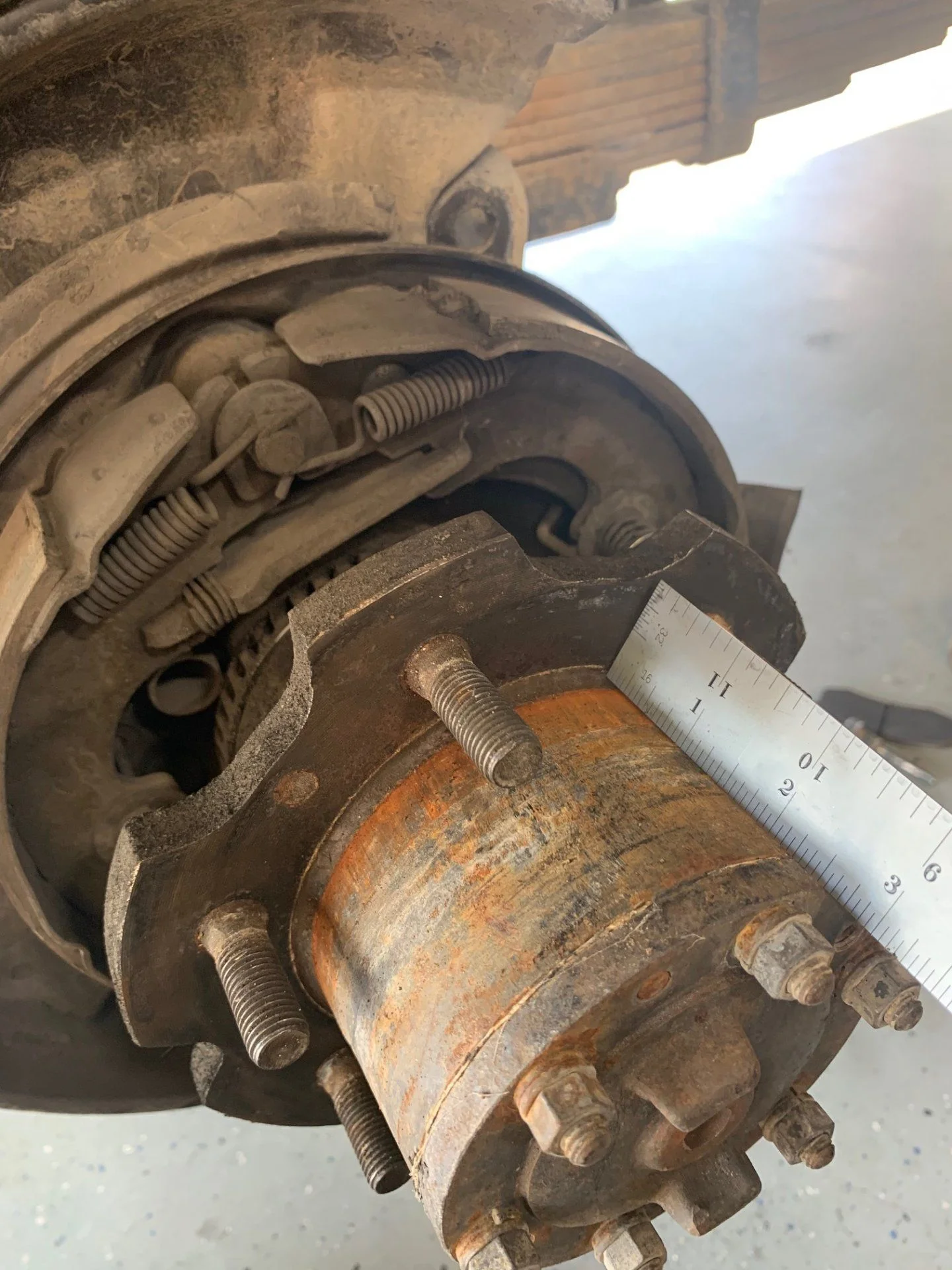

@badsamaritan I am actually converting the rear of my 70 to 80 series brakes also which uses different style hubs then a 70 series, see picture for comparison, the 80 series mounting flange is pushed out about an 1" more, and the rotors are different. So I have my old 70 series hubs you can have, but not sure if that will work for you. You will also need new backing plates. I have it all apart right now, and have all the parts laid out, if you want to come by and check it out.
With the flange being different, you need different axles as well?
No the overall hub dimensions are the same just the flange is In a different spot, so in my case it will widen the track width by about 2 inches
