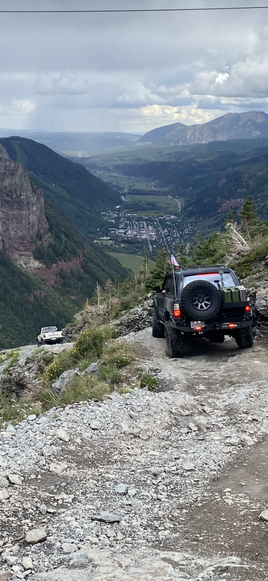

With a Jerry can holder on the rear bumper, it gives me some flexibility. Usually I carry a mixture of gas and water cans. Water ends up being more of an issue than fuel usually.
For my type of wheeling on the west coast, I’m not far enough from a gas station that I need more than one can of gas. We fill up near the trailhead and carry a can of fuel for peace of mind and just incase. The only place I’ve needed more fuel is crossing remote desert areas.
The LRA tanks are pricey and add weight, though it would be nice to add range for 1000 mile drives we take to some trails. Stopping every 200 miles gets old. A LRA is arguably safer than carrying fuel externally.
As you point out, a Jerry can holder requires a rear bumper, but that gets your spare out of the way too. Jerry cans on the rear bumper move the center of gravity up and aft. I prefer my heavy weight low and close to the middle of the truck as possible. Jerry cans make it easy to share gas with stranded drivers.
