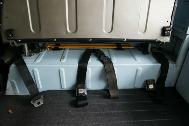

On my 72 the jump seat seat belts are positioned so that a passenger seated on the front half of the seat has a belt, while the passenger on the rear half doesn't. The seat belts anchor at the front of the wheel well and on the wheel well at the midpoint of the jump seat. When I replaced my front lab belts with three point shoulder belts, I installed the front seat lap belts on the rear half of the jump seats so that there are now two pairs of lap belts on the jump seats. I used the existing middle mount to anchor both the front half belt and the back half belt by stacking them one on top of the other. The rear half of the rear belt I attached to the wheel well using a backing plate on the underside of the wheel well to beef it up a bit.
This was one of those really nice almost no cost modifications that required only the drilling of two holes and about half an hour's work. And, since everybody on this forum loves a picture.....
