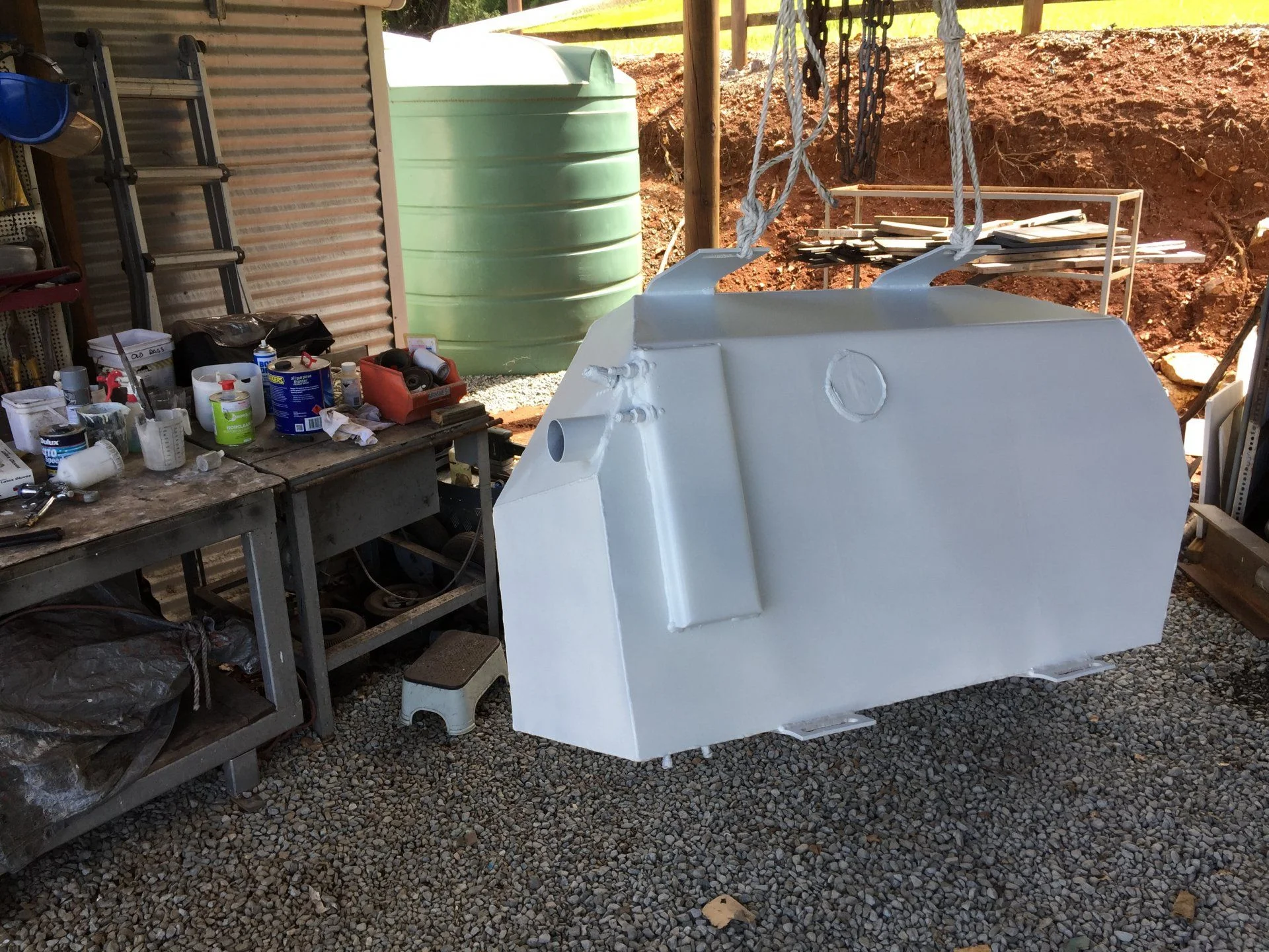

180 liters is very appealing but this photo makes me sceptical that it will fit.

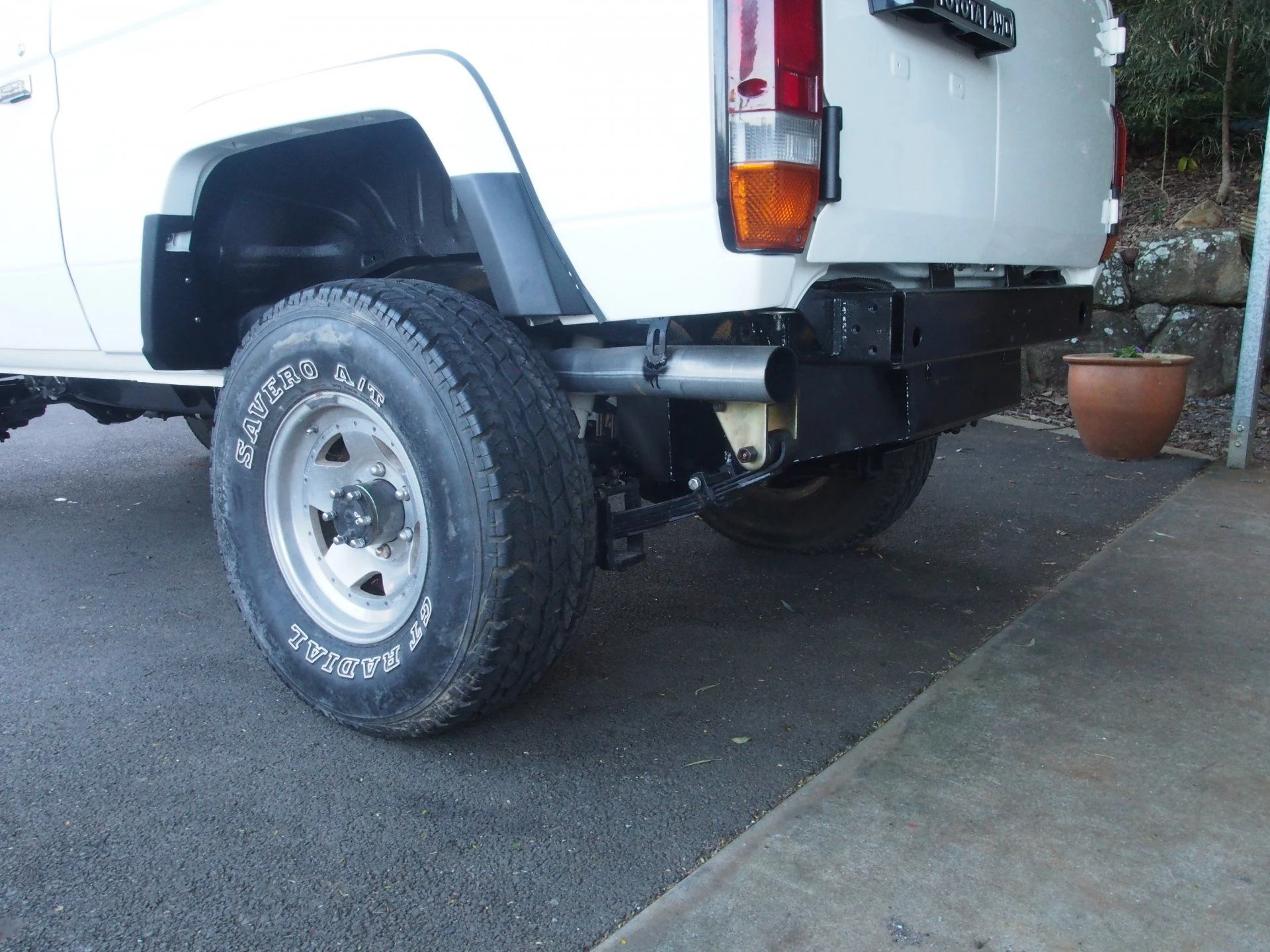

There's no measurements but I don't think my butt sticks out that far

I have an older Longranger tank in my 73 series that was for the 75 series troopy.(from the code on the tank is discontinued and replaced with the one in your photo), Fit without any mods but very tight tollerences. I got it second hand and from my calculations is around 170-180ltrs.

That looks great for travelling around but any place with rocks or some ledges might beat up that tank pretty quick . I noticed people tend to be very careful approaching an obstacle but usually forget to look at the same obstacle when the rear end needs to go over it.
They are made for long distance travel in remote parts, not rocky gullys. Long Ranger have been in this business a long time. If they say its good for X amount of litres, they mean it.
Good point. Probably looks worse because of my quarter chop too. I am helping my fab guy tomorrow to make a rear tube bar so I’ll make sure there’s provision for a bash plate of some sort although I doubt I would go through somewhere that requires that much exit angle.
