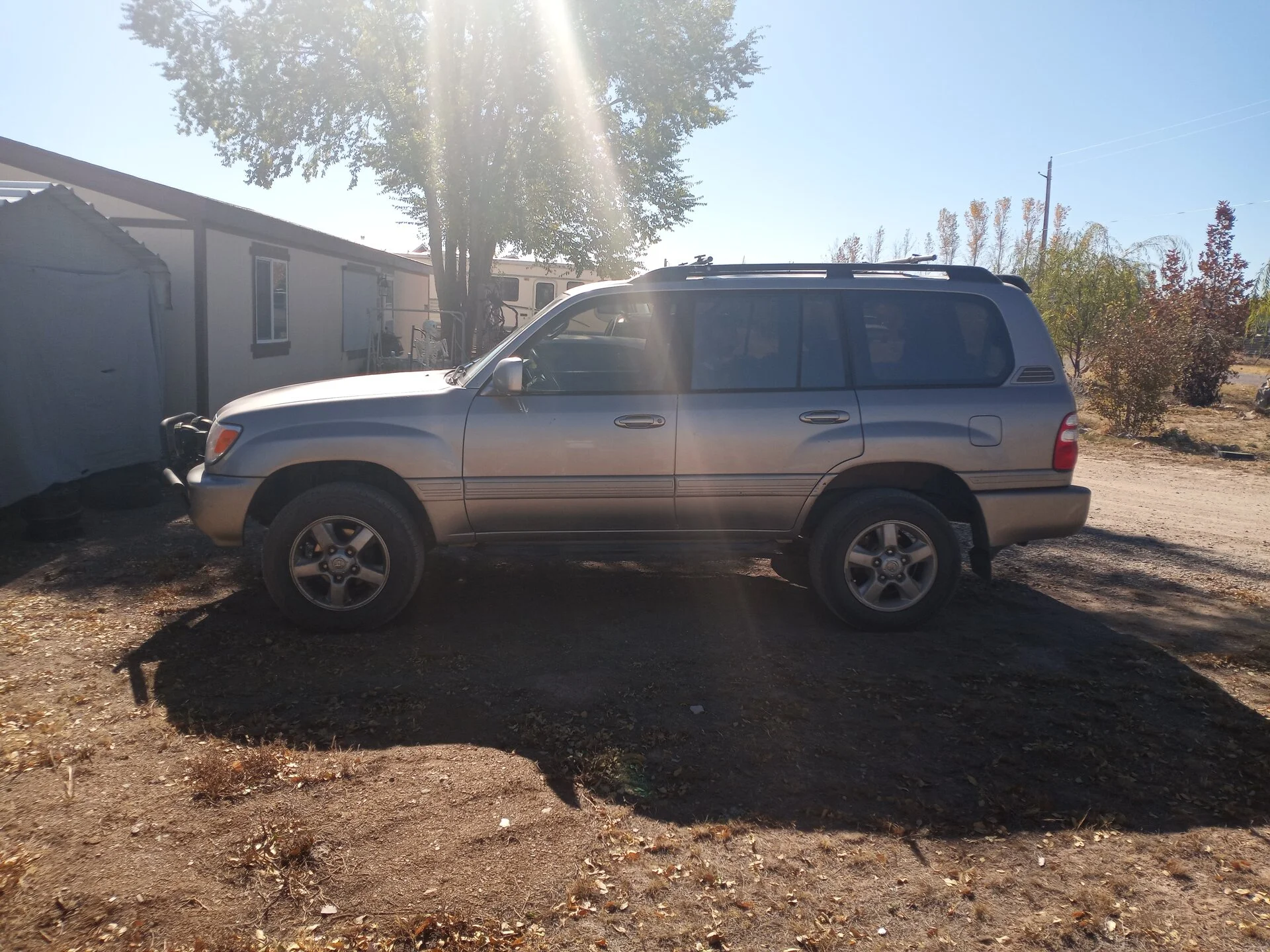

I forgot to get some of the front... but the inside is real clean and stock, the map doesn't work and I'm having issues with the maintenance log but I'm still happy with it. I have all three rows of seats but don't use the very back. other then the power outlet being out, everything is pretty nice. Bit dirty, but nice
I need to find tires, I have a buddy trying to get me some 6 lug 185/65? 17s (Long story there) that I'll end up either reselling or try to find 5 lug 17" rims to slap the tires on. Also, there is some sort of lift on it (nothing apparently obvious to me or my friend, and it was done before the last owner had it) and I seriously need to buy or build a diff drop kit, but thankfully have "lifetime" axles from O'Rilleys from the last owner so I'm looking at options

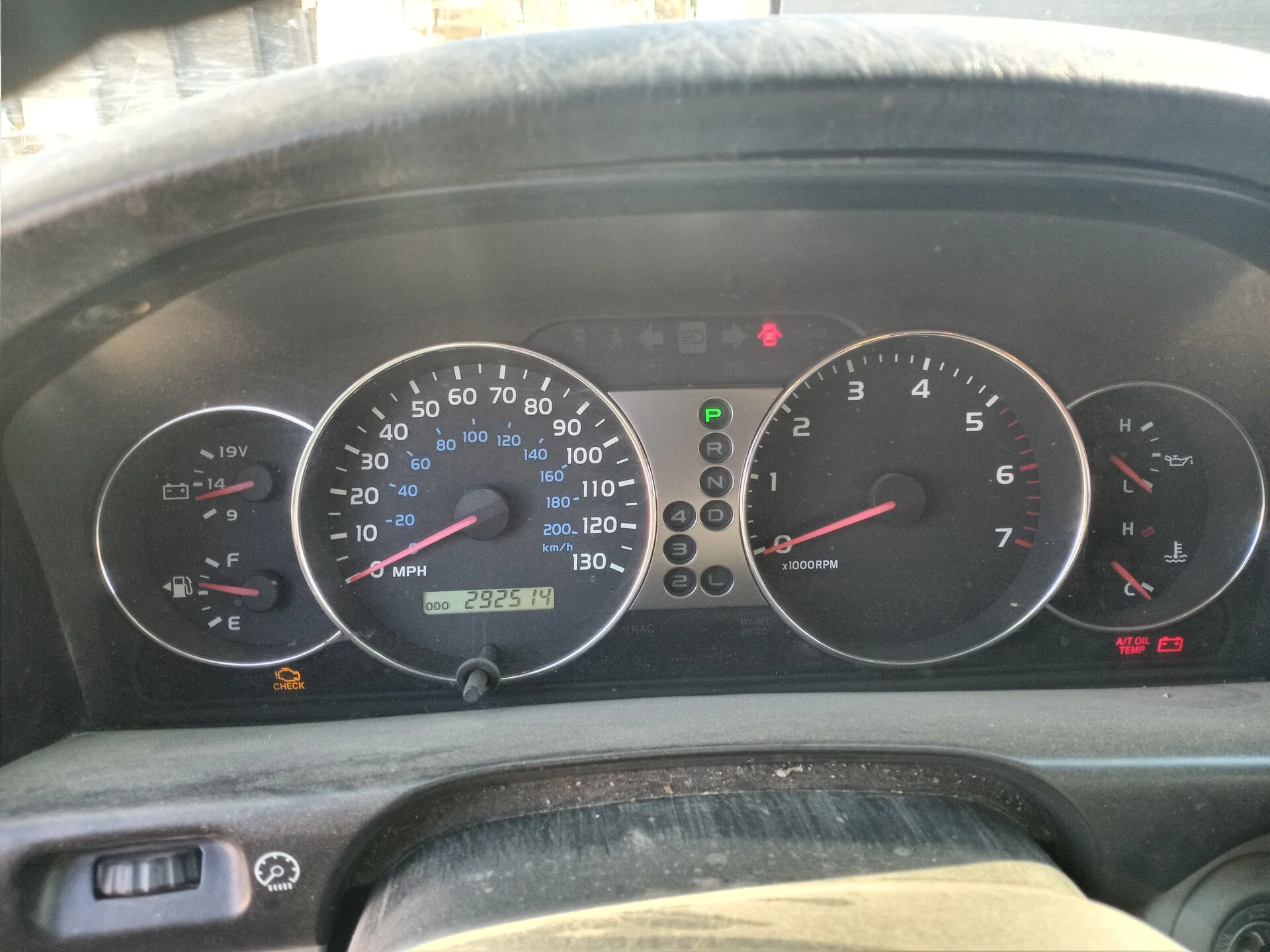

292,514 is uh... up there. For sure. I think I got her around 280-ish. Mostly small city driving, around Prescott and surrounding cities. Towed various weight multiple times and she's done great.

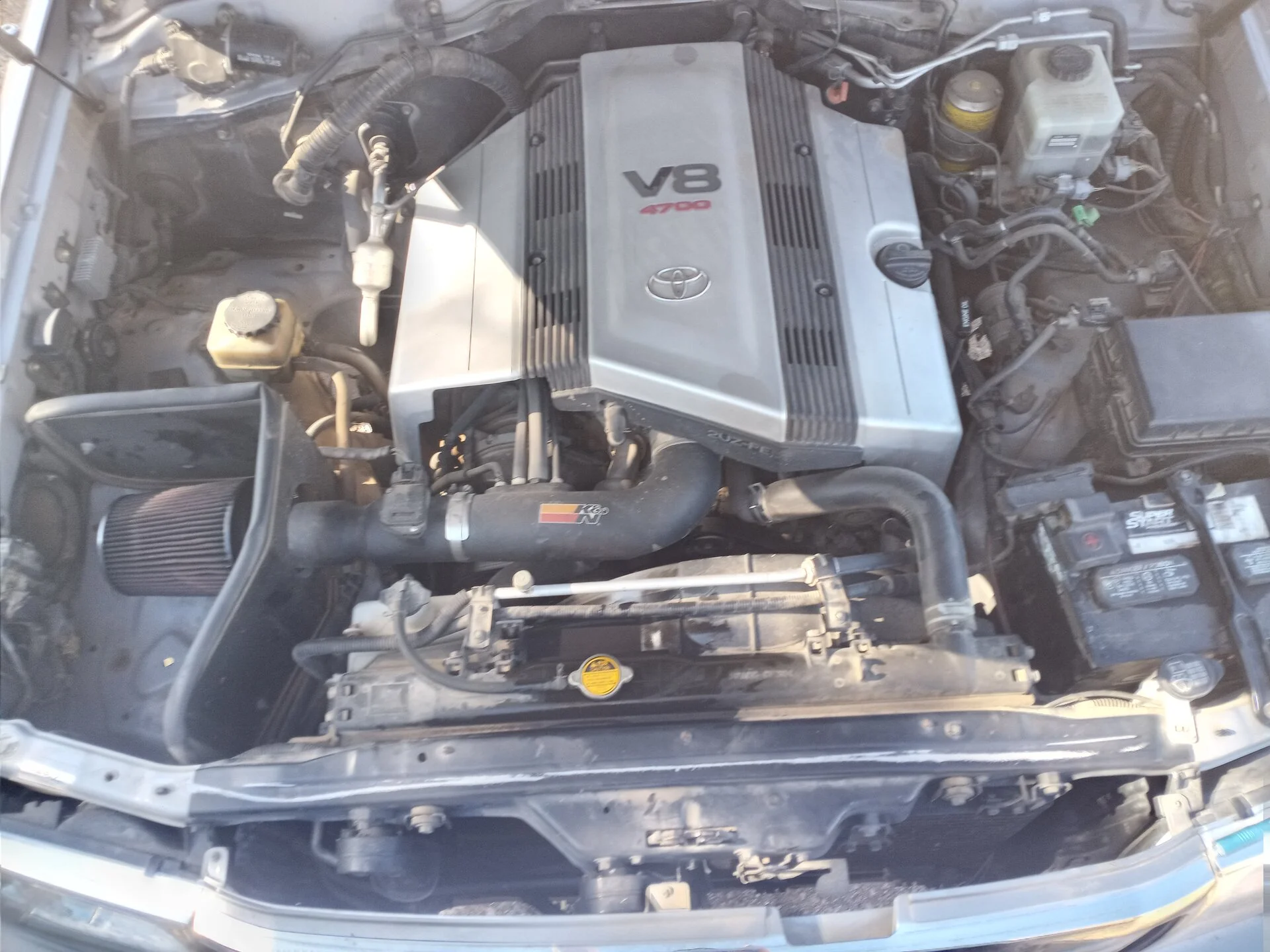

K&N Cold Air Intake came installed, battery tests just below good and I have a few electric issues but just need to remember next time I'm in Costco, Just recently had all my power steering fluid leak from out from one of the hoses but haven't looked any closer yet, and the infamous coolant T looks like a weird Halloween decoration. Popped the cap today, it's not leaking from there thankfully. Transfer case seals are leaking, same with axle seals. I have/want to tear into the front diff to make sure everything's good, replace all seals, clean and repack front bearings (did passenger once), probably switch out axles once I get the diff drop in, and if that's not enough to do at once I'd like to do gaskets throughout the engine, new batt of course. If I had the money I'd like to throw all new gear under her, but calipers and disc/drums are first, I need new bushings EVERYWHERE, and I'm probably forgetting at least one other thing

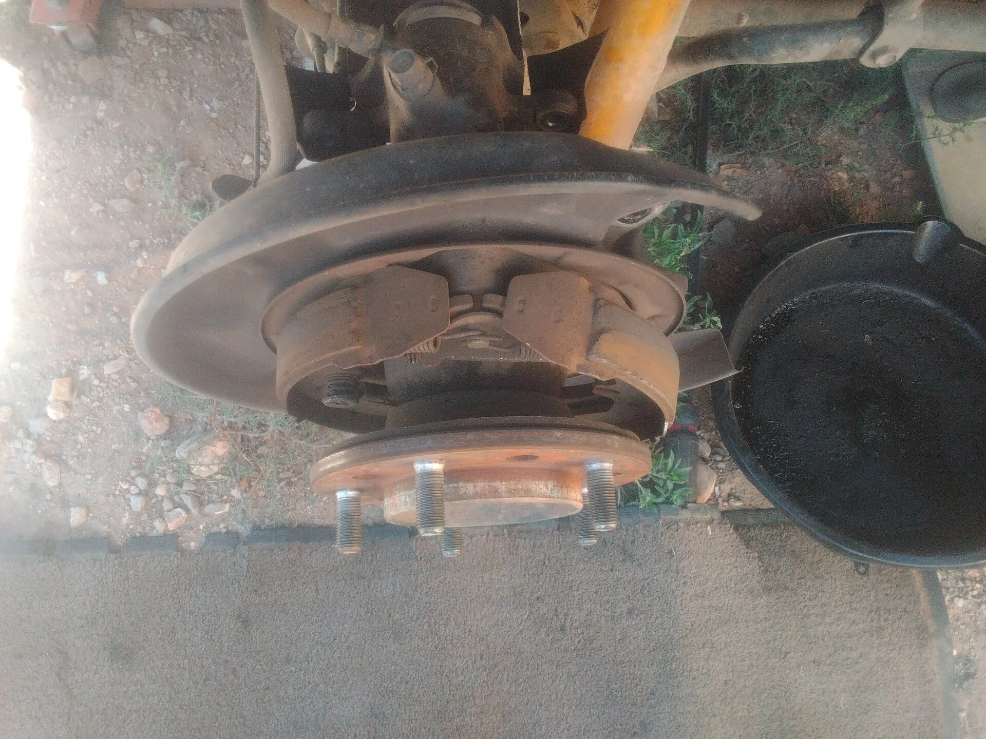

Now, this is from when I really started to drive it myself and started to chase noises and clunks. There was a clip nut floating around inside the rear passenger drum, so I'm not sure if maybe it was someone using the wrong hardware or what, but the spring, pin, and two washer-things were no where to be found. The inside of the rotor was pretty beat up but not bad enough it couldn't be cut, got new hardware to button it up better and made sure the parking break was solid and the other side was good. Still squeaks when stopping but know I either need to rebuild or buy new calipers for a couple reasons.

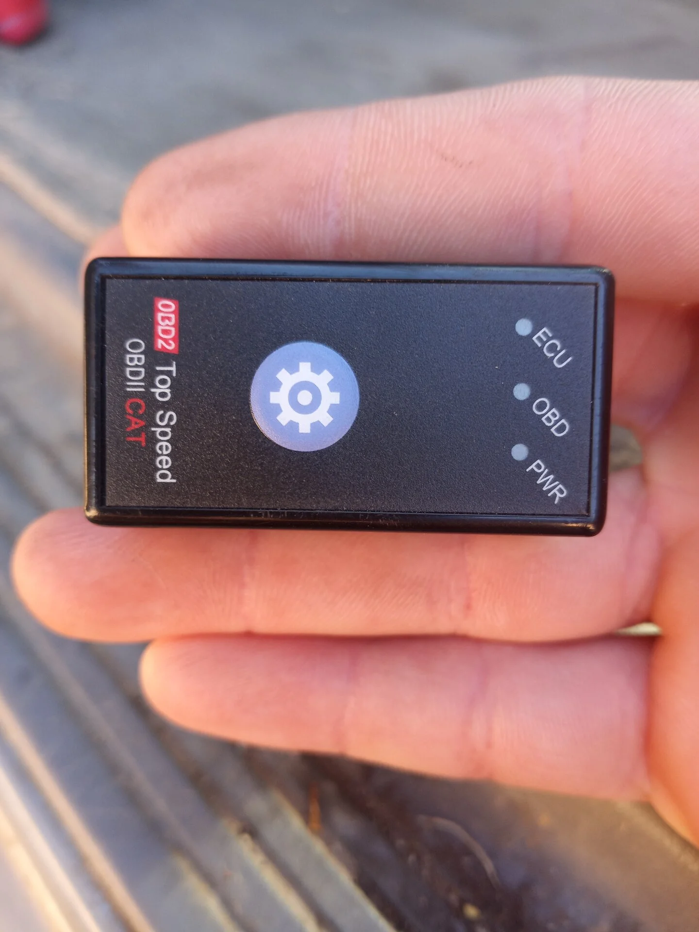

And finally, the Thorton performance chip, third tier. As far as putting in a link, I think it'd be easier to google it real quick, Thortonchiptuning is the website but being a new user I don't want to throw any flags by linking anything. Now, I have purchased one for my Kia, but this chip came with the cruiser when I bought it. You all have now seen the ODO and bad pic of the engine bay, and I can attest to 16-20 MPG town/highway. normally about 18 to and from the town next to me. Towing and weighed down, I still sat at 16 once I hit highway. I don't watch it (the screen showing MPG since last fill up that is) as often as I should, and I think sometimes it's very wrong because I've seen it at 22 MPG, but after a full fill up I know I have roughly 250 miles before next fill up. The last owner bought it and said it bumped the MPG up from 12/16mpg to 14/18, and up until I started having diff/axle problems, I haven't seen anything under 14 on some big hills. I also have not driven without it plugged in, mostly because if it ain't broke... My father has one and has kinda mixed reviews, it did help things a little, but he also built a monster so it isn't the same as throwing one into a stock vehicle. As for my Kia, even with a bad cat, I can tell a noticeable difference in the way she runs and shifts, and I haven't been blowing through spark plugs like normal. The Kia is a real beater with issues but this chip made a great impression to me and I truly feel like it's worth at least checking out. I bought the one for the Kia during a huge sale and got the third version/tier for $100
Thank you all for reading! I look forward to many great conversations and new friendships with all of you. I try to hop on my computer in the evenings but what I do that day dictates if I have the energy or not. I tried being as thorough as I could, I've been working on this draft most of the day haha, but I will try to answer anything as quickly as I can. Right now I have quite a bit of work to do, and I can't think of any real questions about what I'm doing, but does anyone have a OBD2 chip like this? anyone seen, or tried making your own diff drop?
The chip sounds interesting, but I’ve never read of anyone have success with a chip like that.
Plus, the 60hp gain for $88.99 is Blatantly BS claim. I’d love for it to be true though.

The performance chips and the 2UZ don't seem to get much traction around here as I don't think they do much. Some folks will supercharge the motor and that must relate to some fun power gains but otherwise it's time to make peace with your big, slow, yet reliable truck. Focus on maintenance items and get that K&N airbox out and put an OEM one in =] As for your MPGs, don't believe the computer. Top off the tank at the same pump and do the math for a few fill ups to find a real average. I find the computer / OBDII readers that calculate the fuel efficiency is usually higher than the actual.
Thanks for that! Interesting that I never stumbled across that, but I was also taking what my family friend said at face value and didn't do to much research on my own. The idea of a chip actually helping by just being plugged into an OBD2 doesn't fully make sense to me but as I said before, I'm blessed with knowing and not knowing a lot about vehicles. As for my Kia... I'd like to get a tests in with and without the chip just to see if that's what made it run slightly better. I know this isn't for beer can cars though so I won't touch to much on that. That article explains why no one else on here seems to have one though haha

So, I've toyed with the idea of switching back to the stock airbox and maybe reselling the K&N, but haven't done a lot of research into them. Especially since it came installed, I've been lazy and just kept it as it is but I would love to just slap a new filter in when needed instead of the annoying cleaning process. I got to much other stuff to work on haha

Yeah the website definitely blows it out of proportion. meditro commented a great link with a review about the chip being a scam, but now I'm getting curious if I can do anything with it if it really does nothing. I'm not the most tech or software savvy (yes and no, I like learning the basics for everything) but I know a couple tuners who know what they are doing that can maybe sit down with me and get me going in the right direction. Now, I say this with my Kia in mind. my beloved cruiser has to much tech in it for me to feel comfortable doing anything, not to mention the cost of everything, but I am driving that Kia into the ground
