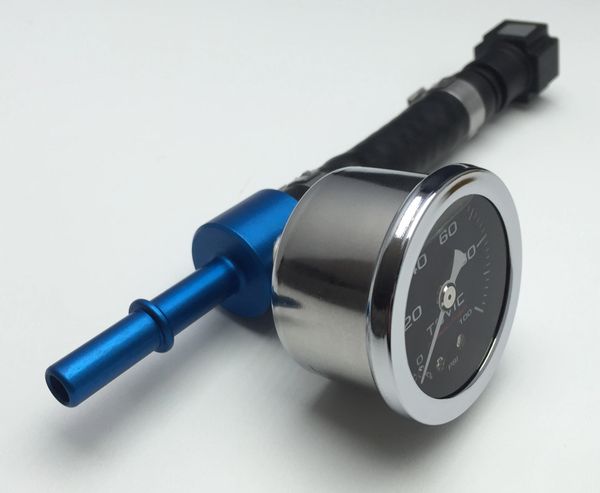

Correct, no schrader valves or banjo bolt methods available on the GX. To run any tests, you'd need an inline T connection to bridge a fuel line point like this:
It'd need to be different than most inline testers out there, you need a male and female end to the gauge (most I saw are both make ends).
Something like this setup maybe:
