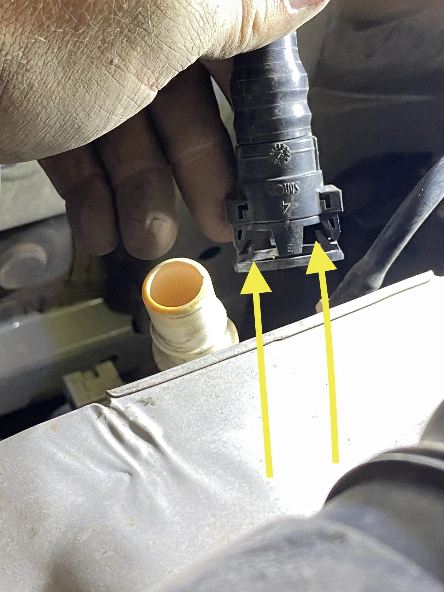

Final connection is the vapor/emission line. It’s a bit of a bitch to get off. It sits on the top of the tank, bias to the passenger side and looks like this.
It appears to be a squeeze and work off type connection, but I fought it for about 30 minutes before finding the identical connection on the other end of the line (at the evap canister) and after messing with that one, I determined squeezing wasn’t going to get it to come off. I have to insert a flat blade screw driver and pry out the retaining barbs and work it loose.
Here’s the connection off finally and where I inserted the screw driver on either side:

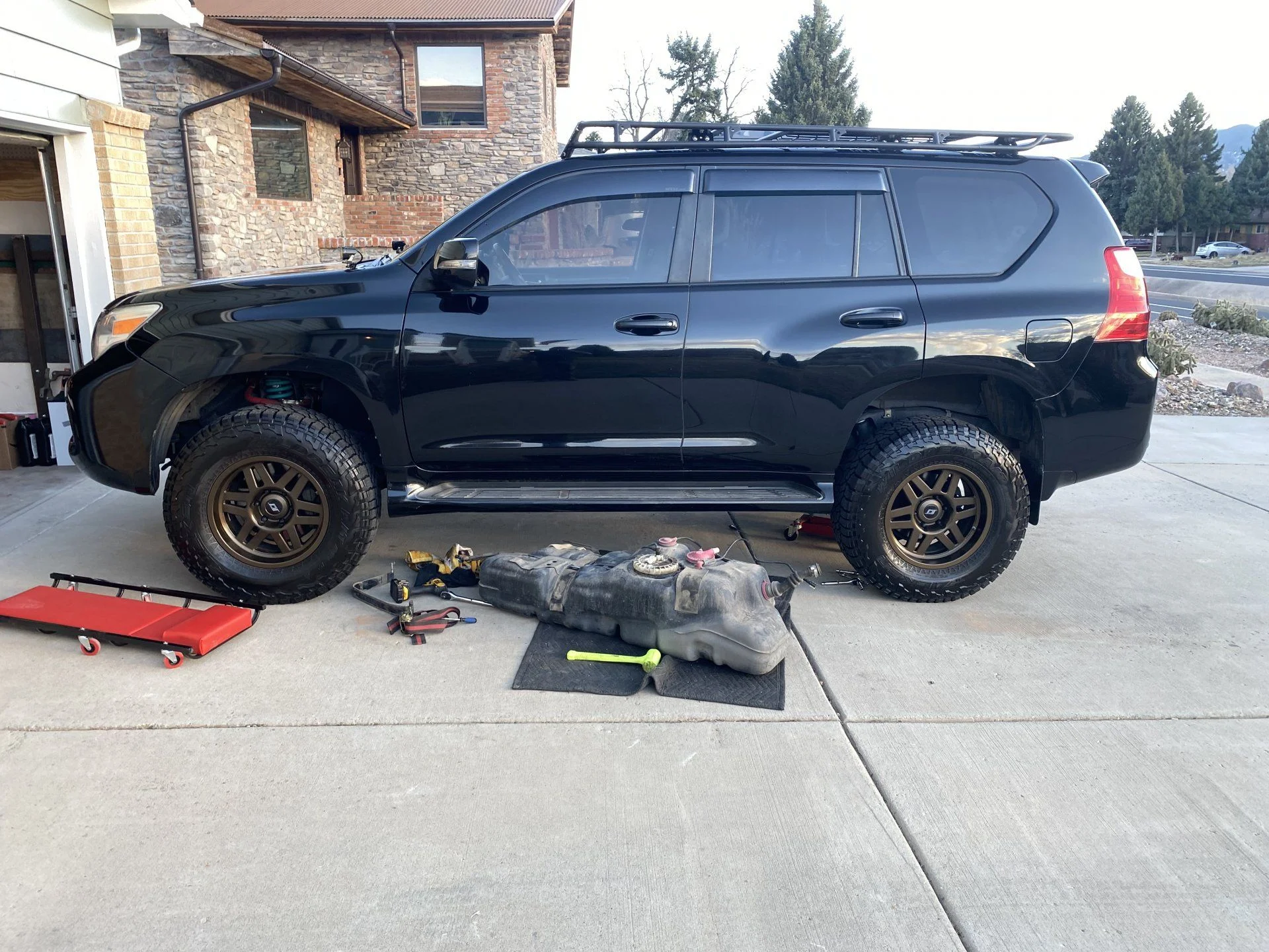

Now you’re ready to drop the tank (after having removed skid plates and tank straps of course).
I used a transmission jack, worked well except the tank sat too high to roll out form under the GX, so I had to remove the tank from the jack to get it out completely. Had 6-7 gallons of gas in the tank and it was a bit to wrestle down and back onto the jack, but doable.
Here’s an overall shot of the tank removed, shows a few of the connections better

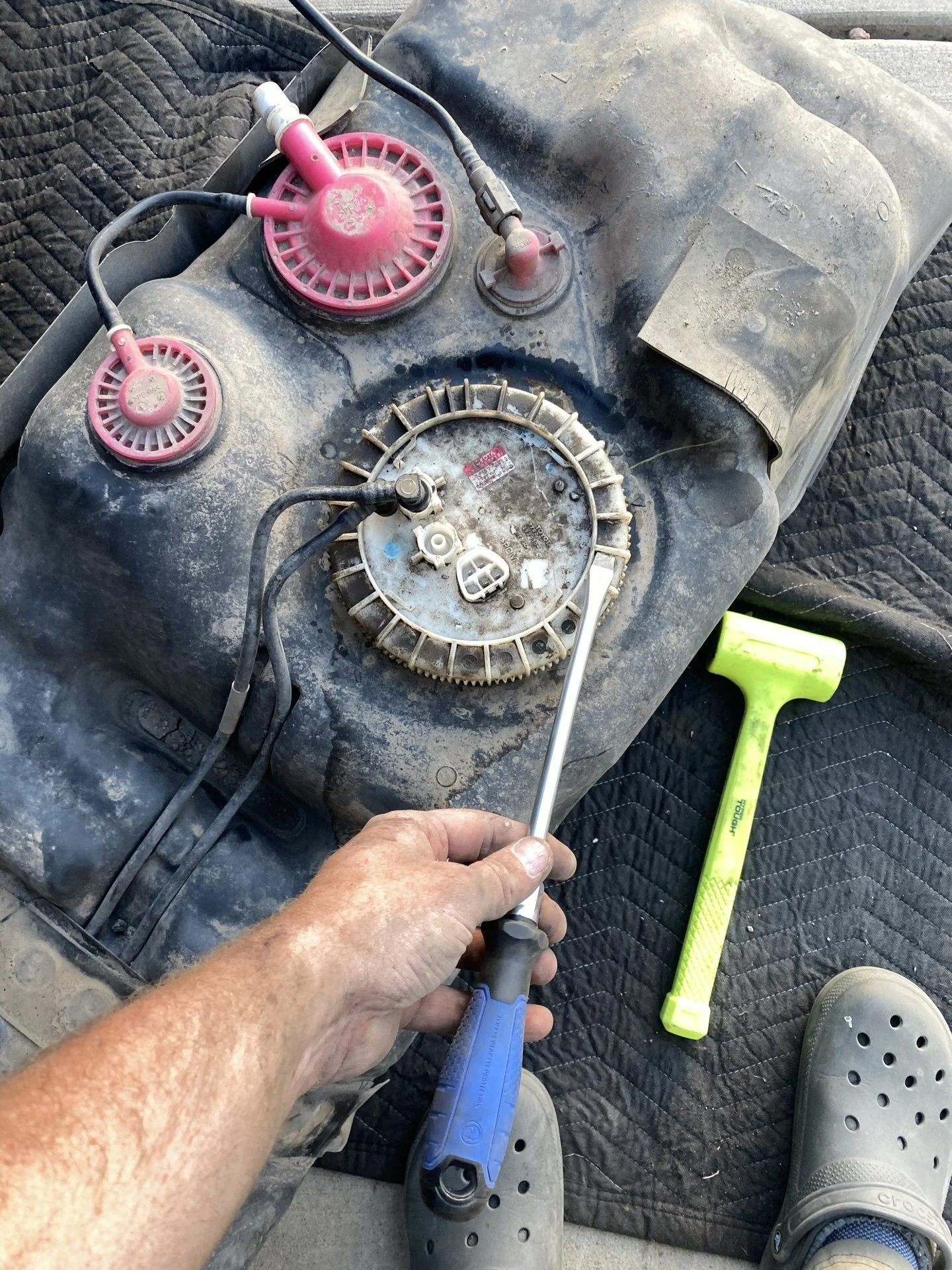

You don’t need the special tool to remove the fuel pump mounting lid, just a large flat head screw drive and a hammer. I flip flopped opposing sides of the rim while knocking it counter clockwise and eventually it worked loose.
I did buy a new ring in case I mangled this one up (have done it before when doing fuel pumps, about $30).

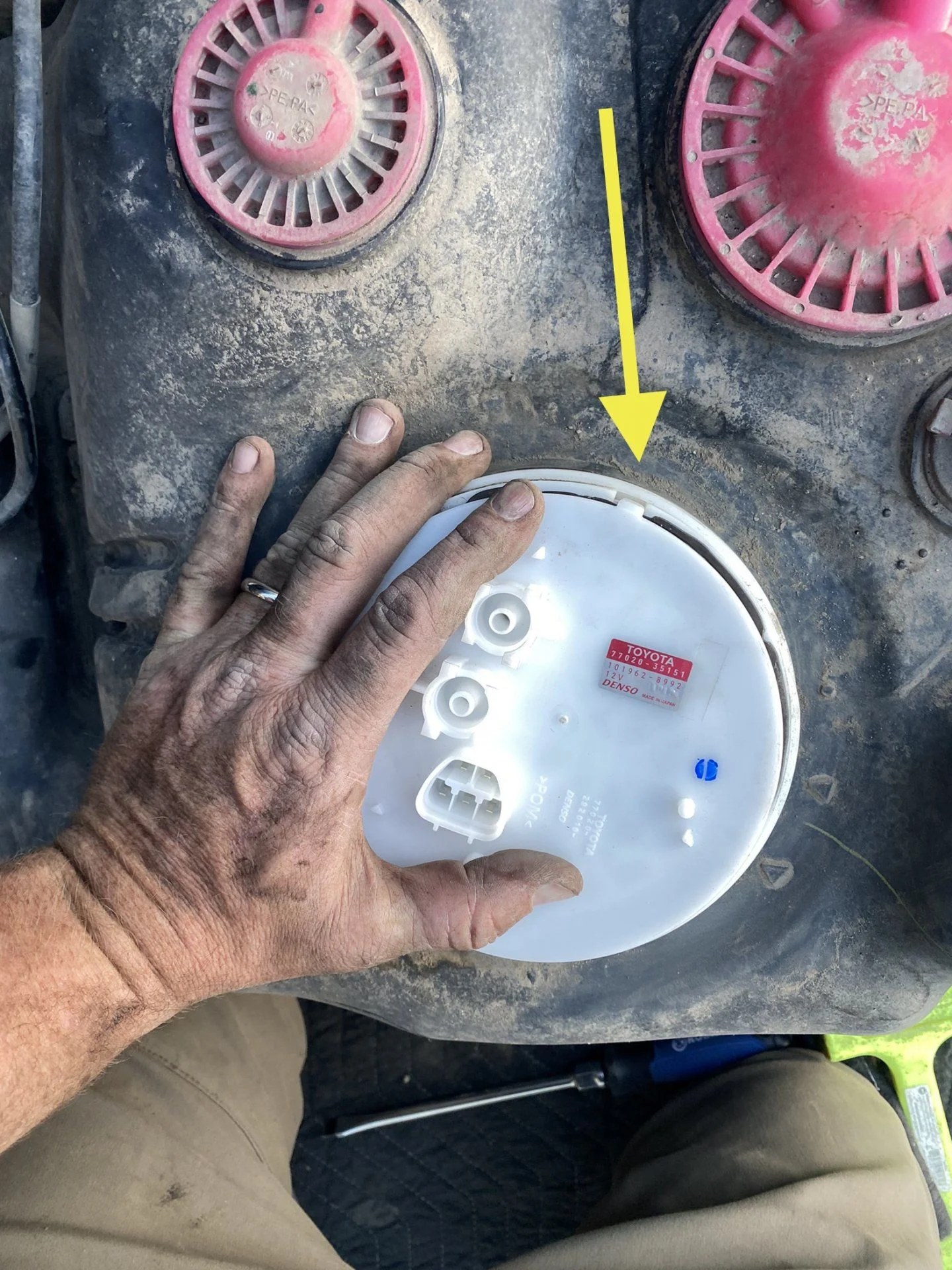

When installing the new fuel pump, there’s a singular alignment tab on the pump that you wanna clock it with. It also stops it from rotating while tightening the lid.

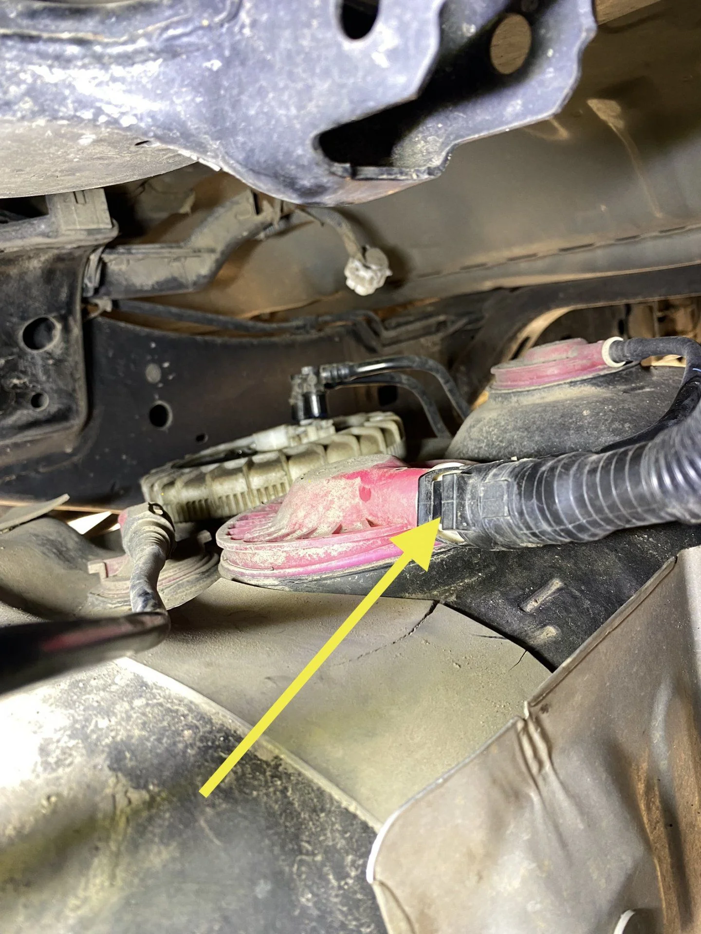

Now, reconnect the fuel lines at the pump itself and get ready to wrestle the tank back onto the transmission jack and reinstall it all.
