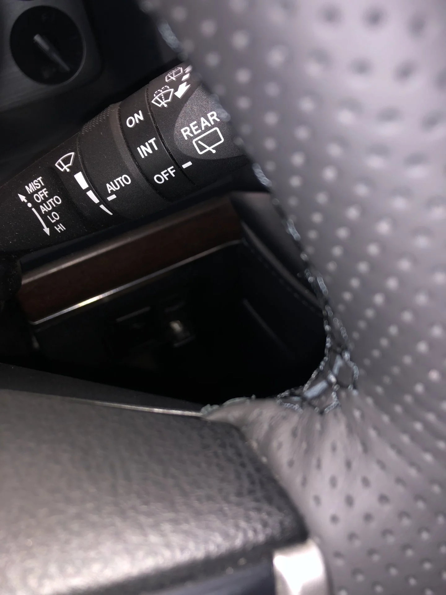

I did this today. It went okay, but it doesn't look as flawless as the one I did on my old '13.
It didn't trim out as nicely around the spoke things of the wheel, and I have some wrinkles in the top part that I hope will smooth out (I might try the heat gun or some lexol).
I used the tape, it is super thin, so not noticeable like you all said. I probably should have used even more of it...

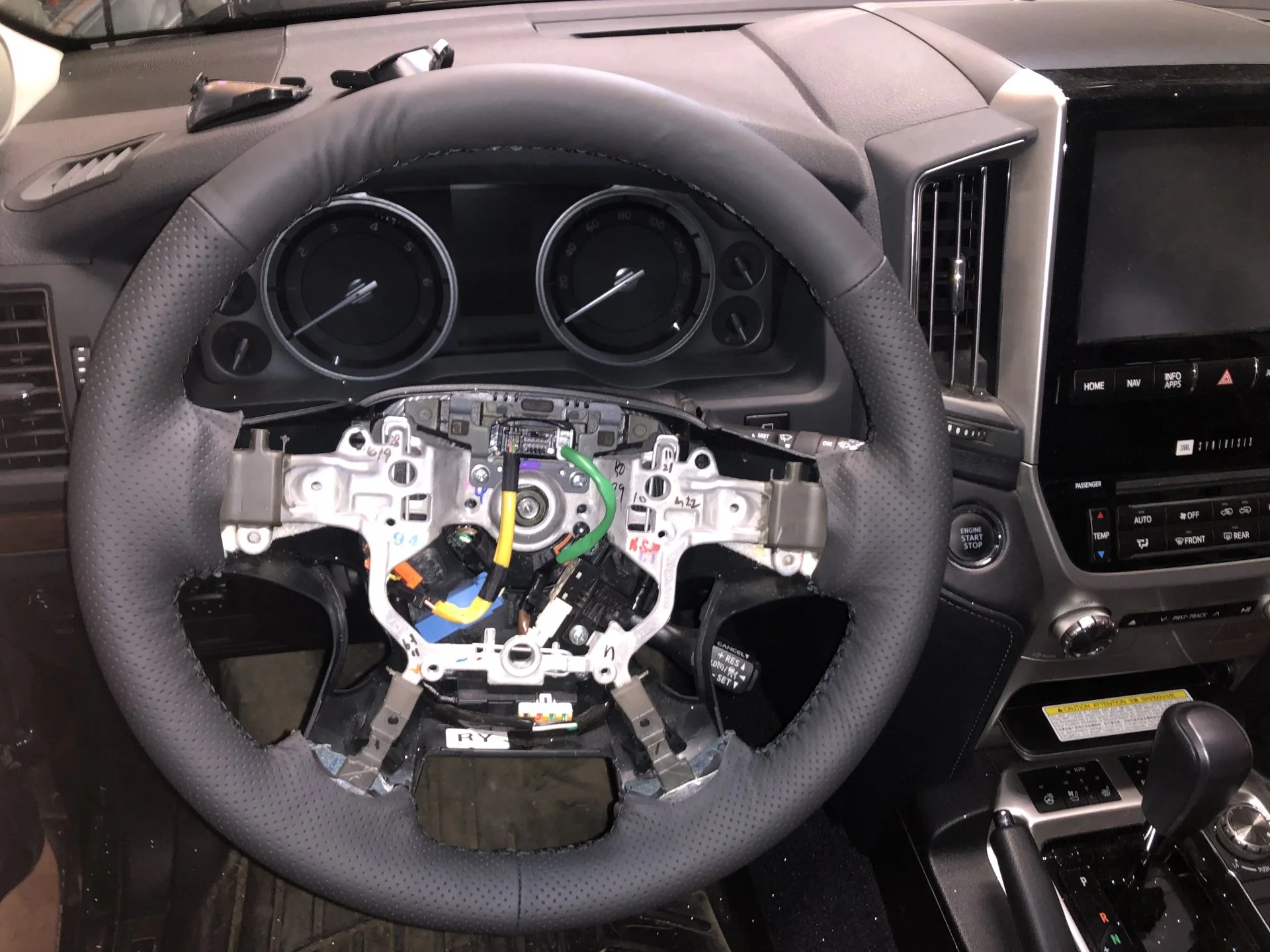

I agree that you don't "need to" remove the center, but I prefer to.

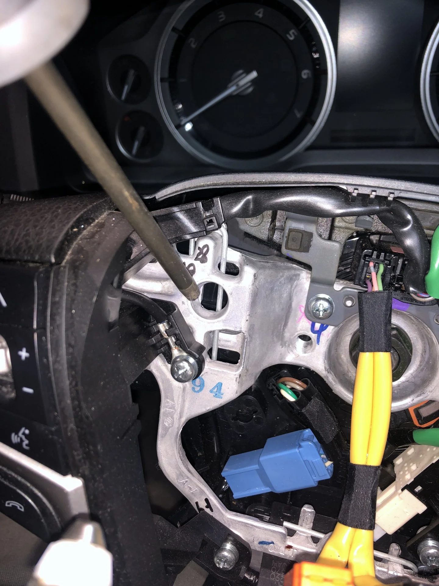

Removing the airbag and controls isn't difficult, but like most things, there's a learning curve. I can have the airbag and controls off in 10-15 minutes now that I've done it. The pre '16 takes a few minutes longer because of the way the airbag attaches.
