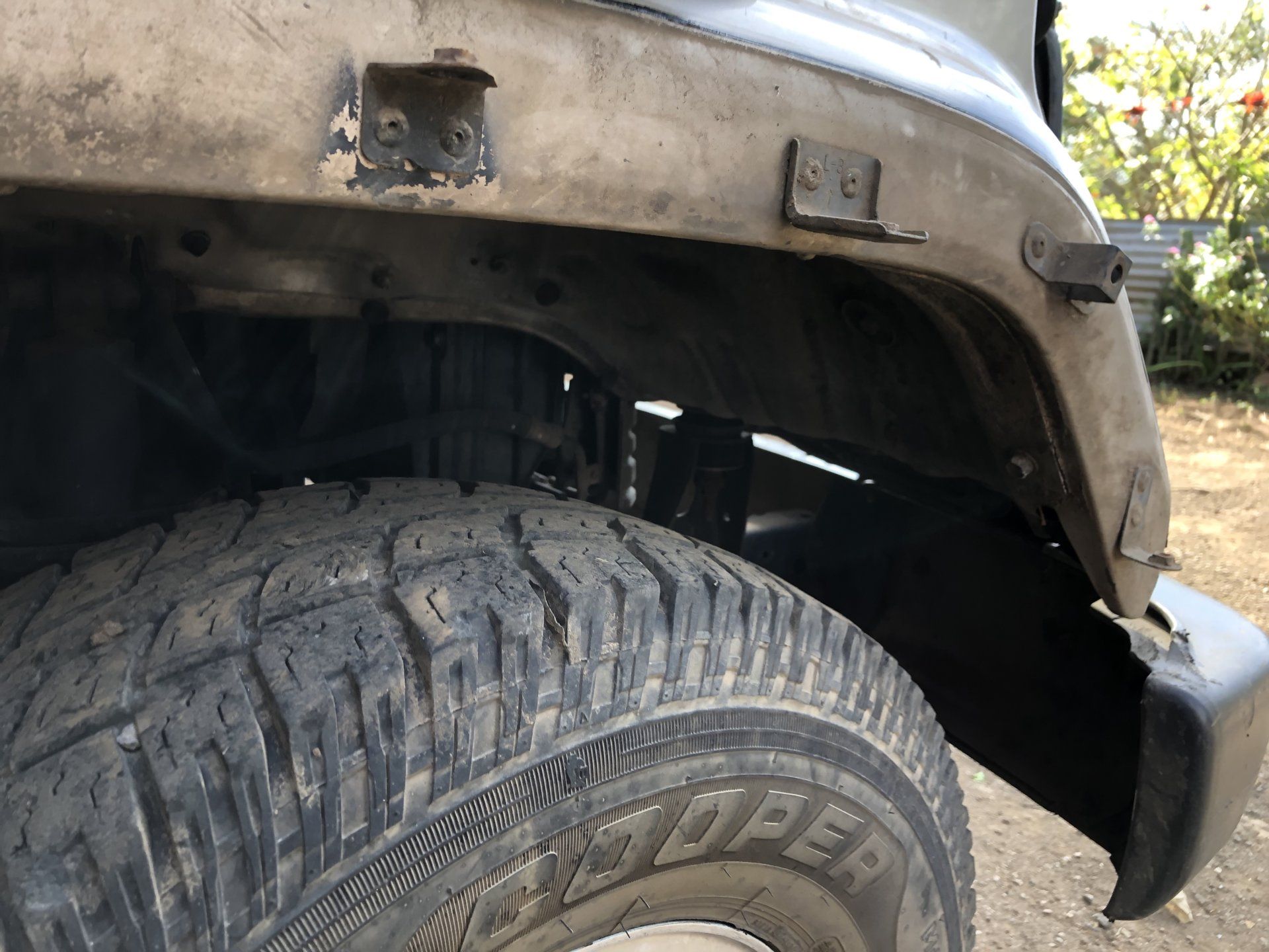

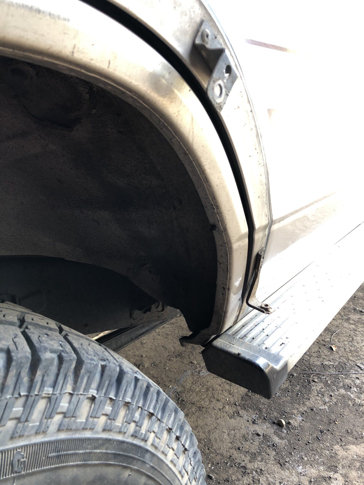

Someone mentioned on the last post to pull the fender flares and check for rust and corrosion as that seems to be a typical hiding spot. I wanted to paint the fender flares anyways in a matte black. I ordered up some of the rubber trim and some of the missing pieces to put it all back nicely. I was able to get the rear replacement mud-flaps from partsouq as well.
After pulling the fender flares; the majority of the metal was fine and very little rust was there. However on the rear left panel, it was completely eaten through with rust. We ended up having to pull it and replace it with new metal.

We ended up changing out some metal in some other areas, mostly because of poor repair jobs. Like a lot of the South American land cruisers, people here rely on bondo and silicone. Fortunately the guy I use is quite talented in forming metal with the most basic tools. Everything is getting take down to the metal and aligned as we slowly tackle the body work.
This is what we ended up pulling out of the rear lower quarter panel.
Considering it's age, it wasn't really too bad.
Here is the new panel made.

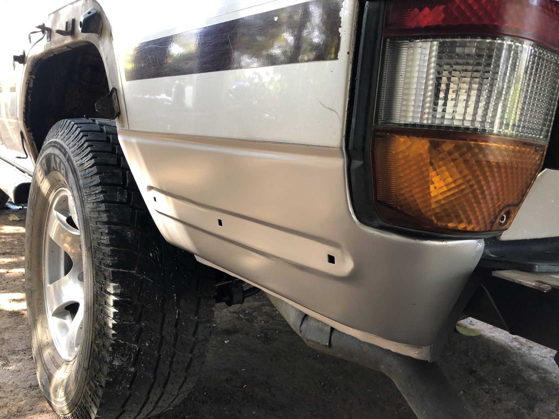

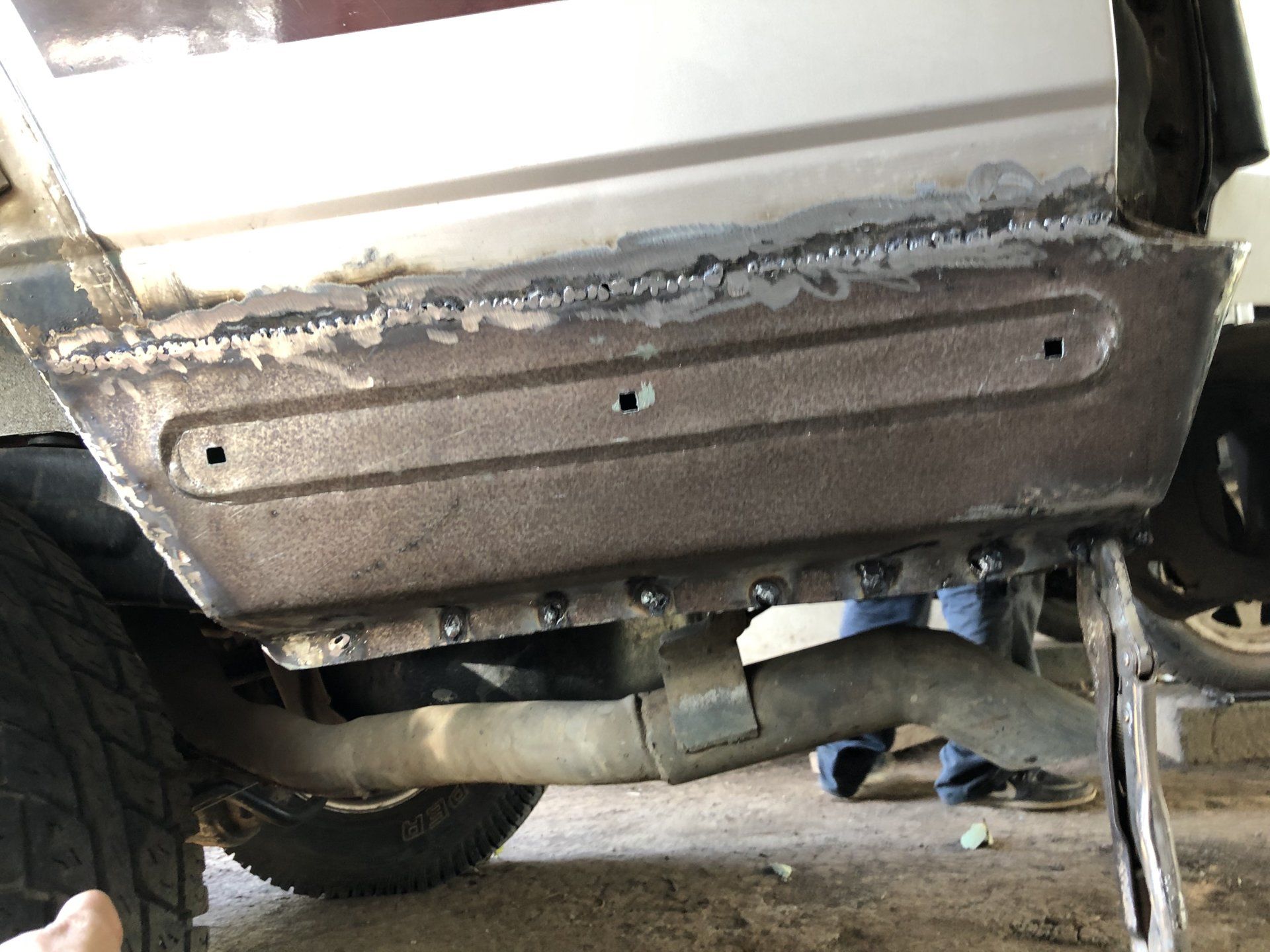

On the rear right corner near the glass, it seems as if someone backed into something, and then poorly repaired it. So because the base metal was in bad shape, we ended up cutting it out and forming a new piece.
And again primed and painted with a base coat:

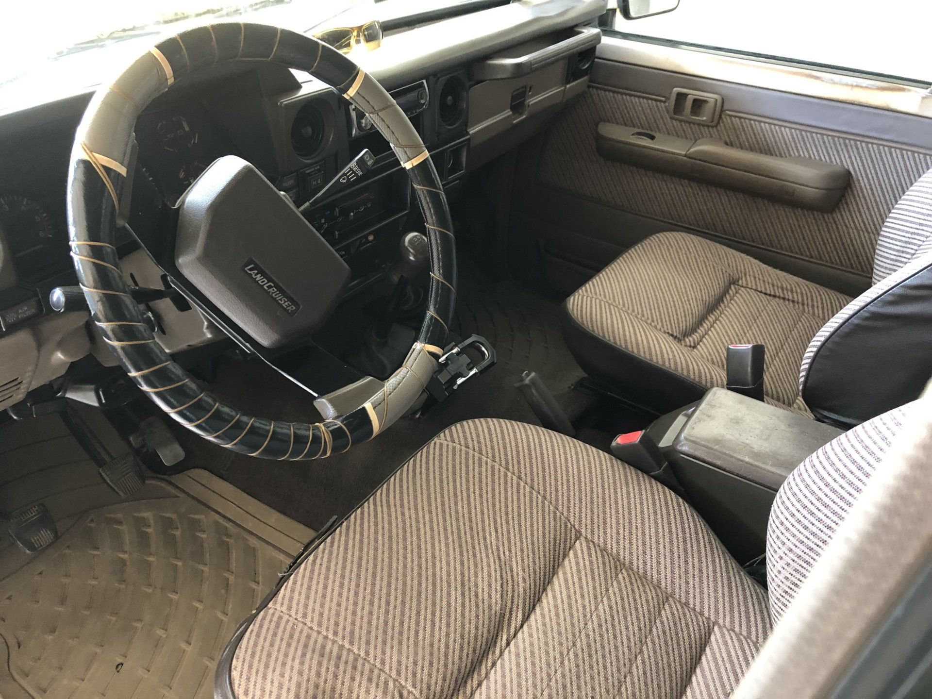

I do need to do some reupholstering as well. The original steering wheel's foam is completely gone. I was able to source a better one, which I'll get re-wrapped here.
The front seats are pretty worn as well, that'll be in the near future.

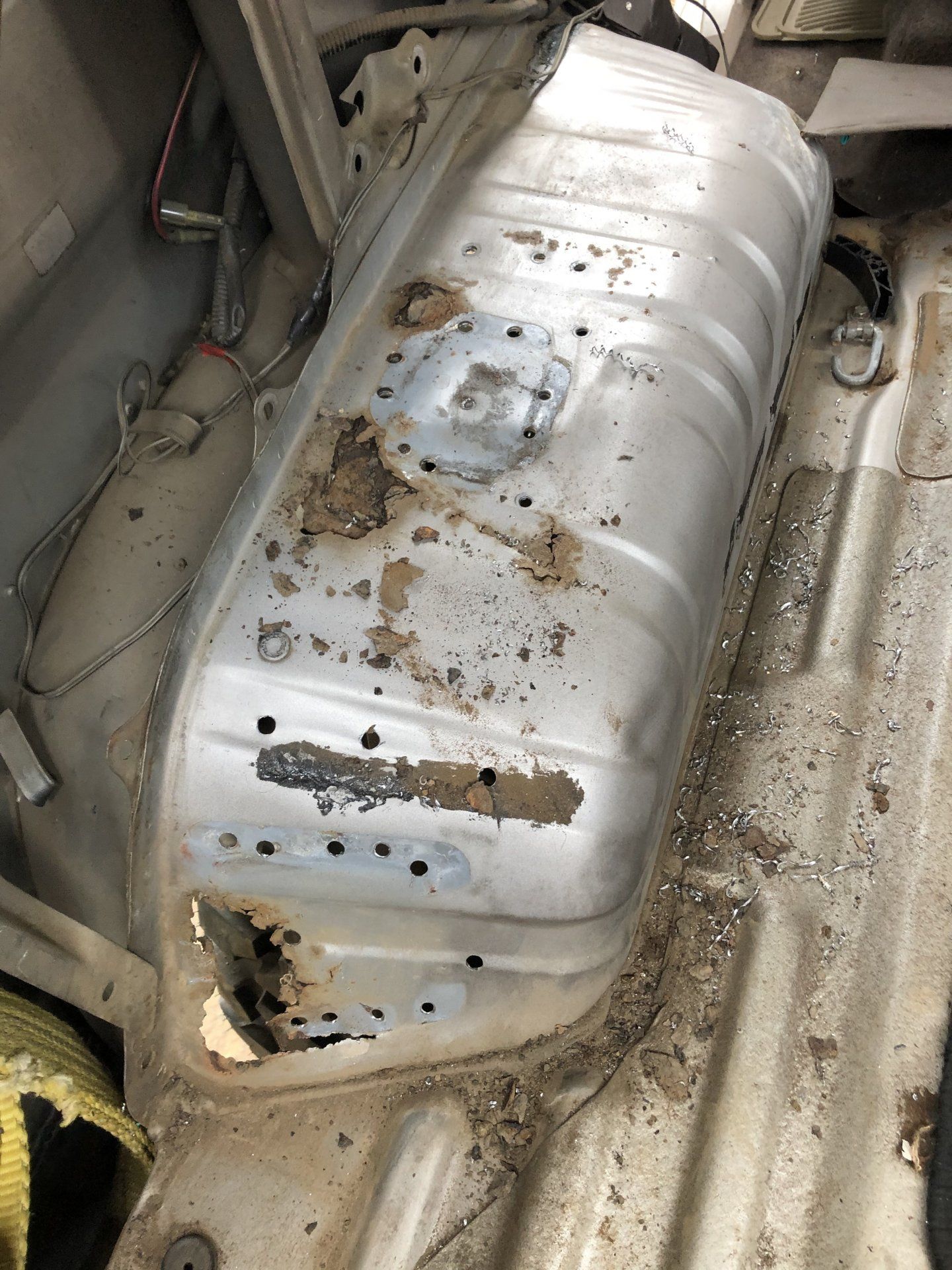

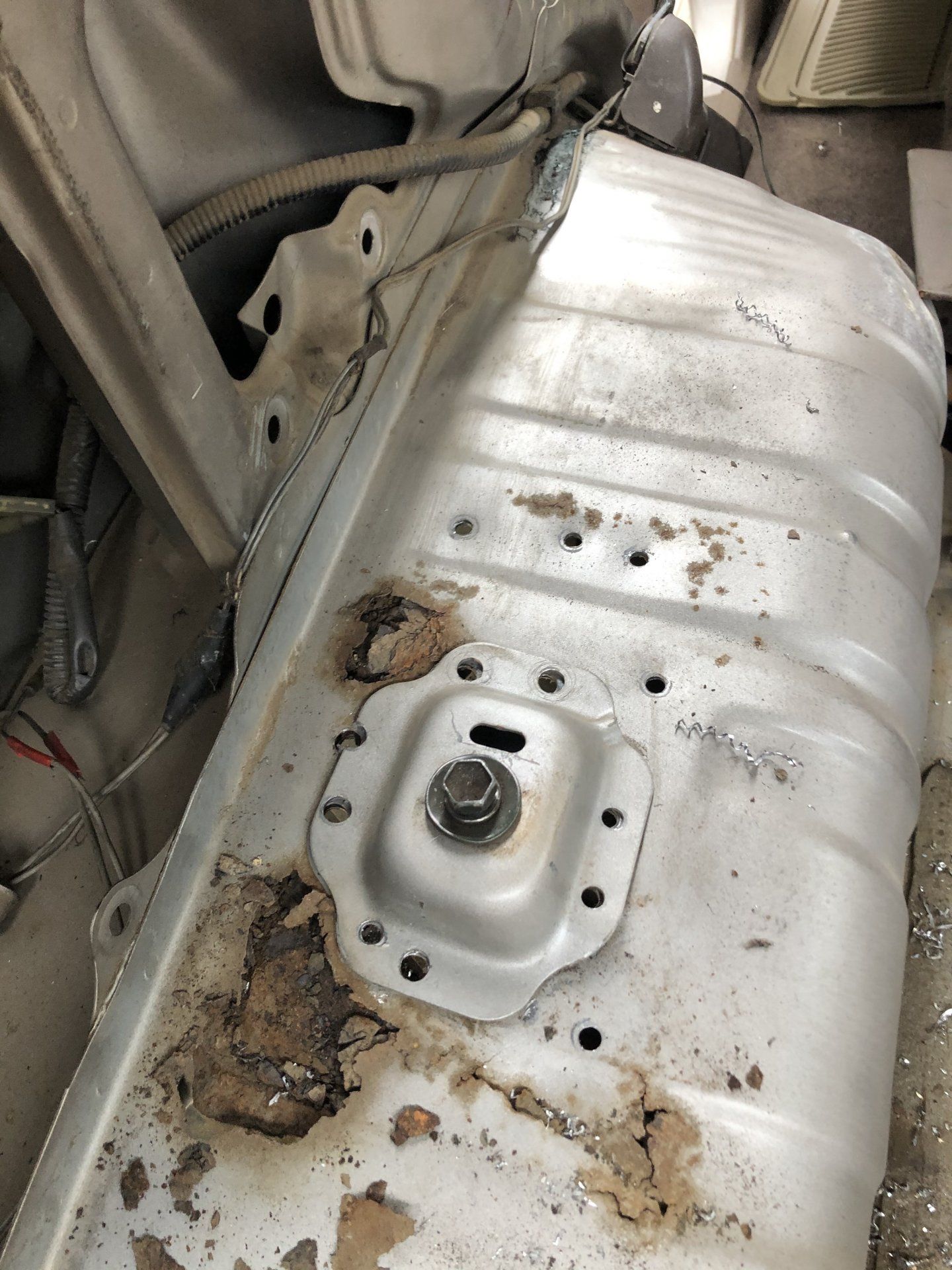

So as many with older cruisers know, rust is inevitable. I knew when I bought the truck that I would have to do some metal repair. Fortunately it wasn't as bad as some of the trucks that I've seen. Under the factory fender flare it was fine as well as the body mounts. It was pretty much limited to the rear fender wells where the sandwich plate are for the seats and seat belts.
The seats mounts were unaffected, so I just had to drill out the spot welds and they came right off.

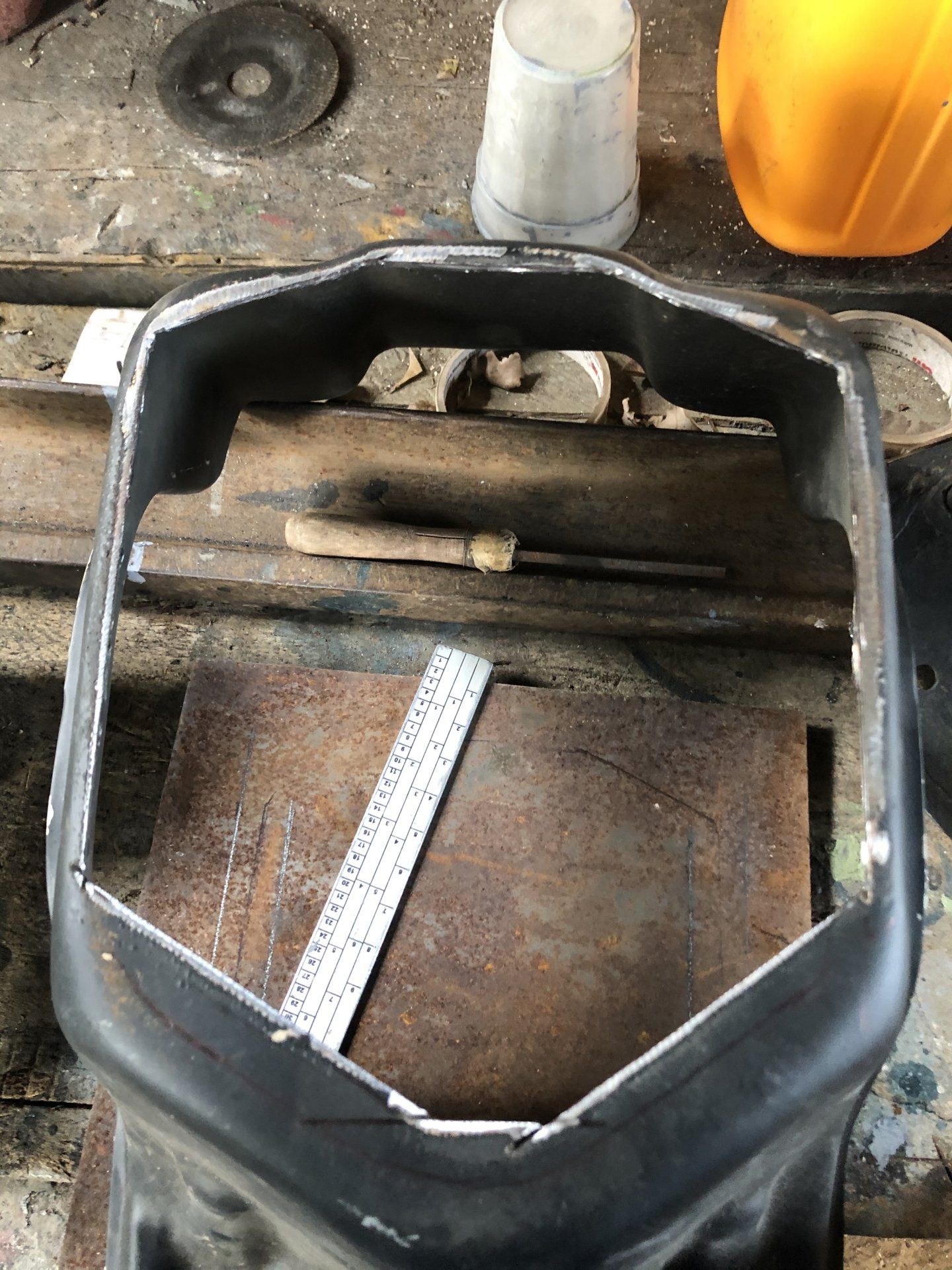

The original tire carrier was in rough shape. It had some cracking and the repair looks to have been done by a blind person. I had some 3/16" plate hanging around, so why not try something?
This is what I cut out:
Those horrible repair welds cracked again because they're mostly pockets of slag....

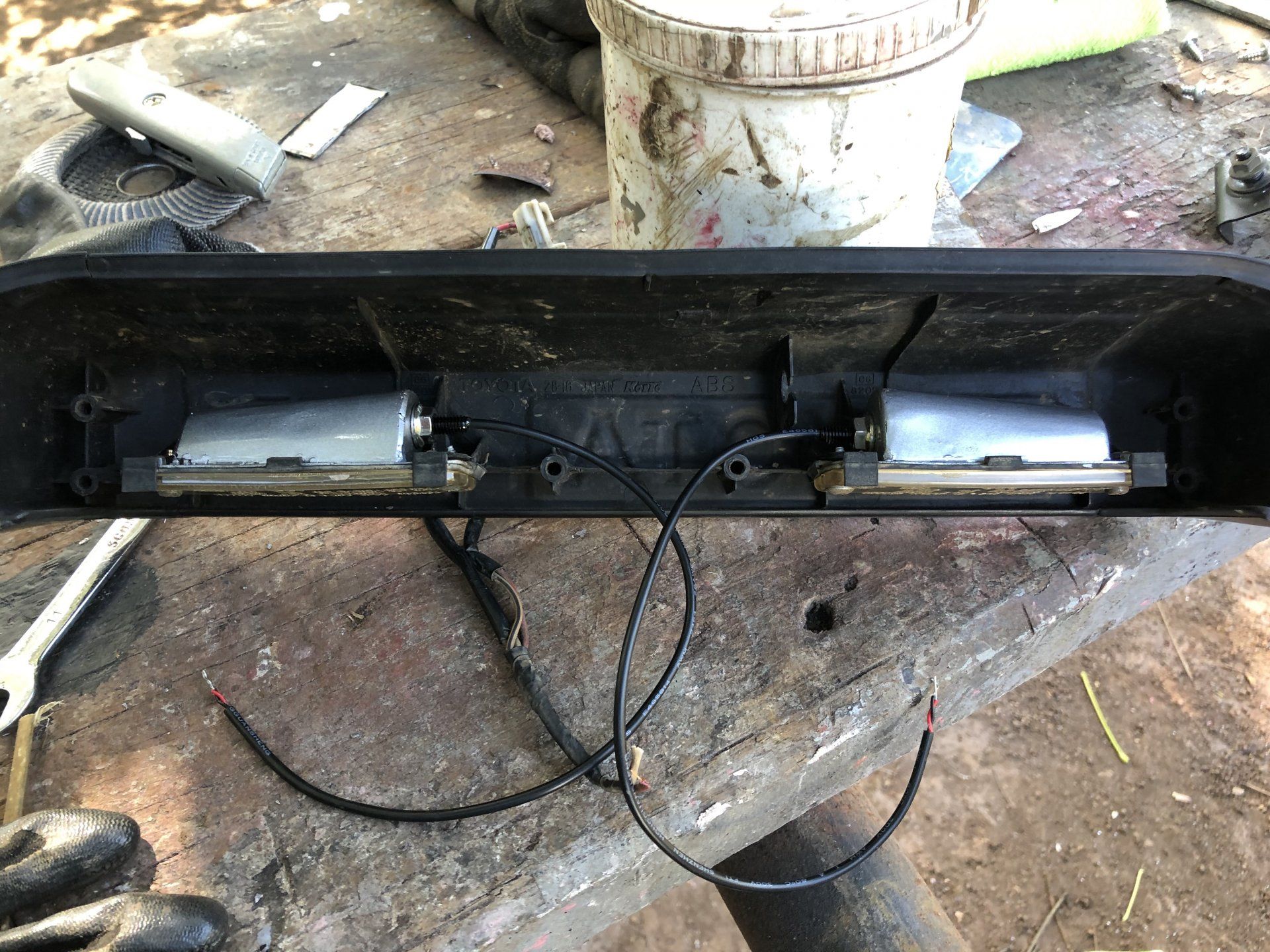

I've been slowly changing all the bulbs in the dash and the exterior to white led. Somehow the bulbs and sockets over the rear license plate completely rotted out. This would be the next project on the to-do list.
The metal was so thin that even welding a little bit would be nearly impossible. I ended up brain storming for a bit on how I would fix these... OEM would be difficult to get, plus the entire bracket assembly came had to be purchased with the lights.
On amazon I found these LED license plate bulbs with great reviews:
I figured why not for $6. Took about 3 weeks for me to get them, and they seemed pretty decent.
So on to the mounting. First of all the factory lens reflectors were pretty dirty and yellow, even after washing and scrubbing. So I tried to see what a little rubbing compound could get me. Turns out 5 minutes with rubbing compounds works miracles.
A little before and after there, once less thing to to worry about trying to find. I was completely happy with how they turned out.
Now I have mentioned before, good tools are very difficult to come by in Nicaragua due to the lack of availability and price. While I would love to have some decent metal shaping tools, it's just not in the cards. So time for ingenuity and determination to kick.
I had some left over 1mm (18 ga.) sheet metal left over from another project that would work perfect for the bulb holders.
So with some rough measurement and some lines as guides I started shaping the housing over a piece of angle iron with a ball-peen hammer. (Next time a planishing hammer will be on the tool wish list)
Slowly but surely it began to take shape.
Eventually with some patience, and welding some end caps I came up with this:
So after sanding them down and massaging out dips in the metal, I cut out a new base and welded them up. This is how the came out:
Probably not the prettiest thing, but definitely functional.
Got some paint on them and mounted them up.
Now after going through that and connecting them up I realized I had made a mistake. Unfortunately in my haste of ordering them, I did not choose white, rather blue was selected. I hate blue exterior lights.... Lesson learned, pay close attention to the purchase details. Now with the holidays upon us, the country will be on a long vacation until the end of the year. It'll probably be near the end of January before I can anything else makes it to me. I'll have to stare at those dumb blue lights until then and think about how rushing never really pays...
