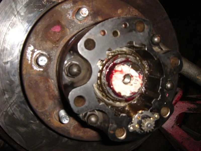

attachment.php
hi, i need hub lock motor like this photo.
how and where to buy hub lock motor?
i have Land cruiser 78, 1995 years.
sorry my bad english
