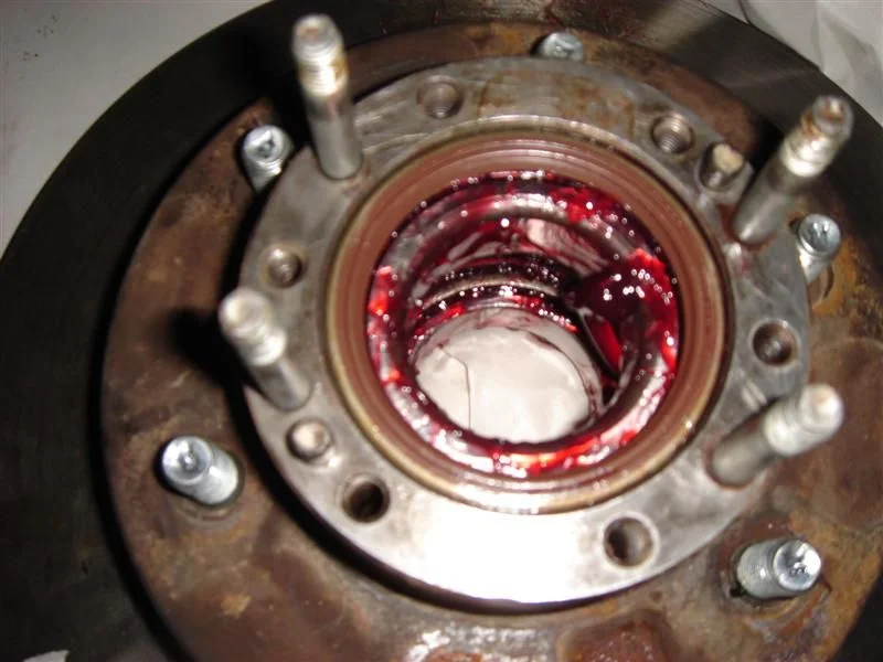

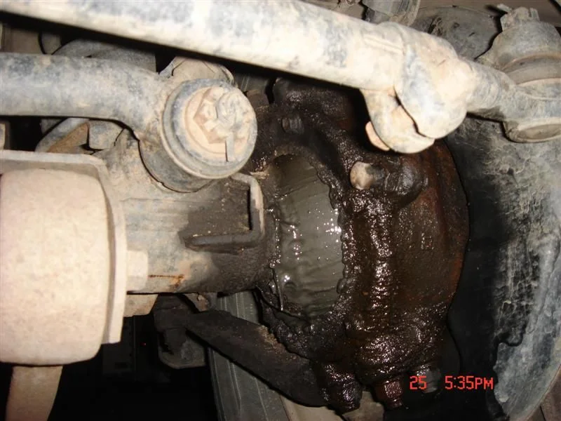

I will be performing a Full Knuckle axle service on my 91' Lj78 Prado. with Electric locking Hubs.

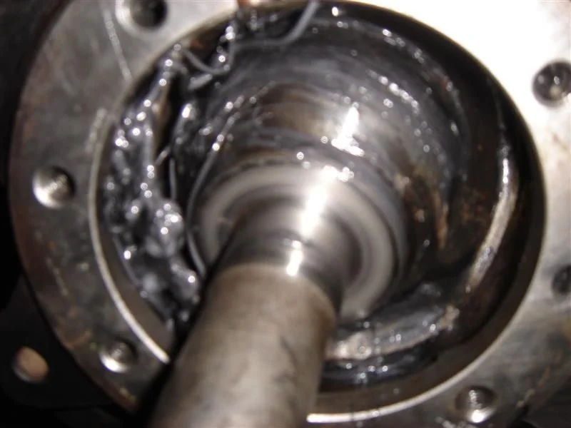

There are pics of the knuckles leaking soupy mess on my garage floor.
I have a few questions b4 i start ripping it apart and order parts.

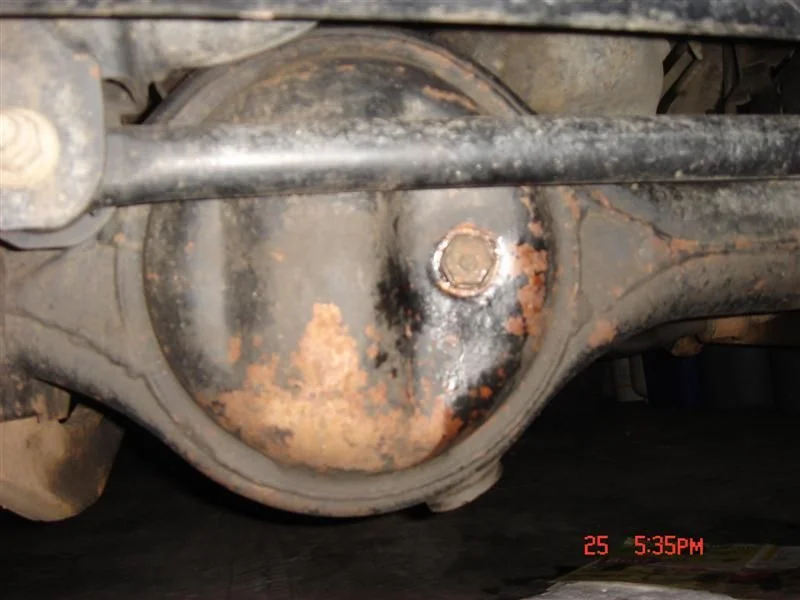

1. I checked the axle fill hole, and the soup was coming from it as well, very thick consistency. What should i use to clean the axle tubes and the insides after i have everything apart. Water Hose through the axle seal holes, Air Dry and then flush with gear oil?

Generally we use a brake cleaner solvent to rinse the housing out when we have it all apart. If yours is really bad, drain the oil out and run some varsol or paint thinner through it for a short distance (a hundred meters), then drain it out and refill it with fresh oil once you have completed the front end service.
The sloppy mess that's in there is going to be a mix of oil and grease, and really it doesn't need to be washed out if you don't want to do it.... new oil will dilute it down over the long haul. If the sloppy mess is grey in colour - meaning it has water contamination - you need to get it really well cleaned out with paint thinner or solvent.
Don't put water in the housing.

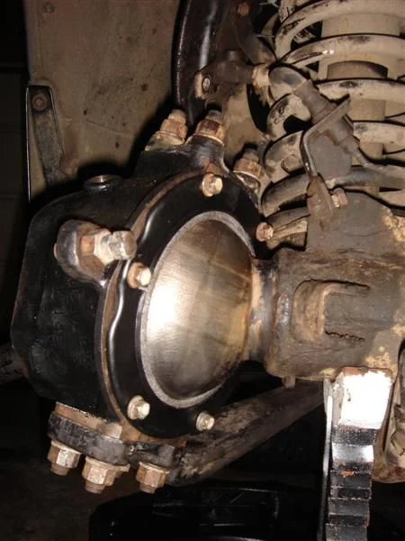

Hello All,
Here are some pics and pointers about the axle service procedure on LJ78.
Shots and explanation first.

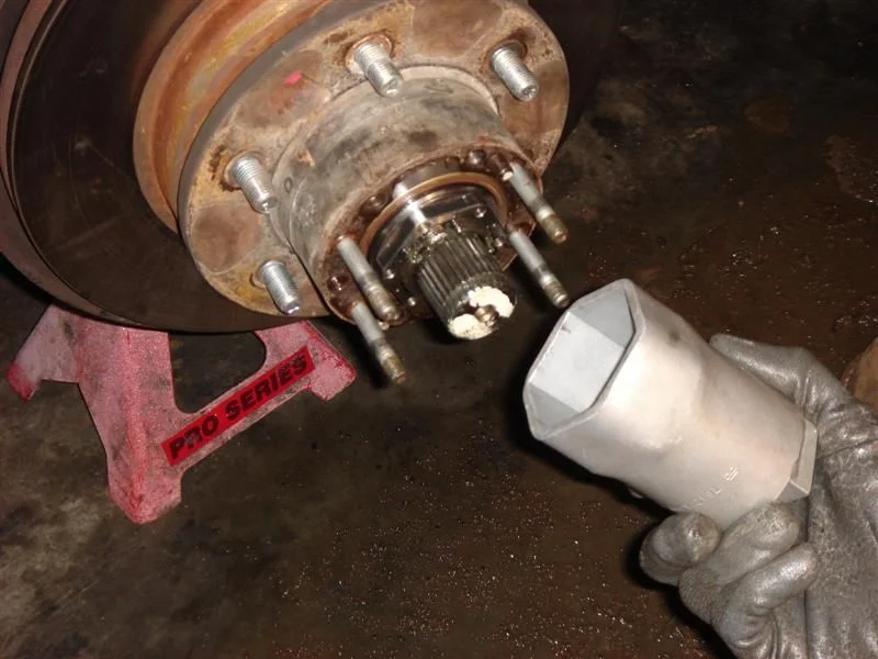

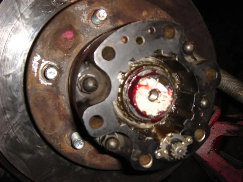

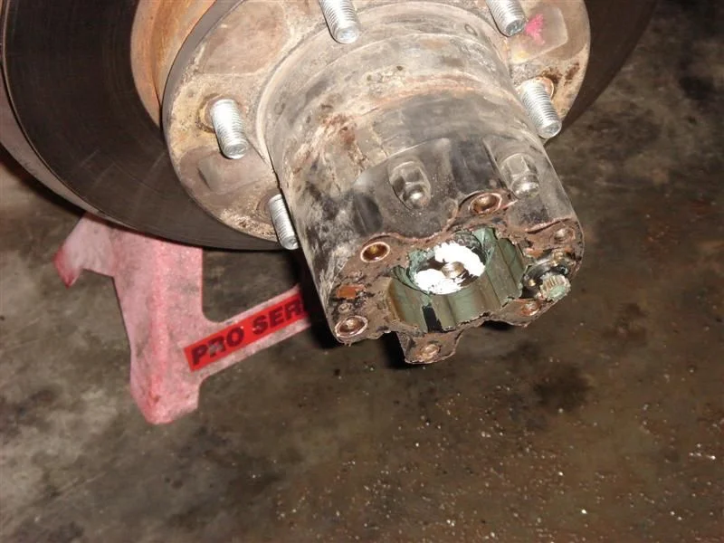

Here the pics of the Locking HUB assembly with the front cover removed.
The front cover is held by 6 T40 Torx Bolts.
You can see the protuding axle shaft and outline of the C-clip that holds it from going back.
The Hub is held additionally by 4 bolts with cone washers underneath.
Remove the C-clip, and remove the 4 Bolts,washers and cone washers.
Slide the hub assembly off.

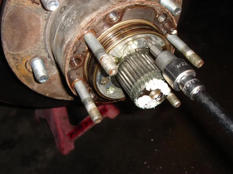

You are gonna see the electric slip ring Held by 3 T27 Torx bolts. I did not take pics of the other side of the Hub, Gonna take them and post them later.
Remove the 3 bolts and the slip ring comes off,
you can see that it has 2 electrical contacts and one indent to keep it in the spindle.
Underneath you can see the 54mm bearing nut.

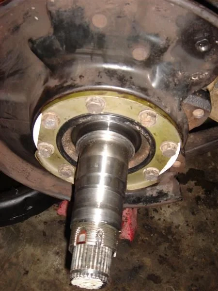

Unscrew it, put it aside. The disc brake Hub can now be slid out. Take care to hold the disc up so that it does not drag on the spindle. You do not want to damage the seal at the back. The back side looks the same like other land cruiser hubs.

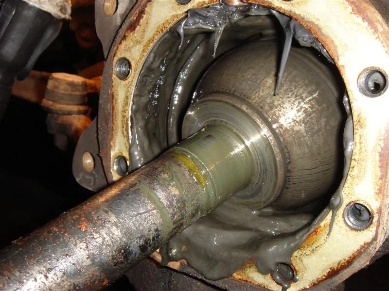

Remove the 8 spindle bolts and remember to remove the electrical connector above. It might take some cajoling with a drift .But try wiggling the end and slide it out. The electrical connector is attached and come with the spindle. One does not have to do anything else with it other than cleaning.

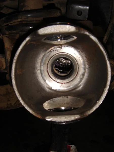

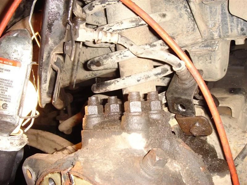

Now you should be able to see inside the knuckle and the Birfield. There are two flat spots machined on the surface of the birfield. They are about a finger wide so cleanup the grease first. The diff side axle shaft should always be supported by hand, so as not to exert too much force on the inner axle seal. The surface of the shaft is ridged and can cause the rubber seal to chafe without lubrication.

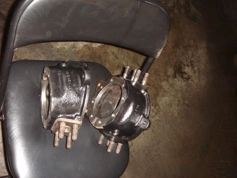

The swivel housing on Driver side (RHD) is held by a cap on top and a tie-red arm (with cone washers) on the lower side.
The passenger side has tie-rod arms on both top and bottom with cone-washers. I installed new knuckle bearings and races. The lower bearing can be held with a glob of moly grease. The seals at the back were installed in the following order, steel ring with gap at the top, rubber ring with the lip facing the diff, felt seal and metal retainers.
Sorry No pics of Birfield dis/assembly. But some Pointers. The pictures in the Toyota manuals for this are outdated and data from the mini-truck axle days.
I used the manual instructions for joint disassembly i.e. A vise first, then a long pipe on the wooden piece.. For prado , there are a few details to note. The inner race has a flat side. The case has D shaped gaps in it for the balls to come in and out. The flat side of the race and the curve of the D are on the same side, and it will face you, as you install it.
When installing the shafts, put moly grease on the seal face and i lubed the shaft lightly with some gear oil. ON installing the passenger side (RHD) longer shaft, take care to support the axle shaft weight with your hand and slide it in gently. It would not go in, use ur hand and seal as a fulcrum and press down on the outer shaft with your hand. It will force the inner axle shaft to move up and slide in.

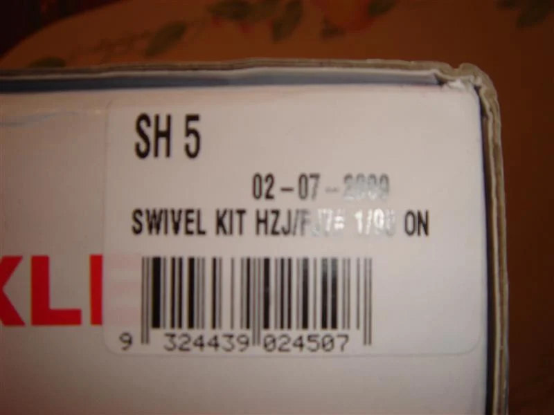

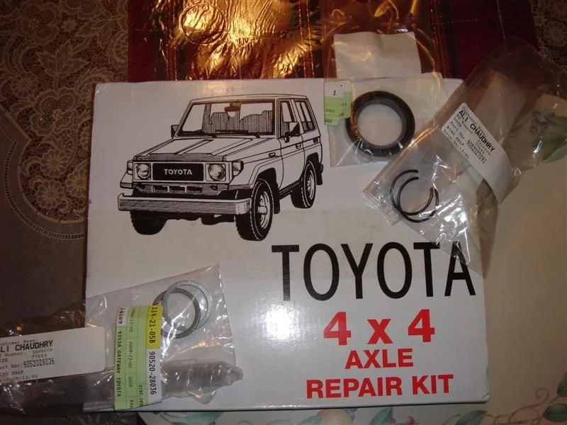

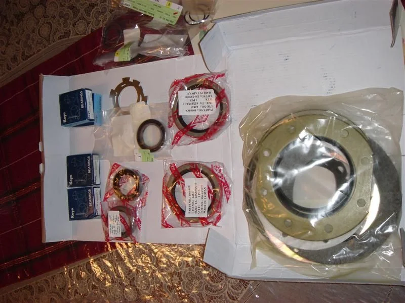

Some pics of the Kit i got from Australia. Its a made in Taiwan unit with gaskets, axle seals and dust seals etc.
I installed new bearings and races with seals in my hub. The bearings and rear hub seal are the same for 60 series landcruiser ( easily sourced at NAPA and Cdn tire). The front seal, which seals at the surface of the 54mm bolt had ro be sourced from Japan, along with the 2 gaskets for the power locking hubs. The swivel housing back side 3 seal set was identical. The paper gaskets for the spindle and the dust seal(yellow color) for the hub was a direct fit as well.
The hub side gaskets that will come with any of these kits would not fit out trucks.
We need to source them separately.
The part no for the outer hu cover gasket is 43531-60030. It will have to come from Europe or Japan (AFAIK)
The gasket that goes b/w the hub assembly and disc brake hub is 43422-60040. It is used in a 97 landcruiser or LX450 rear axle, so it can sourced from a local dealer.
About Bearing Preload: If you look at the electrical ring and the 54mm nut underneath. The nut has screw threads at each corner. The Ring has two holes side by side. The bearing preload can only be set at these two locations. One is looser and tighter. Choose whichever one is the best for you. Previously i have used both. This time with new bearings and races, I tightened the adjusting nut to the right most hole on the ring. The ring holds the nut in place. There is no star shaped washer required.
