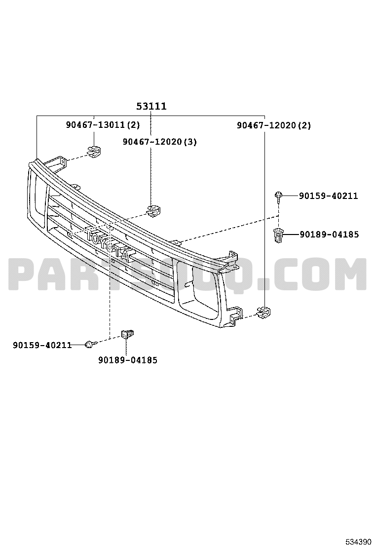

The sad thing is the guy painted the grille flat black too. I can peel the paint from the chrome with acid, but the acid might melt the plastic grille. I was thinking I might just paint the toyota/turbo logos on the grille yellow. Do you think I should go with yellow, or try to carefully peel the paint off the chrome TOYOTA with a small paintbrush? I don't want this to be an ugly truck. The other thing I was thinking is maybe we should just affix an oldschool metal TOYOTA badge from an FJ45 to the front. WWYD?

You can get the grill:
There may be less expensive places to get the grill from.
If I was to keep the grill, I would paint the Turbo logo red.

Oh I have the grille. It's just not attached 'cause we've got to mount the intercooler. But the previous owner spray painted the grille fat black too. I'm just going to peel the spray paint of the Toyota and the turbo. I'll consider red. Got to deal with the mechanical stuff first though ;- )
