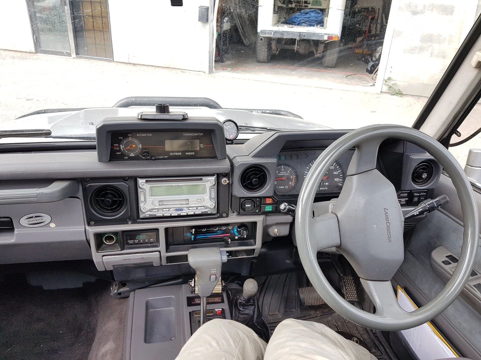

I believe this one already has some of those gauges installed.

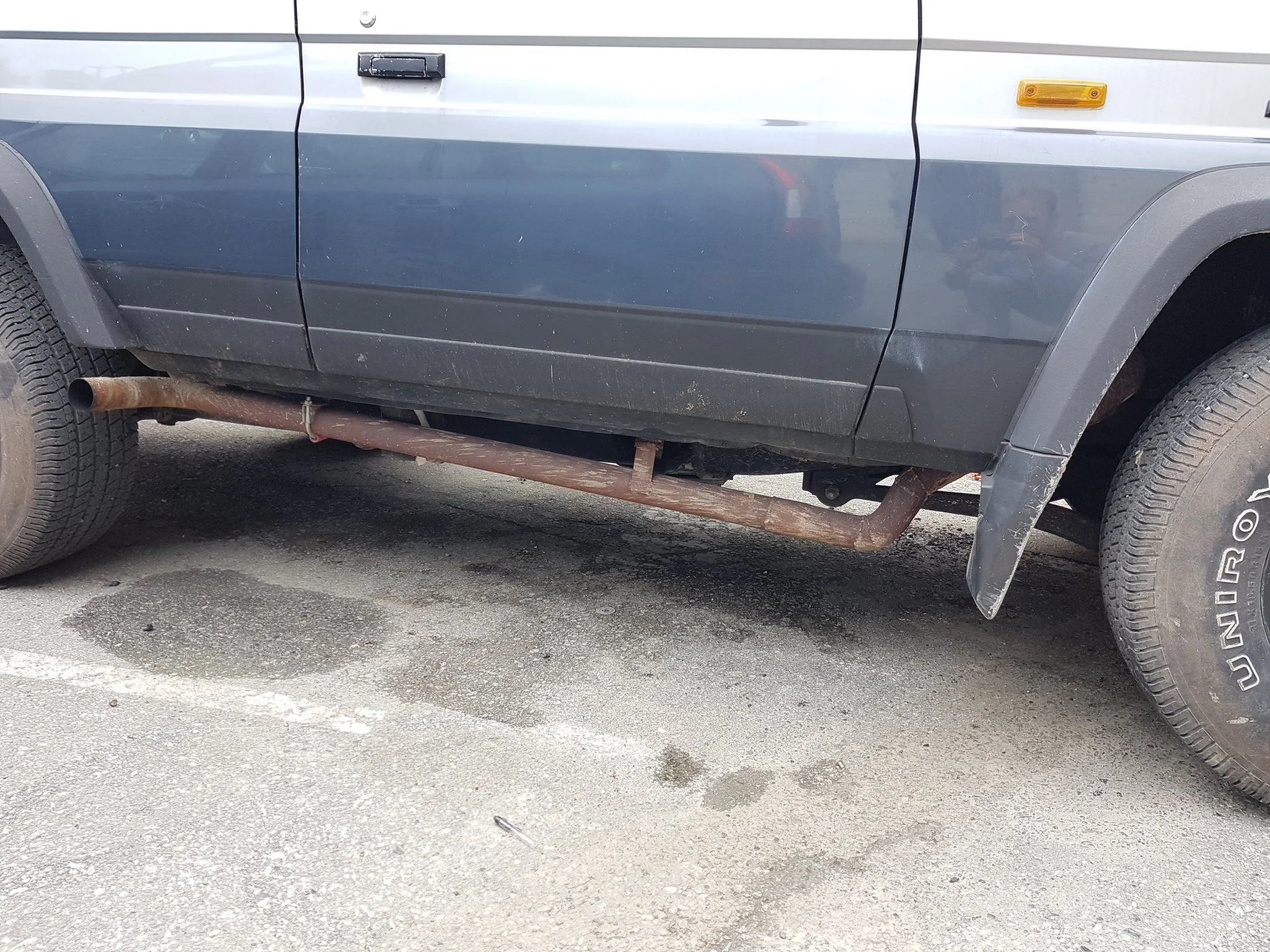

Definitely need the snorkel and turbo back exhaust too. The thing is currently a straight pipe exhaust and it is LOUD.
