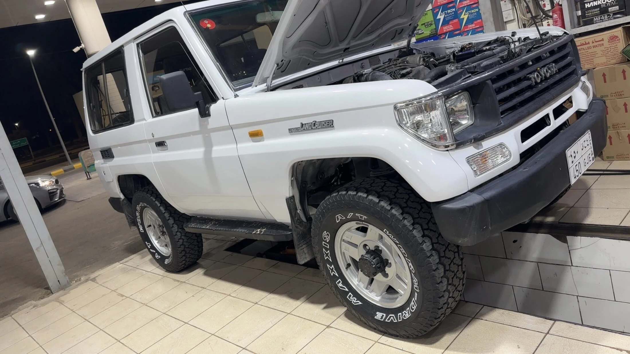

Hi everyone,
I wanted to share the latest updates on my Toyota Land Cruiser Prado LJ71 (automatic) project. I’ve done a lot of work on it recently — from engine swap to paint and tires — but I’ve run into several issues that I hope to get some feedback on.
What I’ve Done So Far:
1. Engine Swap – From 2L-TE to 3RZ-FE:
The Prado originally came with a 2L-TE turbo diesel. I swapped it for a 3RZ-FE (2.7L petrol) engine to improve power, especially for city and occasional off-road use.
2. Hilux 2WD ECU:
I’m using an ECU from a 2WD Hilux to run the 3RZ-FE. I’m wondering if this could be the reason for some of the problems I’m experiencing, particularly with idle and transmission-related electronics.
3. Transmission – A343F (Mechanical, No ECU):
The automatic gearbox is the factory A343F, a mechanical transmission without an ECU. It shifts fine, but some of the functions like ECT aren’t working anymore (more on that below).
4. White Paint Job:
I repainted the Prado in clean white, giving it a much fresher and more classic look. Really happy with how it turned out.
5. Maxxis Tires:
I installed Maxxis off-road tires. They’ve been excellent so far, with great grip and road stability. They also give the Prado a tougher stance.
