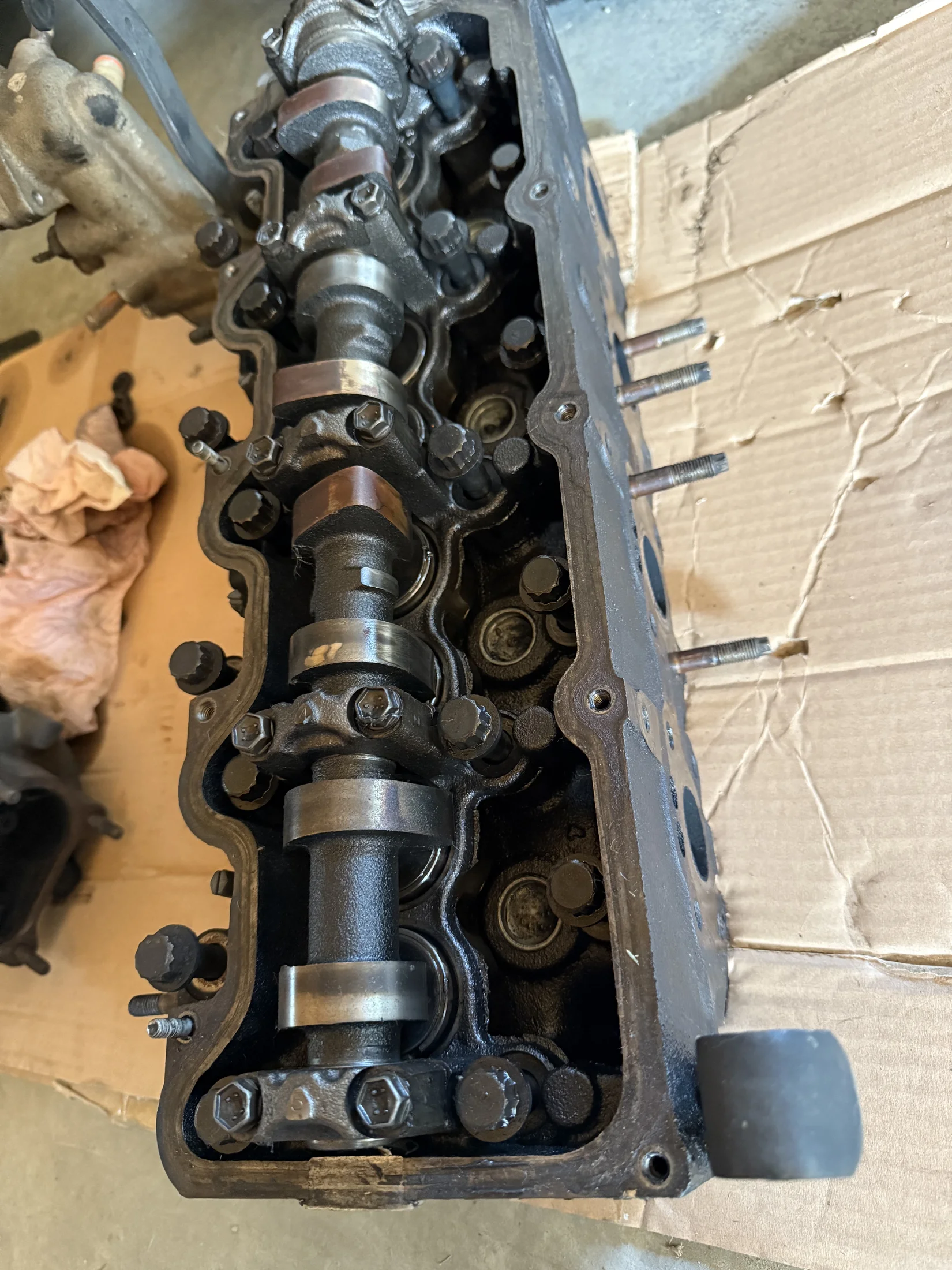

Guy typically swap their valves over from their old head or just replace with all new valve train? The cam is surface rusted in the head I currently have so I was looking for something somewhat complete. Or I guess just a direction at this point since I can’t seem to find a resource for a complete unit.

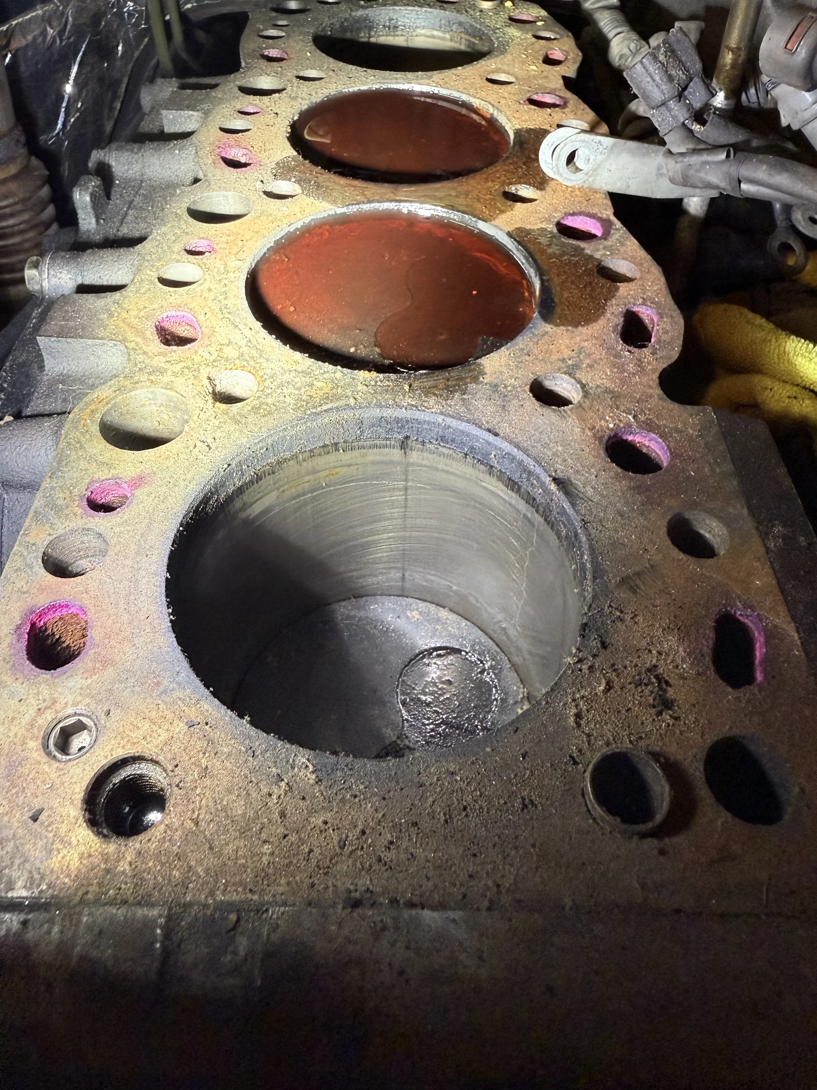

This is how I received the vehicle. The cylinder head has been pulled off it quite some time, that’s just ATF soaking in the cylinders freeing up some carbon buildup. Can still see crosshatch in the cylinders even and the deck surface appears to be in good shape under the dust buildup. It’s in super good shape and the L series only shows 90k on the odometer.
If the open engine block been exposed so long that so much dirt has built up on the top surface, that block needs the oil galleries very thoroughly cleaning imo. Which would require stripping the engine fully.
The coolant passages also look like they need acid cleaning, though this should be done with the engine assembled. I'd want to pull the oil cooler too, to look for blockages. There's not really any room for error in the cooling system of a 2L-T.

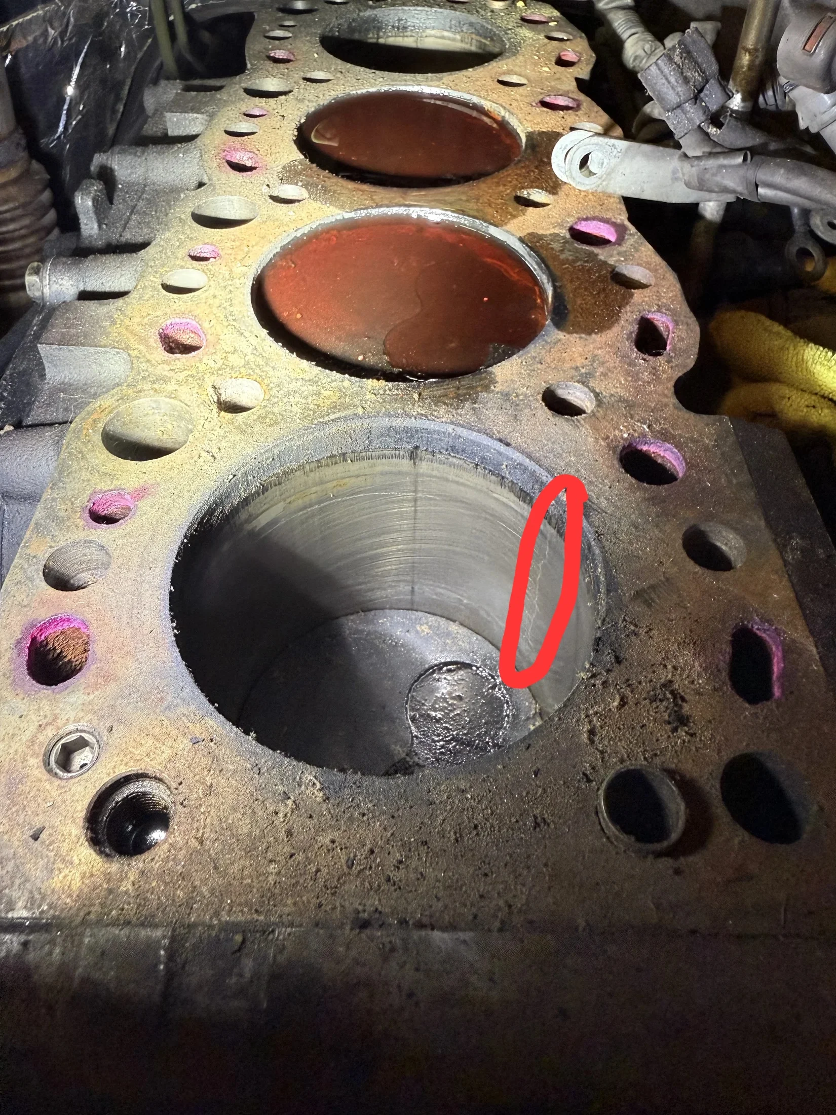

And what is this jagged vertical mark in #1 the cylinder bore?

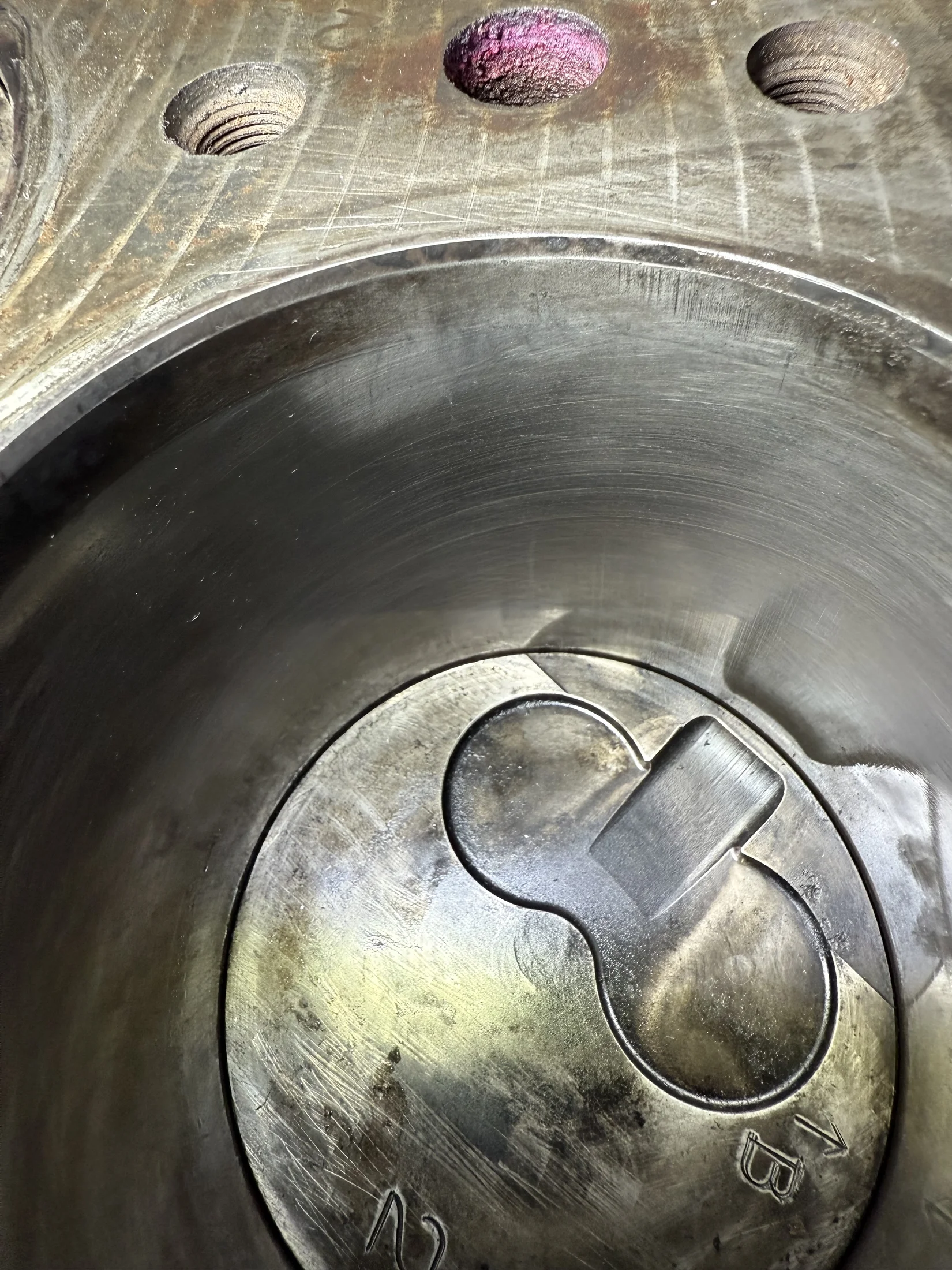

I’m inspecting that tonight actually. It looked like a crack at first but there is zero seam. It’s almost like a water etch. See tonight though
Apologies for the double post.
If you can't wipe that mark off, I would assume that it's a crack. No scratch from dirt in the rings or piston skirt wear would look like that. It could be taken to a machine shop for magnaflux checking if you can't catch an edge on it with a fine point.

Could be sleeved I’m sure? I’ve had that done before
If it's a crack, I would scrap it. But a good machine shop could give you a more informed opinion. I'd be worried that the crack either already extends up to the deck of the block, or will propagate up there in future, potentially undermining the head gasket. I don't thnk you could pin the ends of the crack given the location. I'm not sure what the situation is in the US, but where I'm from it's easy and cheap to get a dead 2L and use the block from that.

This is after a quick scuff of 1000 grit
