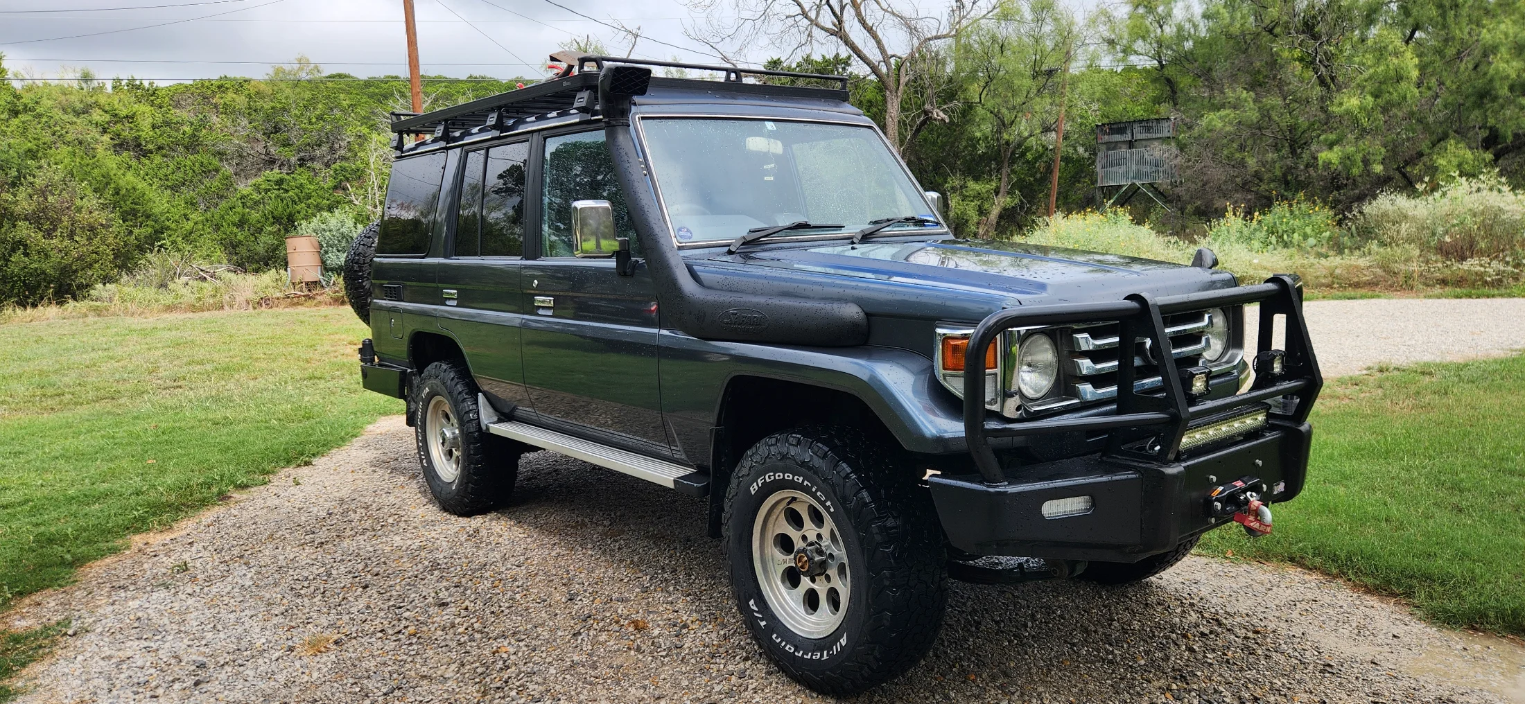

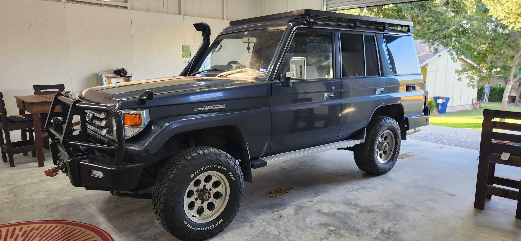

I'm trying to figure out what lift or what I can do to level out my suspension. Currently theres a 2 inch lift Leaf springs say Zeal and shocks are Rancho. It's sagging pretty badly on the rear, especially the right rear. I was thinking about the OME 2.5 heavy lift from Cruizerteq but if I can get away with something more economical with the same outcome, that would be preferred.
Here are the measurements from floor to fender.
Left front 37 3/4
Left rear 36 3/6
Right front 36 3/4
Right Rear 35 1/2

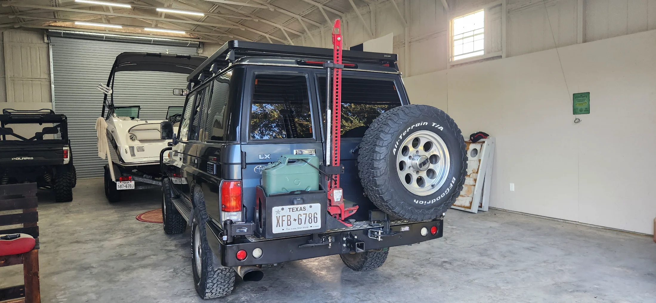

I have Dobinson Front Bull bumper and Rear bumper with full size spare and Jerry can
Dobinson 2 drawer in the back.
These are Leafs on all 4 corners.
Any ideas welcome

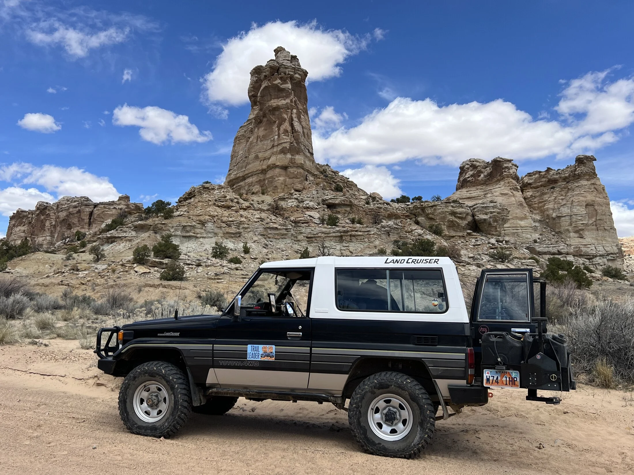

Some pics: Builds - HZJ75 Troopy - campin' roadtrippin' wheelin' build - https://forum.ih8mud.com/threads/hzj75-troopy-campin-roadtrippin-wheelin-build.1288426/post-15857676
