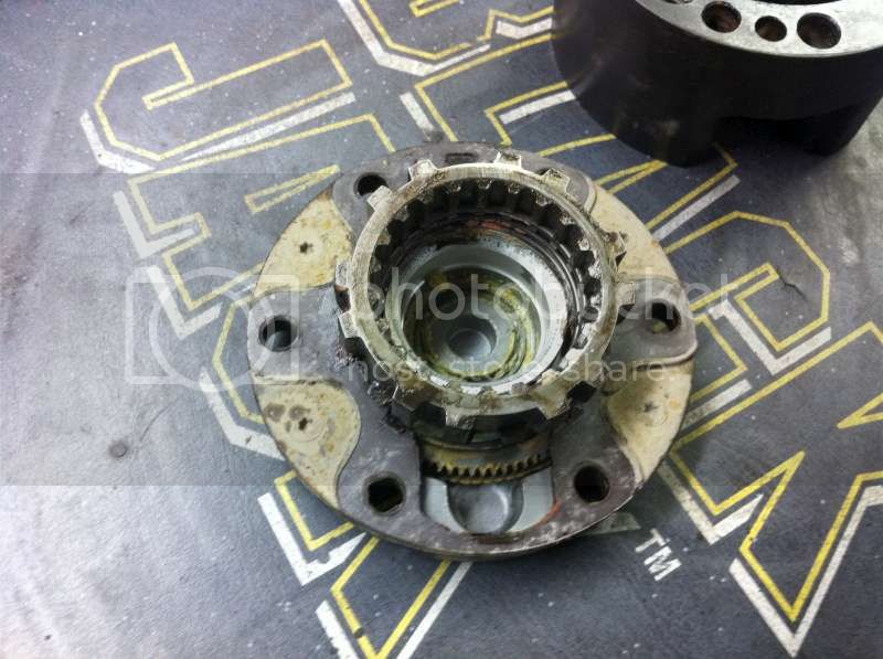

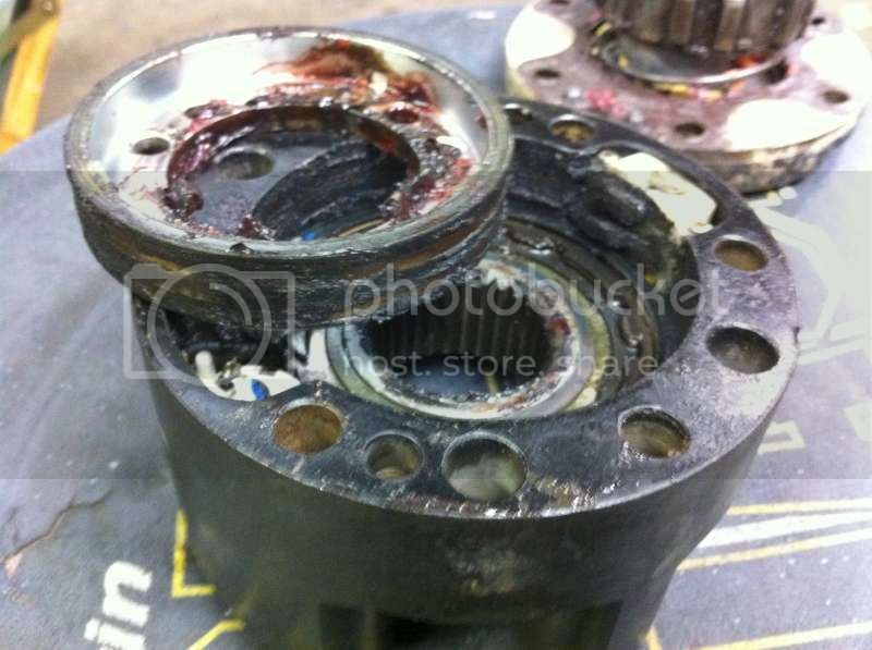

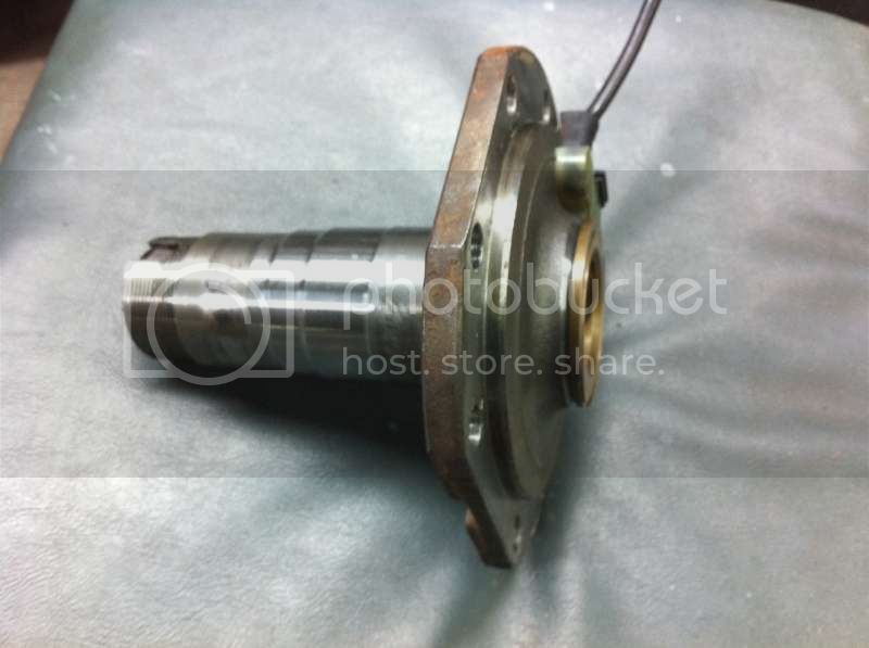

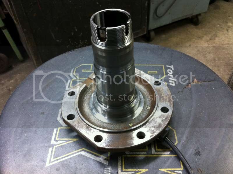

I'm in the process of hopefully going to manual locking hubs... Thought I might share a few photos and maybe show just how the system works.
Notice 4 studs to accommodate SMALL ELECTRIC MOTOR
Center of electric locking system FRONT SIDE showing small electric motor which turns the hub instead of the operator...
Backside of center of hub unit with constant pick-ups via two small spring loaded contacts on copper ring terminals (very dirty covered in grease)
Backsize of outer piece of hub. Notice small gears where electric motors meshes to move hub locking mechanism
Hub with contact pickup sleeve two small divots in shaft threads for electrical pickups ATTACHED TO WHEEL BEARING TORQUE NUT...:eek:
Backside with pigtail exposed.

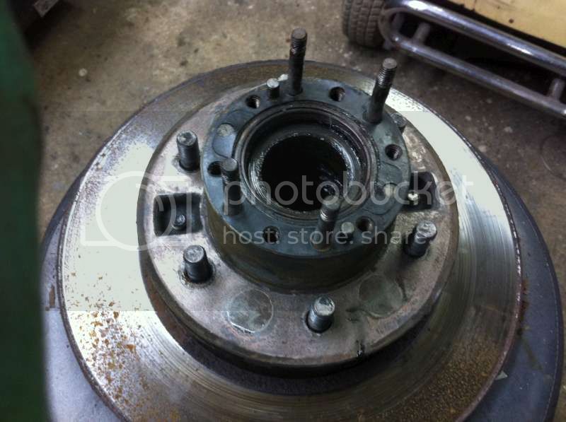

I got some wheel hubs from an early 70 or was it 60 series....
Fitted on my "electric" stub axles.. I reused the factory wheel bearing nut.
Just need to reduce its thickness...
Works a treat....No issues to date and that was over 100k klms ago...
