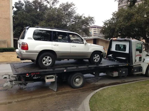

Walk of shame ;(
Oh well, first time on a flatbed in 15 years...not too bad!
