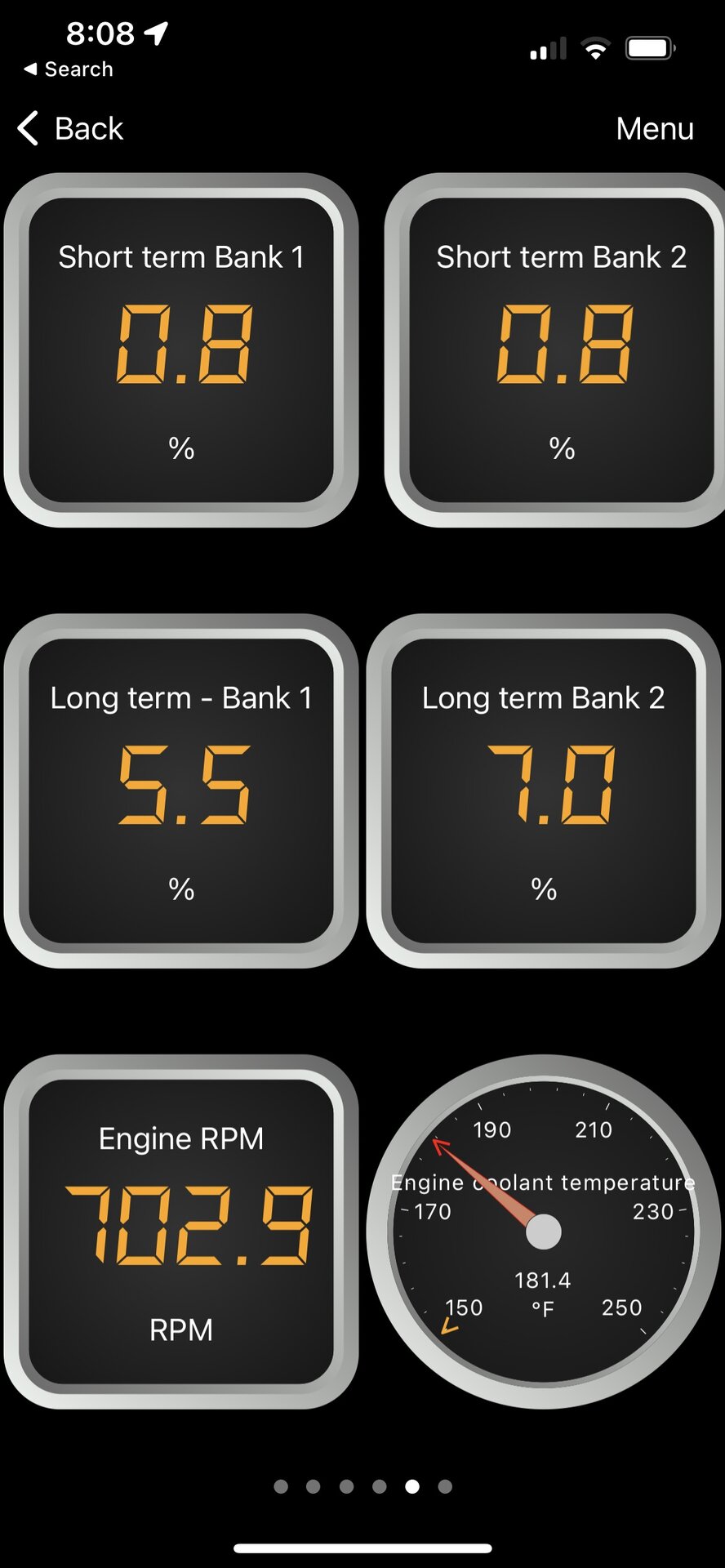

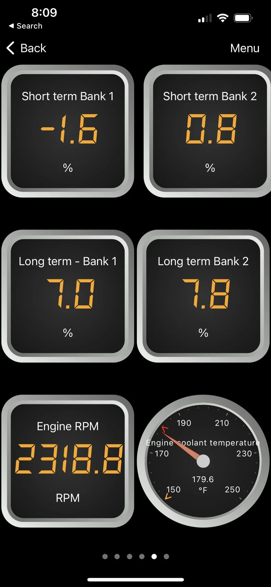

I’m a fuel system noob - am I pulling in the right data on OBD Fusion? Any other useful data points to add to this dashboard?
I snapped these while parked. Engine was not quite up to operating temps. I will be road-tripping later and can snap again after a few hours of operation.
I’m no expert but those long terms seem excessive.
I’d monitor how those change after a long drive.

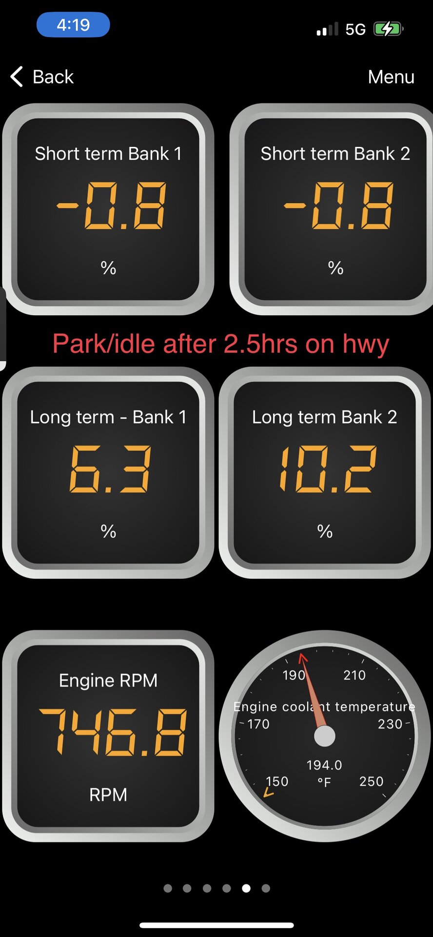

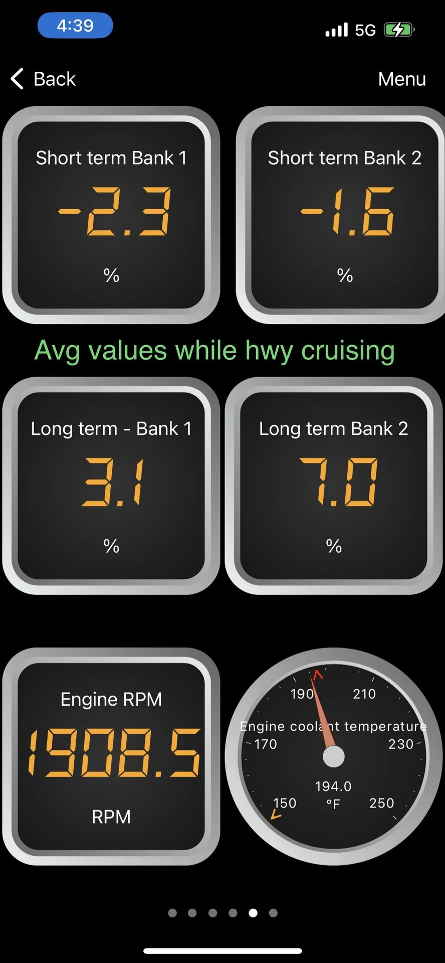

Here are two values from 240 miles of driving today. Long term fuel trims fluctuated like crazy when I would left off the gas at highway speeds. Both banks would hit 12.5% plus.
The first pic is the general average at most pedal positions of highway driving. The second pic is my in P and idling after 180 miles of driving (car had not been turned off).

That looks like enough trim that I would definitely look into fuel pressure as the next step.
As you're finding, trims are not singular. They are a map of values against load and rpm (and potentially more). They really only have meaning on throttle. Coasting closes the throttle body and fuel injectors so trims aren't as relevant.

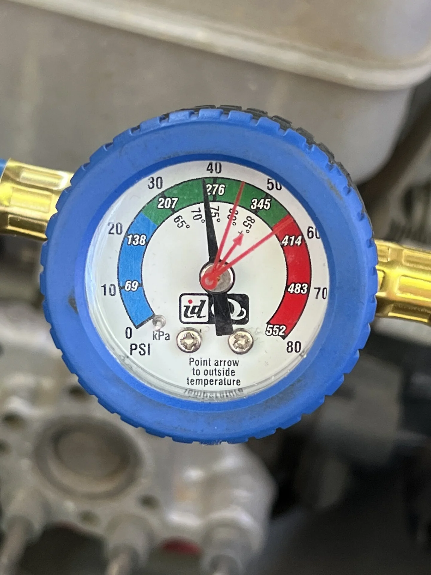

Because of this thread, I've long suspected I was slightly low on freon, since my rear AC runs warm while both front AC and cool box both work fine. I grabbed a gauge from a old DIY Freon Recharge kit and pulled this pressure at 104º ambient temperature. I have never recharged freon on this car and am kind of wary to do so.
Questions
  • does anyone know low/hi AC pressures for the 200 series? I've only found it for the 100 series here and cannot find in my owners manual
  • is it safe to assume there is correlation between the AC compressor cycling on/off and my rear AC blowing warm? If 200 series are the same as the 100 series numbers I posted above, my low side should be 42-55psi.
    • I don't want to DIY recharge my AC system until confirming 200 series low pressure numbers
  • Any chance this is somehow related to my initial limp mode issue?

Call around and get quotes on AC shops evacuating and recharging the system. You can go by pressure but the best method for us is to go by refrigerant mass. I use that method when charging mine but you must drain the whole system and pull a vacuum first.
Otherwise on the pressures I’d need to consult the FSM but don’t have access to that right now.
I do think you are on the right path.. the compressor should not be cycling that often and your front and rear AC should be able to blow ice cold. I’m not sure how it would contribute to a limp mode but it is something wrong and everything is integrated these days. Might as well address it.
