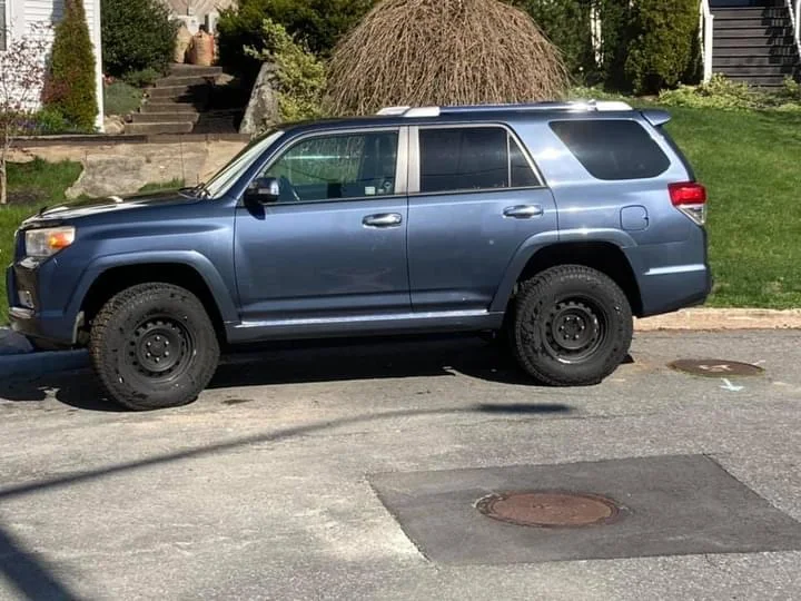

And here’s my truck after the 1” front only cornfed spacer install wearing 255/75r17 K02 tires:
