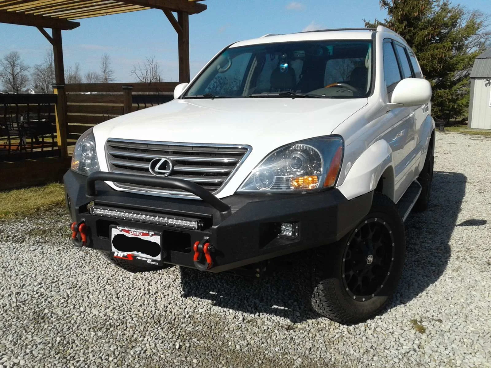

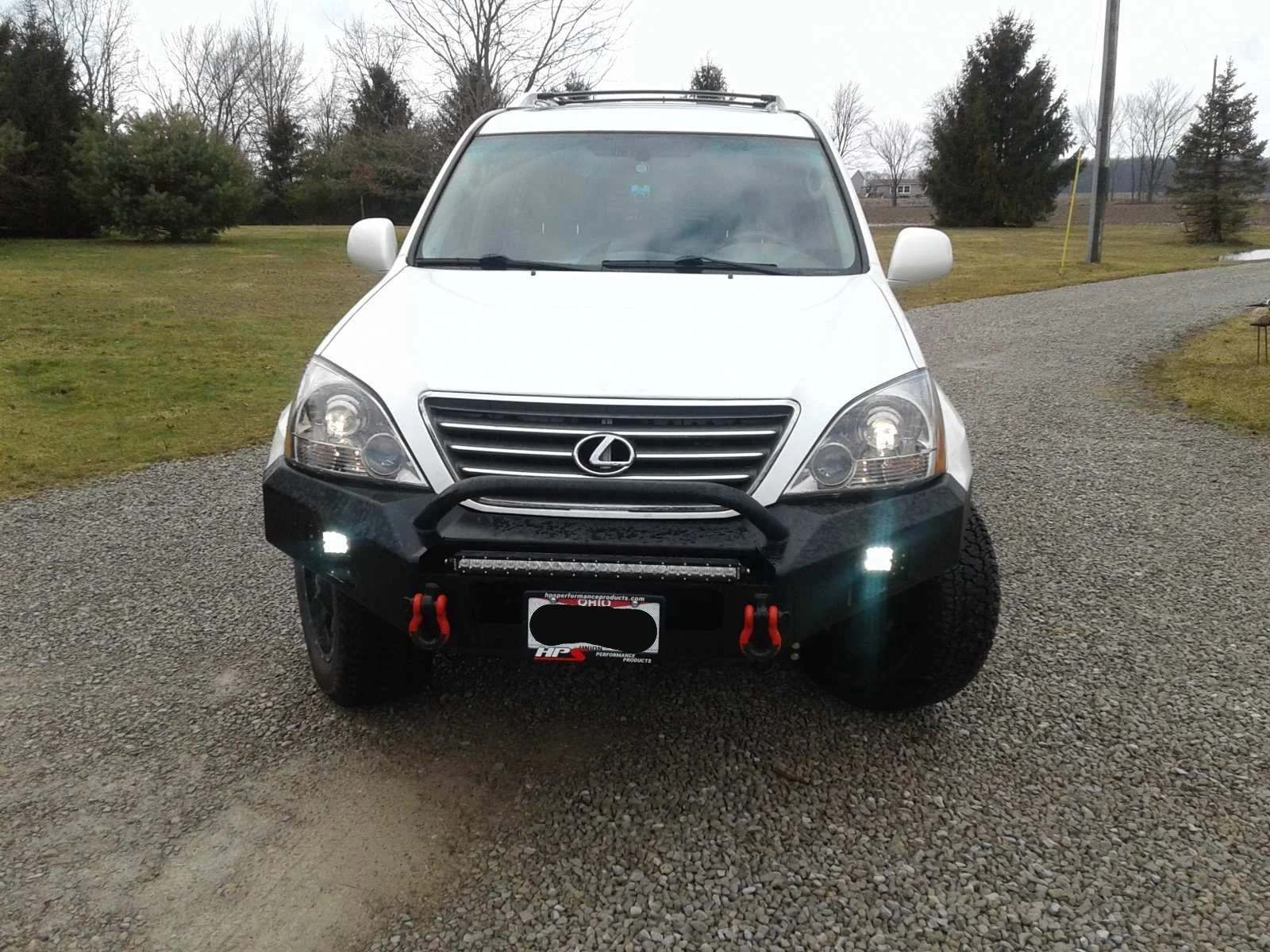

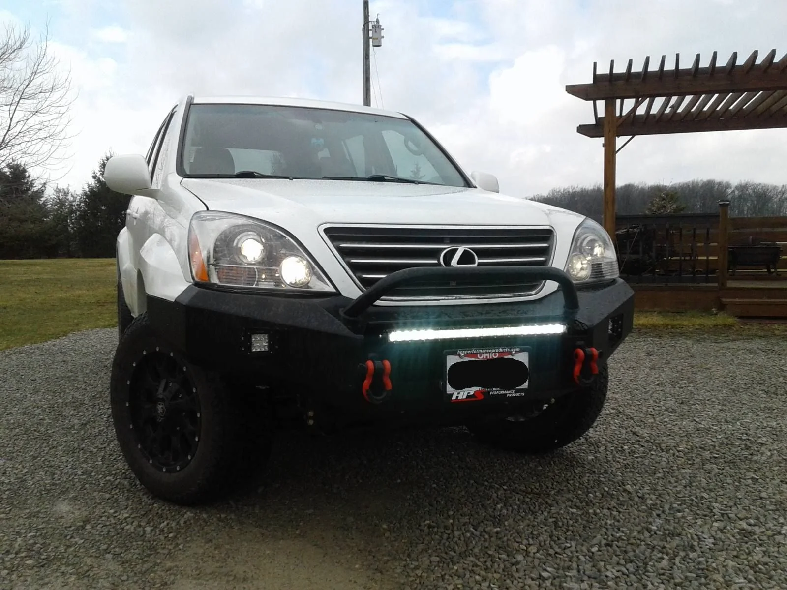

Slim light bar on the bumper. Amber lights for snow on the bumper. White and amber up high for throwing light. A matte vinyl on the hood eliminates and glare from the light bar on the roof.
We have a 20” Rigid spot/flood combo in the front bumper. It’s wired to the OEM high-beam switch. It’s amazing!

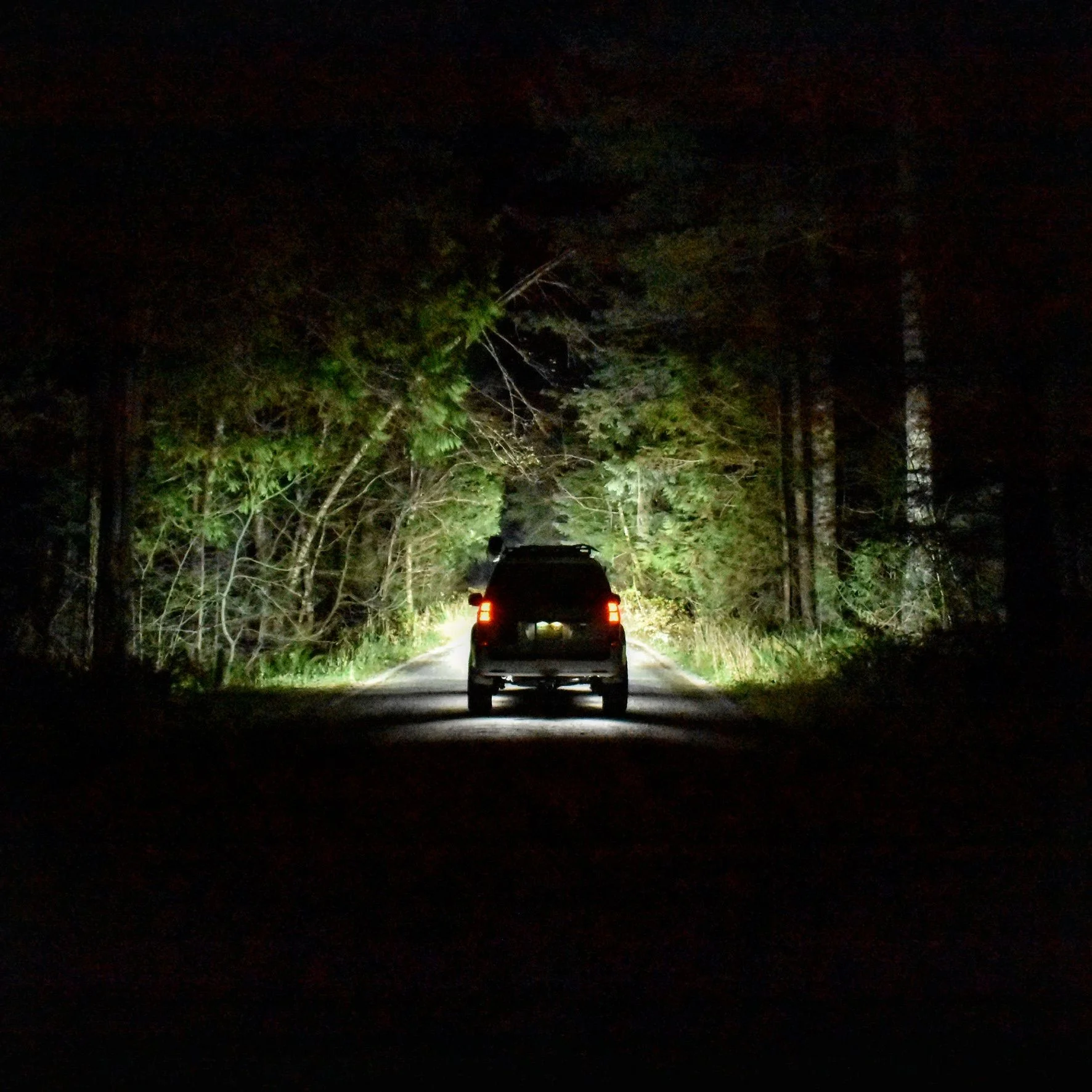

The three pods on the roof are spots. They’re great for slower trail driving, not that great as high beams on the road.
I highly recommend ditch lights or roof mounted light at a 45-60deg out. We use those more than any other.
