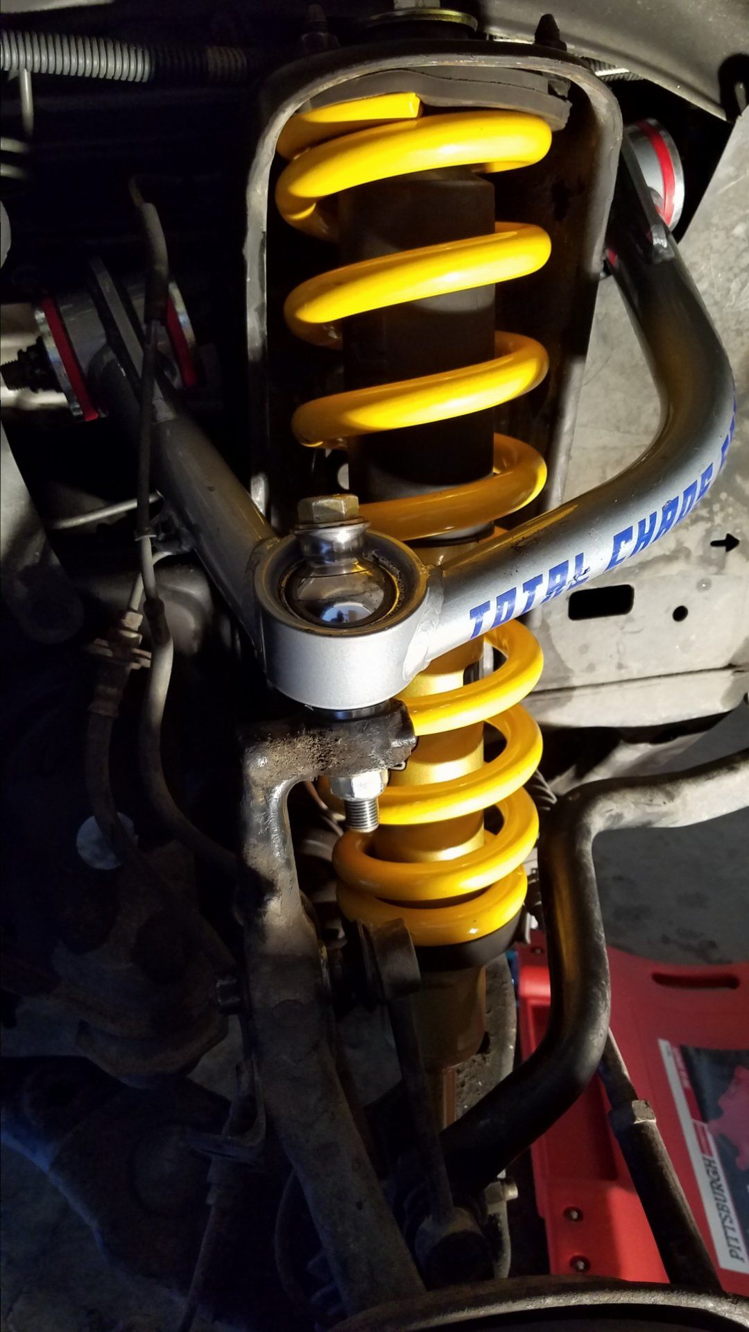

Well guys finally got it done. Total Chaos UCAs, Tjm 2.5 lift with struts and springs up front. Southern style coil conersion in the back with Tjm HD springs. Got it all put back together but i can tell my camber is all goofed up. When i loosened LCA's i made sure adjustment plate didnt move. I know it need to get it aligned but dont want to drive it too far like this. Any suggestions?

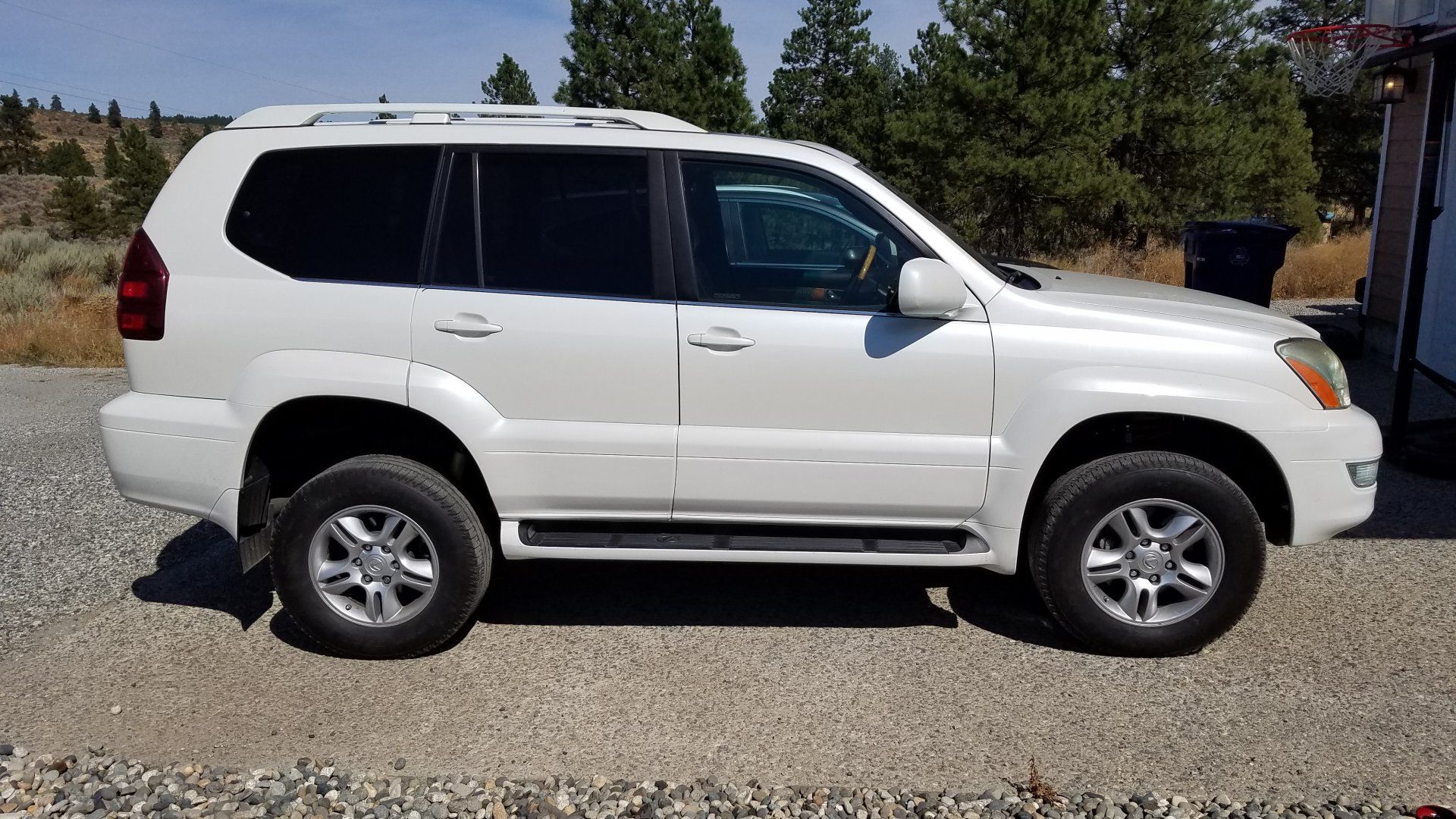

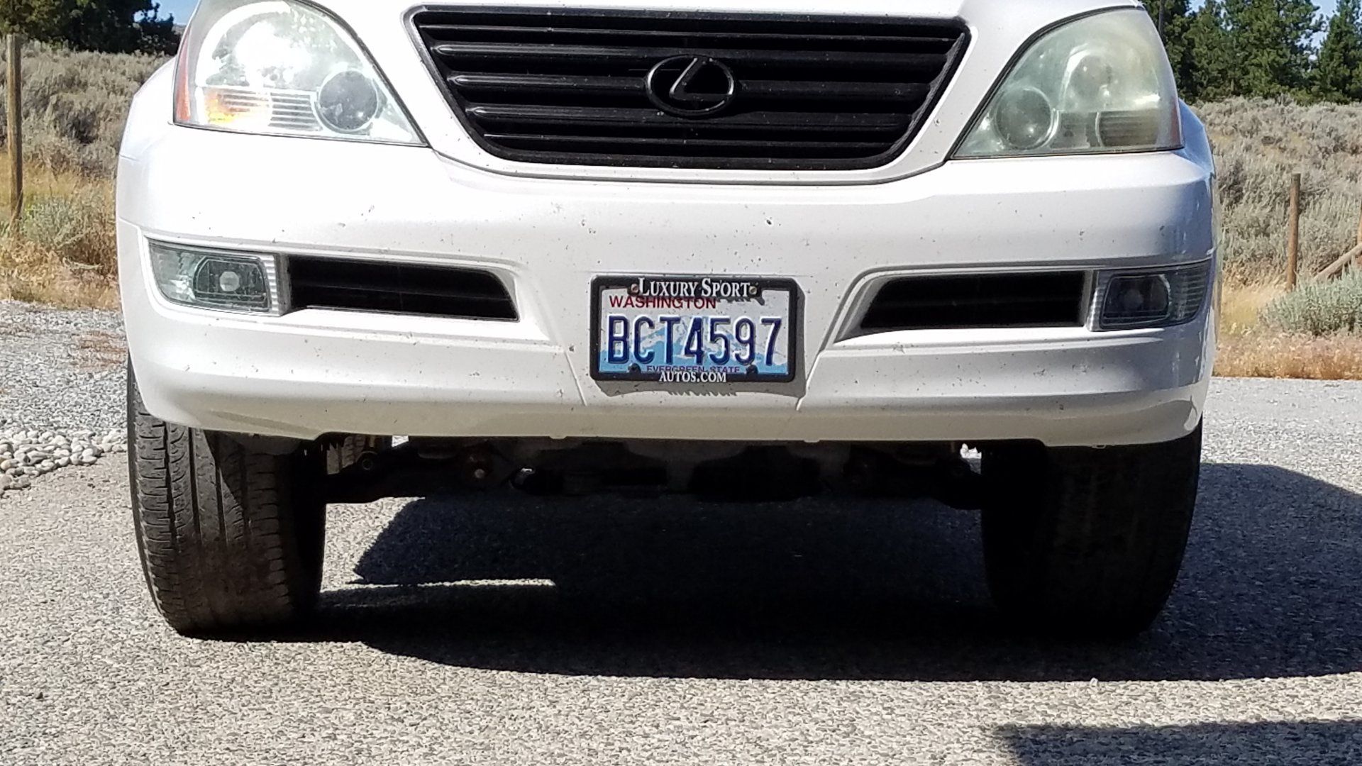

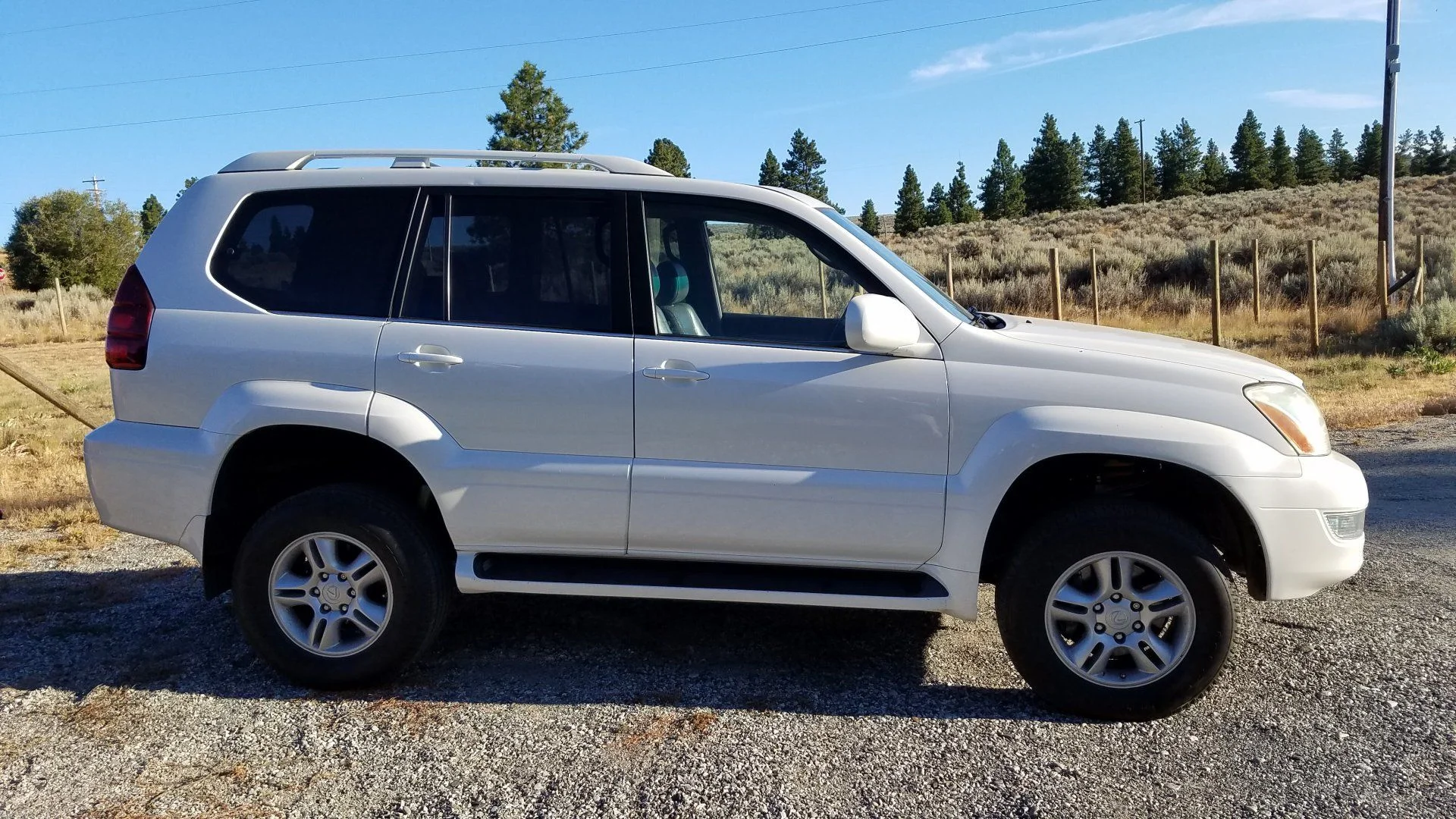

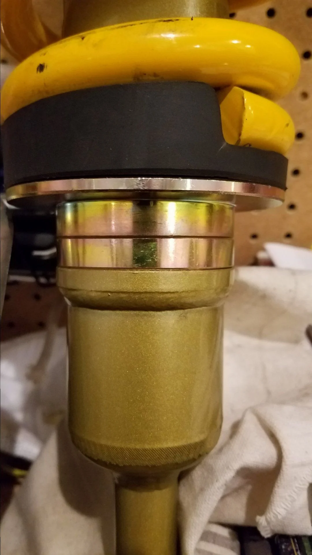

Hey guys just an update....after i finished i measured overall height to see how much lift I gained. Stock I was 20 inches in the front and 21 in the back. After the lift I was 25 in the back (HD sprimgs) and only 22 in the front. I was confused why i only gained 2 inches in the front. I went back and looked at TJM and saw i had missed a spacer on the strut. So....tore it down tonight and added the spacer and voila gained another inch! So final numbers are 23 in the front and 25 rear. The first picture is how i first had it set up and second on how it is supposed to be.
