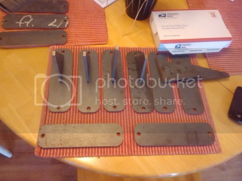

My neighbor showed up today with some freshly cut waterjet parts for me, I'm pretty excited, these are the frame mounts and gussets for my homebrew sliders:
If I can get some Honey-do's and yardwork done tomorrow I may be able to get started on the sliders sunday. I'll post some photos if that's the case.

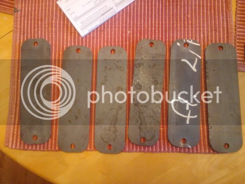

Snow has come so my honey do list has become shorter. I was finally able to sneak into the garage and get started on my sliders:
Hopefully I can find some free time to get them finished up before spring arrives!
