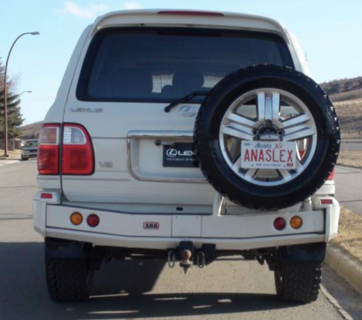

So for my 100 I’m doing arb rear swing out bumper WITHOUT the basket so all I’m wanting to do is move the license plate over to the max in the same area.
Pic is from the web for references but want the Lexus tag moved left about 5-6 inches

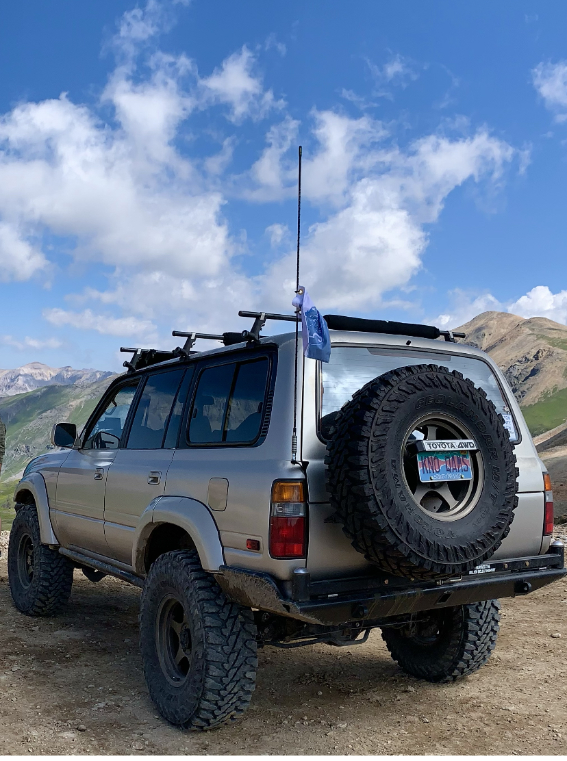

I had something like that on my 80 series, that came with my Kaymar rear bumper.

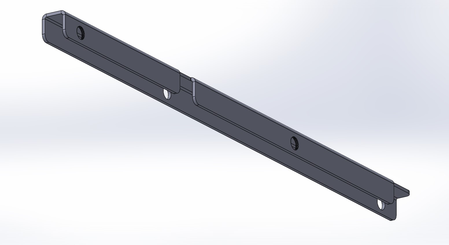

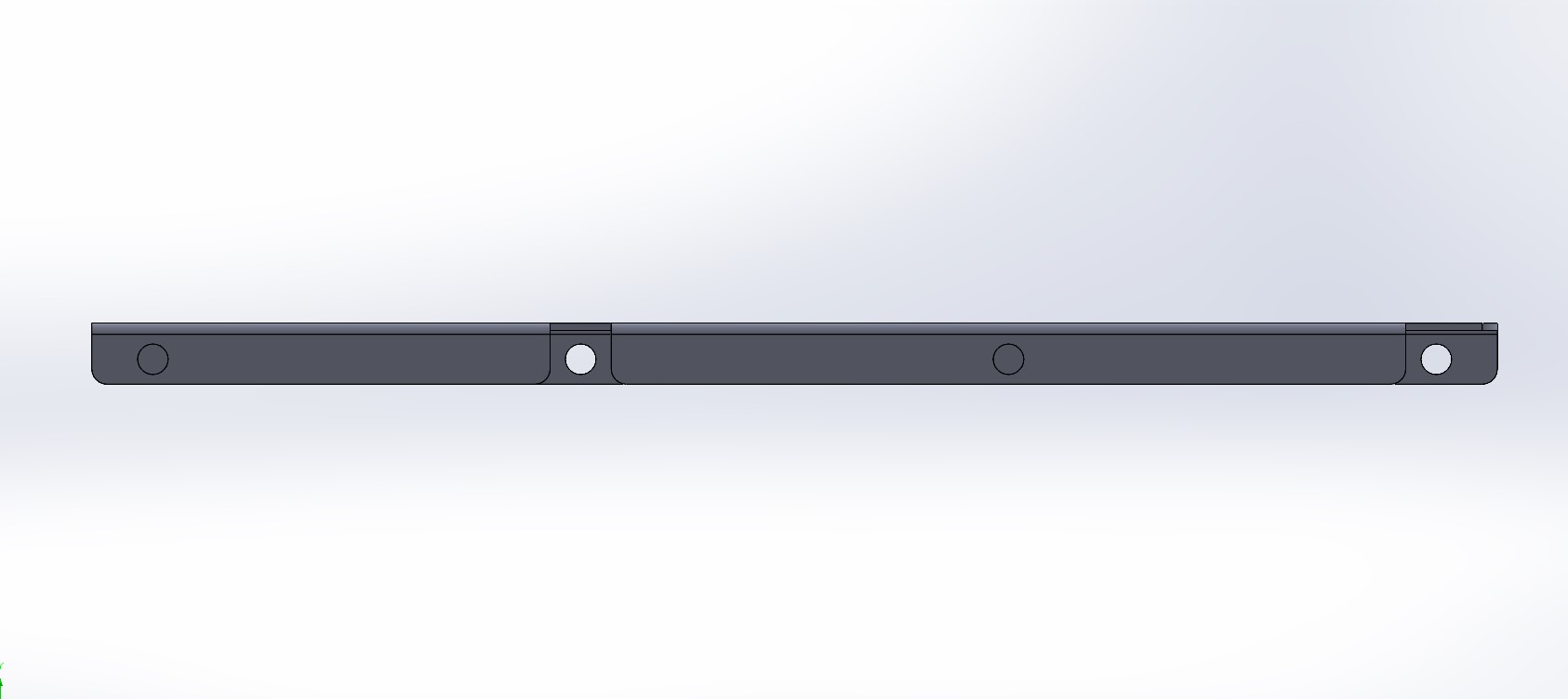

The best way to describe it would be a piece of sheet metal, formed into a C-channel, with a bit cut off to access the original license plate screws.
Something like this might work. The holes that the plate would attach to would be threaded, but the holes that lined up with the OEM mounting holes would be thru holes. This would offset it by 3-1/2" but that could be adjusted by increasing the overall length and changing the hole placement. Just put some type of foam material between the bracket and body of the truck to prevent scratches

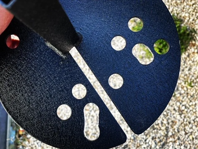

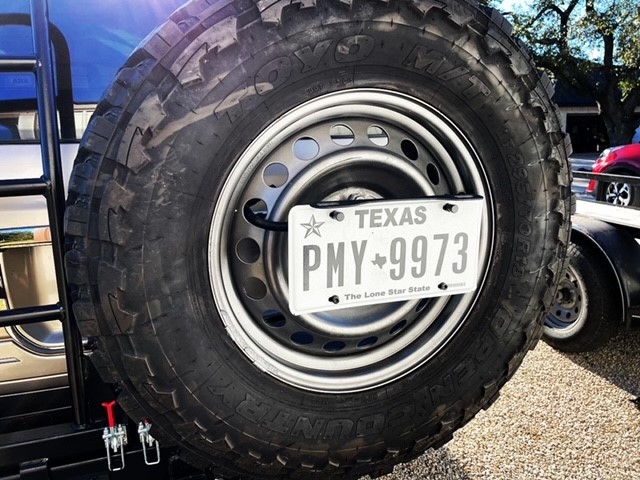

I used a Smittlybilt license relocation bracket for the spare tire area. Of course , I had to modify the hole pattern because no one else uses 5x150.

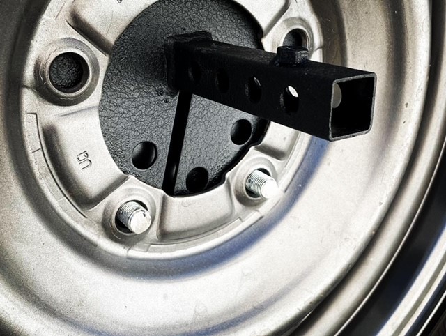

I just cut a piece of 1/8" steel in a small rectangle about 9" long. Drilled a hole about 1/2" in diameter that would fit over one of the studs holding the tire on the rear swingout., then drilled 2 small holes for the license plate bolts, secured it with a nut. painted it black, simple
