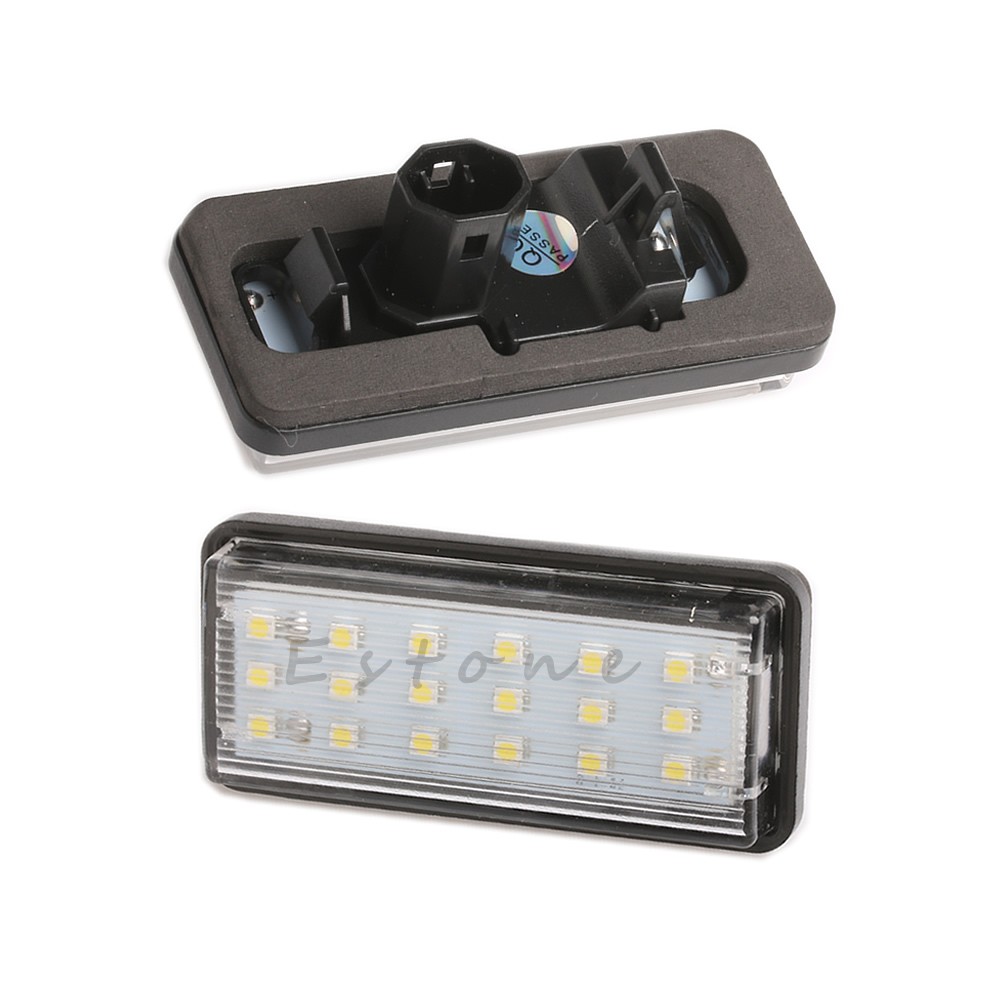

Has anyone added LED aftermarket license plate lights. Not just the bulbs but the actual housing. I'd be grateful for a recommendation. I have an '05 LC.
I'm curious if anyone has added new housings. Like these:
Yes, don't fool around with trying to replace just the bulbs. The fixture (if very old) is going to be brittle, dirty and the lenses cloudy.
Just go on Ebay and pick any of the new LED fixtures, then don't worry if your old light fixtures break taking them out. The wire and connectors are right there at the light. Just unplug them, plug the new light in, pop them back in place. MUCH brighter light.
Took me all of 5 minutes to do it.
