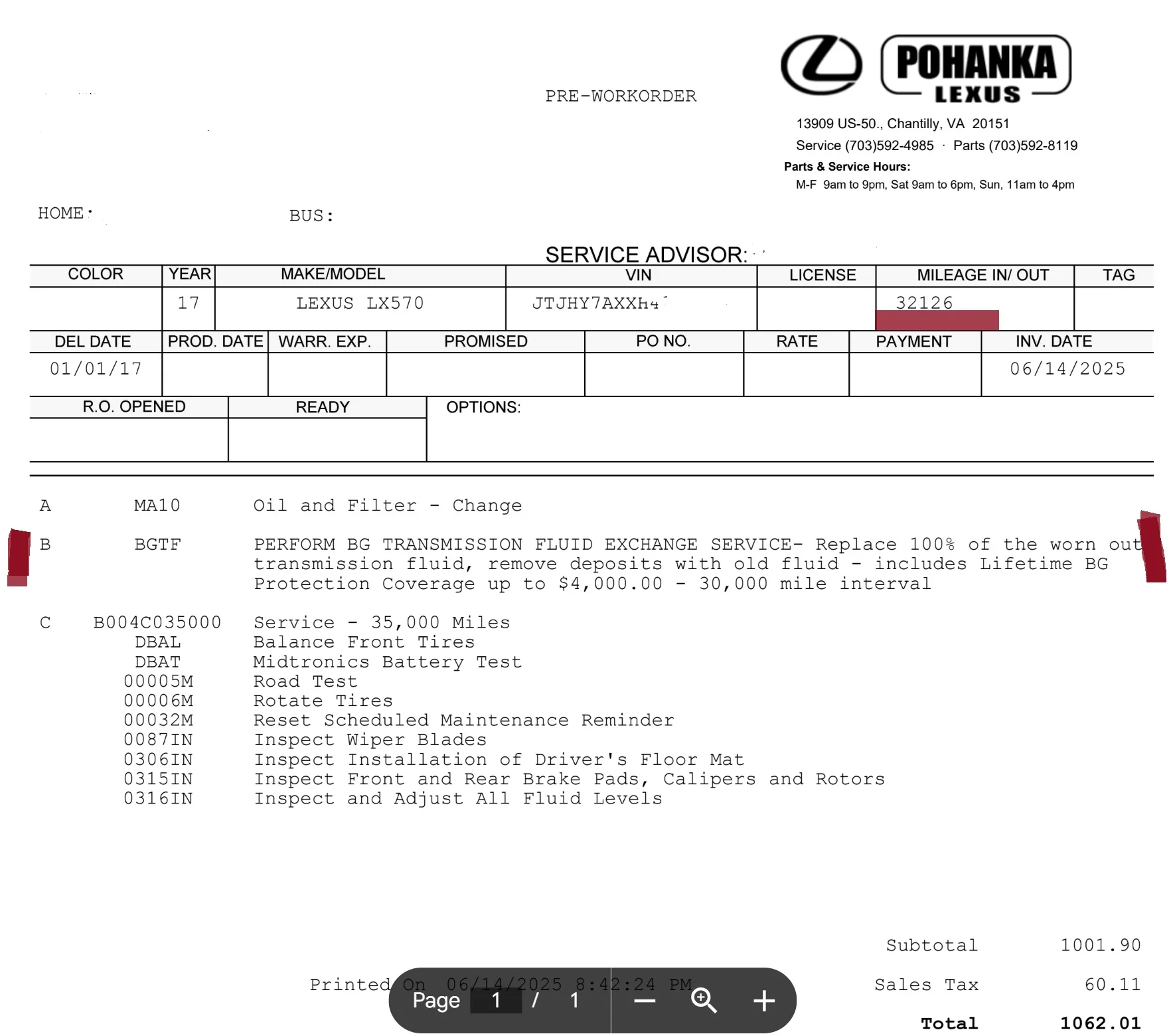

2017 LX570. I was surprised when scheduling my next fluid change the service writer saying Lexus recommended a full trans fluid flush at 30K. I don't see that anywhere online and was wondering if I'm just missing it or what. Any help is appreciated.

Blatant rip-off. :bang:

And look at that cost. No wonder the dealer recommends it.

Use those $4k for better purposes or just donate them to a good cause, seriously that is a much better use for the money.
Come on guys. You may say it's a ripoff but you're probably not seeing that the $1000 total includes the 35,000 mile service at the bottom.
You're basically paying for the driver's floor mat inspection and road test with a free transmission fluid exchange.
I feel like most of that cost is the 4k warranty that’s included in it?

Just wanted to mention that the service writer is a liar and the dealership is engaging in fraud. It was presented to me that full trans flush is standard Lexus recommended service for every LX570 at 30K. 30K is only "reasonable" for extreme use. I have towed a Uhaul utility trailer about 15 miles roundtrip once.
