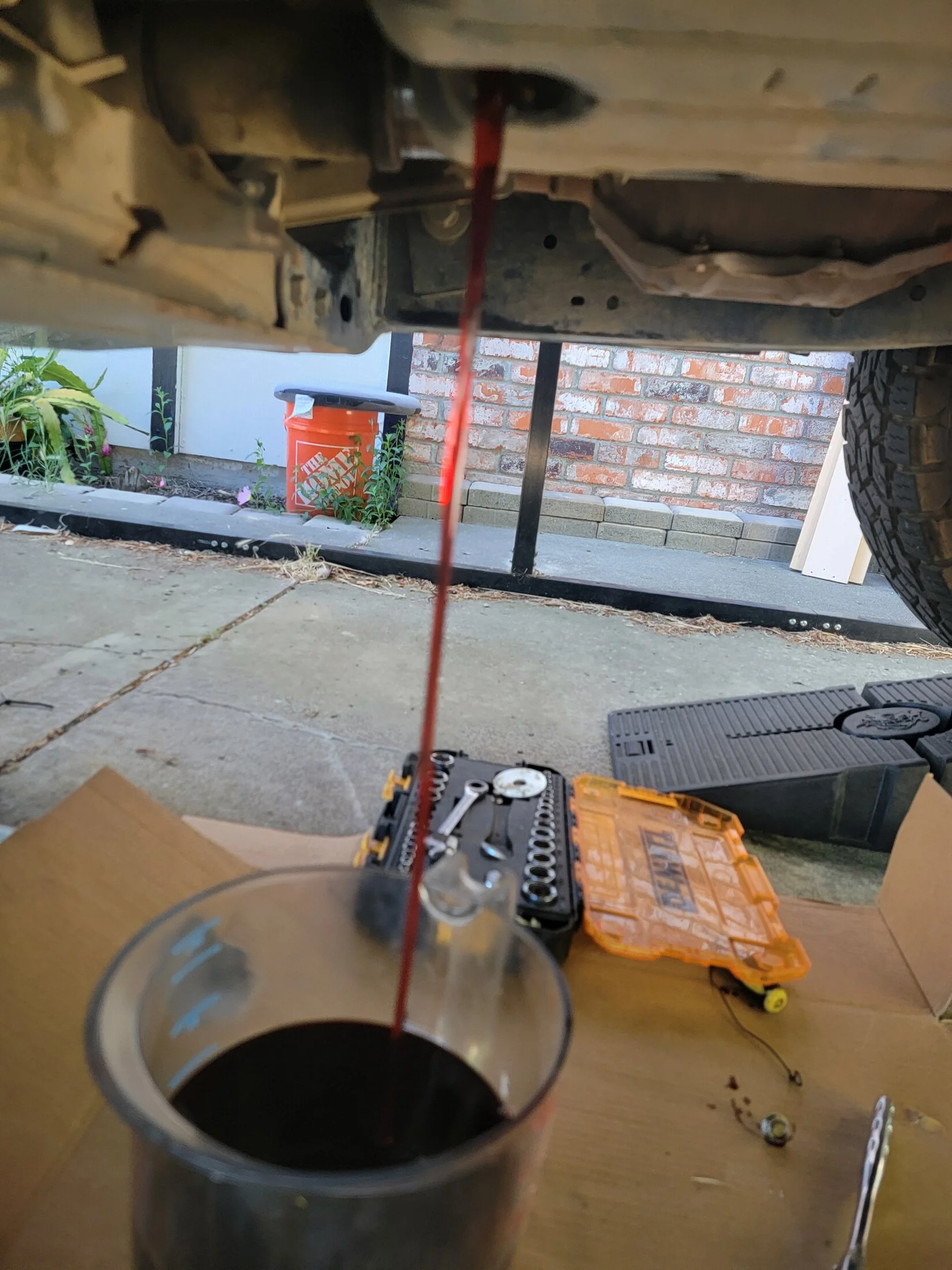

At 130k I did a drain and fill of the pan ( about 4 quarts) and the Amsoil ATF looked just about brand new. Nice and cherry red. I’ll continue with the 30k pan drain and fills as long as the fluid still continues to look good and may even go to 50,000 service internals.

This is after 30,000 miles on the Amsoil SS ATF. Looks like I am dumping nearly brand new fluid.

It's more of a waste of money the more often you do it. You cannot clean contaminated oil by mixing it with clean oil. All you do is contaminate more oil.
