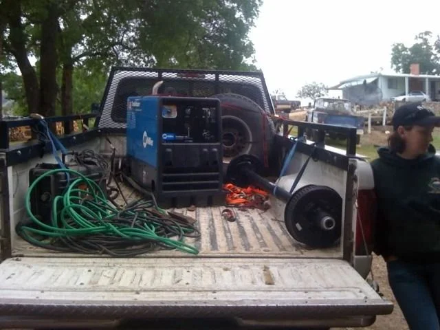

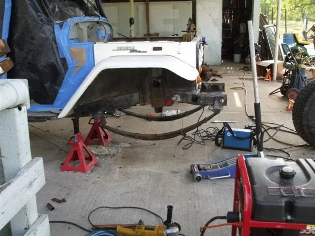

You have a very loaded question there. With a 7000w generator you are limited in what will run on that low of wattage. A small inverter will run fine. However it will only be SMAW (stick), or DC TIG. For example a Miller maxstar 150. (http://www.millerwelds.com/products/stick/maxstar_150_s/) I used to run this set up until I got a engine drive welder with a 11000 w generator. See picture of how my system looked. This little welder will work excellent with the generator you have, but doing thick material will become difficult.

Right now I'm running a Miller 302 engine drive and a Miller 210 mig welder. I also use a extreme 12vs suitcase feeder. The stuff I have is geared to more professional work, but cruiser building can get into professional grade work real fast. Hope this helps you out.

I never ran the Maxstar on 110. But according to my dad a professional welder you don't want to. He said the 110 didn't give as good of an arc characteristic. I welded 3/16 with 1/8" 7018 a lot and it was fine.
Also another dude posted about getting a bobcat. Those are good machines, one step down from what my 2nd picture shows. If you shop craigslist you could find a decent on at a good price. You could also find either an miller extreme suitcase or a Lincoln LN 25 suitcase and be mobile and be able to weld whatever you wanted . All that could most likely be found for under 4 grand.
