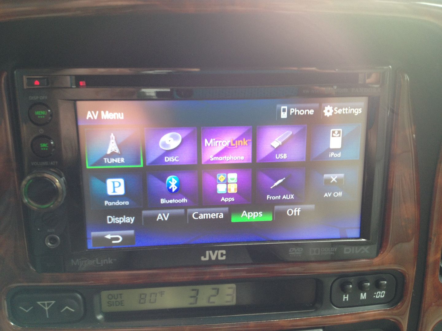

Bought it from Crutchfield. Very inexpensive. Loved it! I ran the micro cable to the top of the windshield (hidden) right next to the rear v mirror. Works great. Instant hookup to iphone via Bluetooth. Can handle different phones plus your contacts go to it. Did the brake bypass so I can play YouTube or movies (I never do) while the car is in motion. The reason I did this is to bypass the need to put the brake on then off and back on to use the video feature. No extra to buy just tie cables. Charges my phone when plugged in to it, always a plus. W the mirror link you can use google maps or whatever for navigation plus the sound comes thru the speakers. It mutes the music with the prompts and then plays again. Only thing I didn't add was the rear view camera, instead I added a Bazooka tube plug and play and it's perfect.
