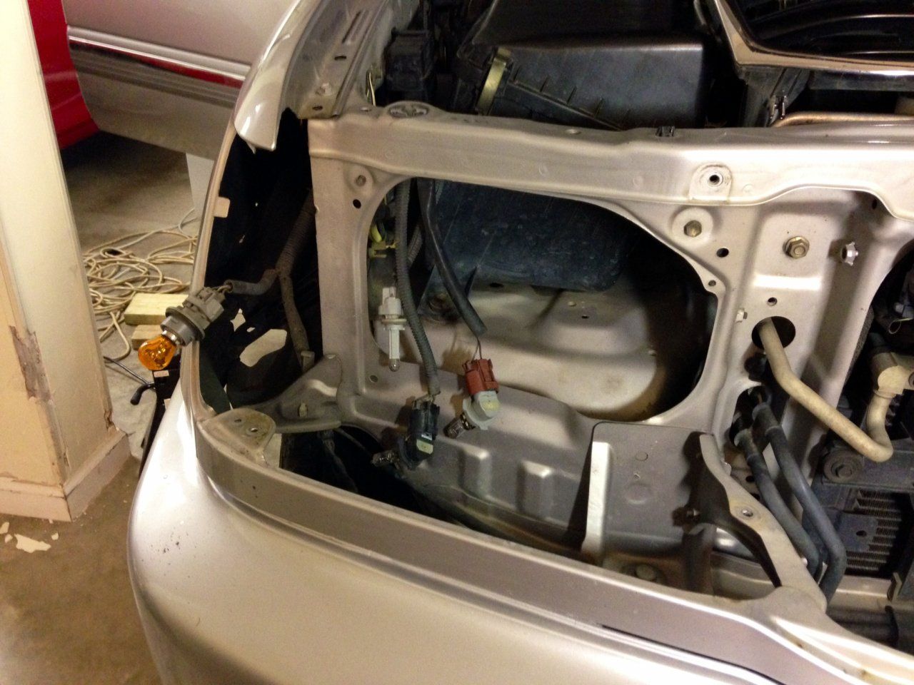

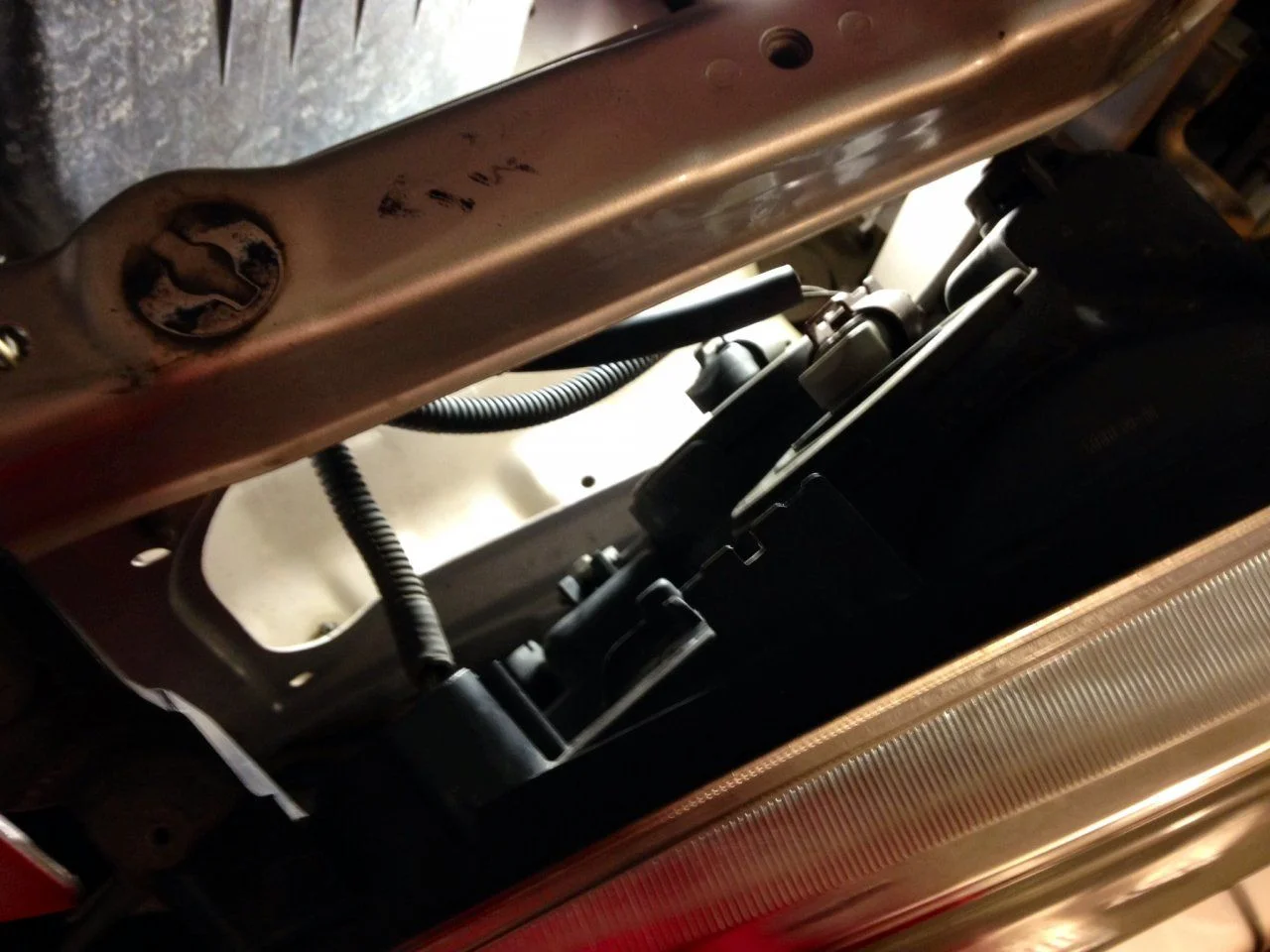

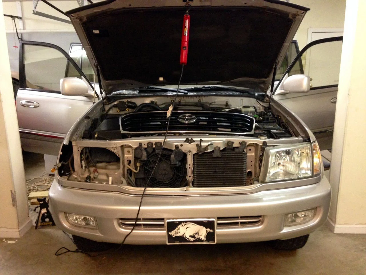

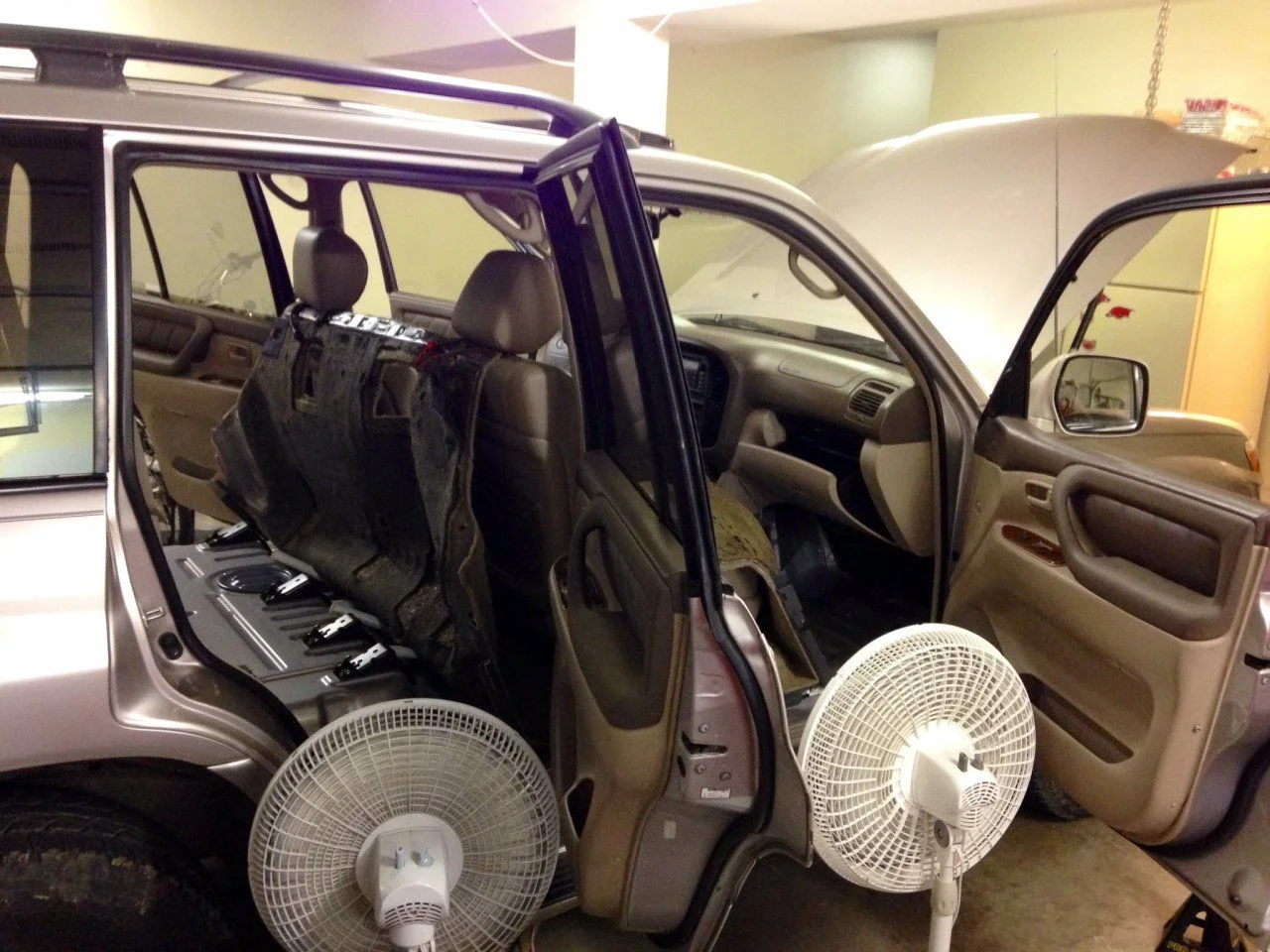

Update: I decided to remove the rear seats which allowed me to pull up the carpet and matting a lot more to let dry. The left side/middle seat combo piece was a :censor: to get out cause it was so heavy. Anyway, I also got the front right headlight and side marker assemblies removed so I can drain and clean the sediment and water out of them. I also figured that while I already had the headlights disassembled I should order a pair of Xentec 6000k HIDs to install since I had the chance. They should arrive around the same time the car is dry enough to reassemble so that should work out great. I'll add more pics when I install the HIDs and when I start reassembling.

Front w:no headlight.webp

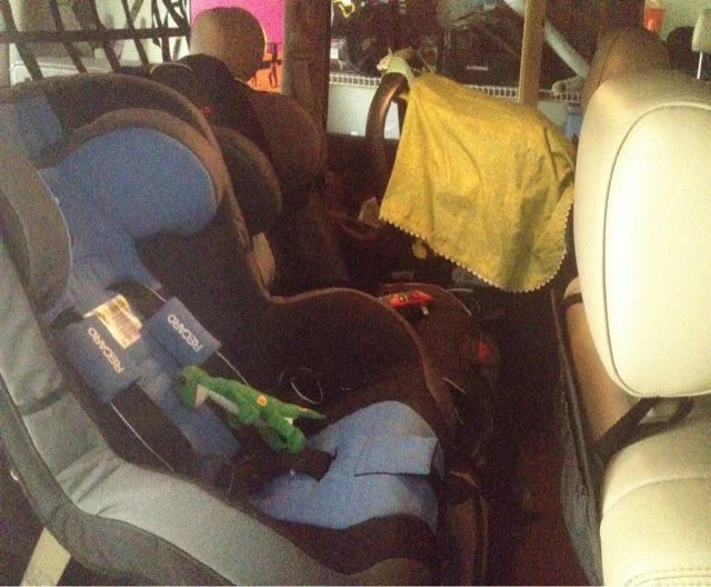

Added the 3rd baby seat. It's almost time!
Sorry for the cell pic...
Update: For those of you who know I sunk my Hundy in the creek a few weeks ago, I finally got to bring her home! Now begins the drying process....
Remove the two front seats - 4 bolts and 1 wire harness connection each. Remove all the carpets from the truck, clean and dry them. You will be much happier with the results. You'll be able to thoroughly dry the interior this way and now's a good time to run any electrical to the rear for accessories.
I agree with robred
When i sunk mine, THAT NIGHT i had the interior completely ripped out and vacuumed. I left the truck idling for 6hrs straight with the AC on and heater full blast not on recirc mode. It got EXTRA toasty and dry in there. That was only to dry out the electronics. The mat got a total shampoo and was left to dry in the tx sun for 3 days. That was 2 years ago, no problems since.

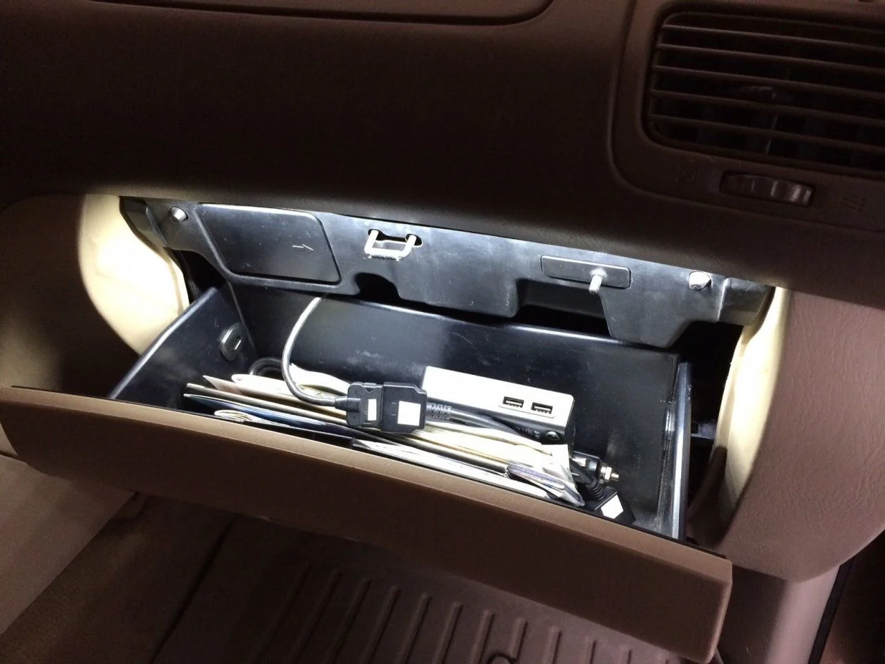

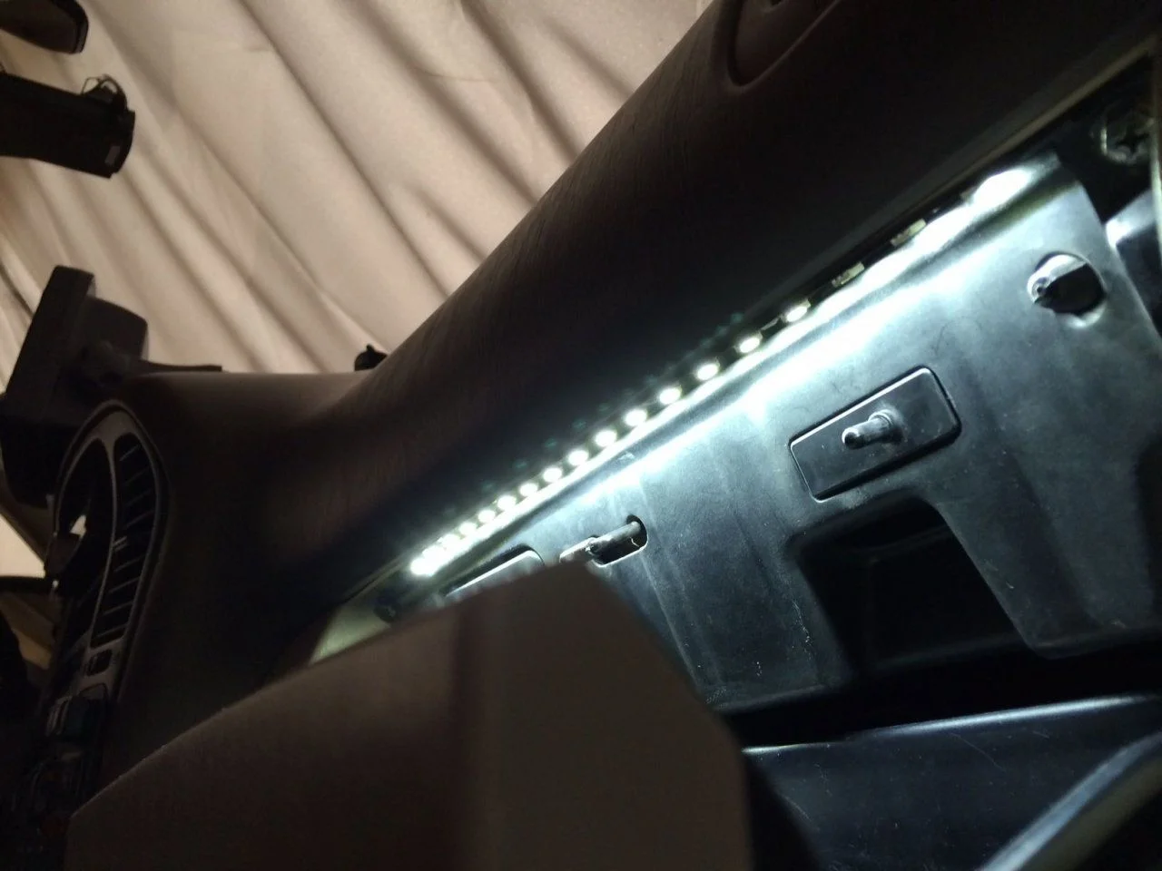

Did this a couple months ago...but now it's thoroughly field tested :D Was tired of the anemic glove box illumination from Mr. T. Tried a couple different LED bulbs but not much better really. So finally put a strip in and voila: No more illumination problem for the glove box.

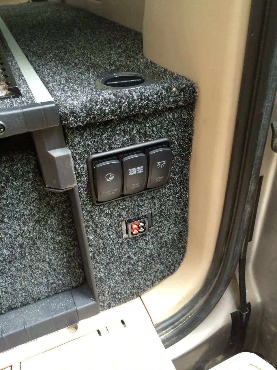

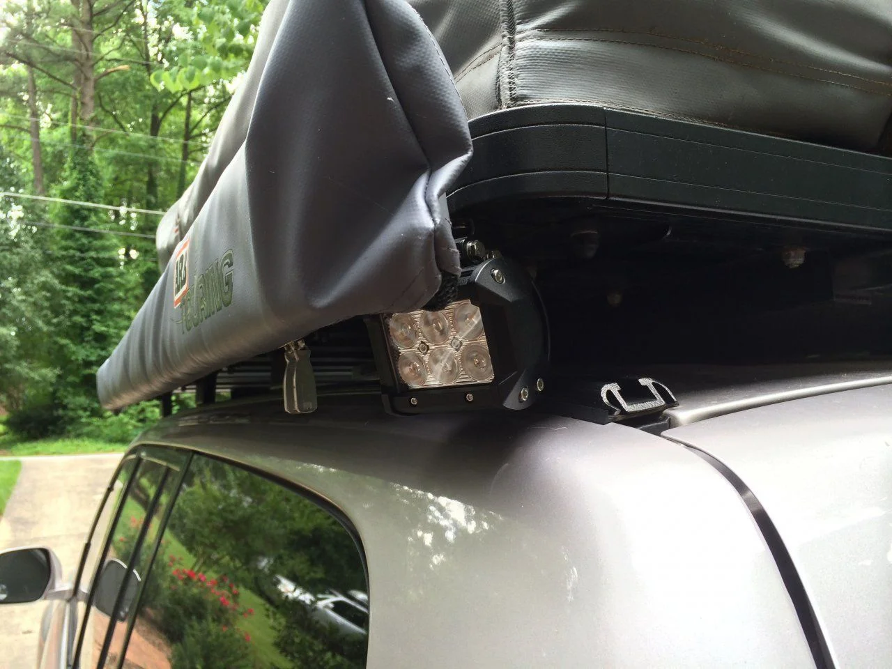

Final touches of electrical work before our big trip out west!
Camp lights for the perimeter:
Work lights mounted on swing out highlighting the rear deck, drawers and ground.
Switches mounted at the Rear. (Thanks to the Forum and OTTRATW for these babies!)

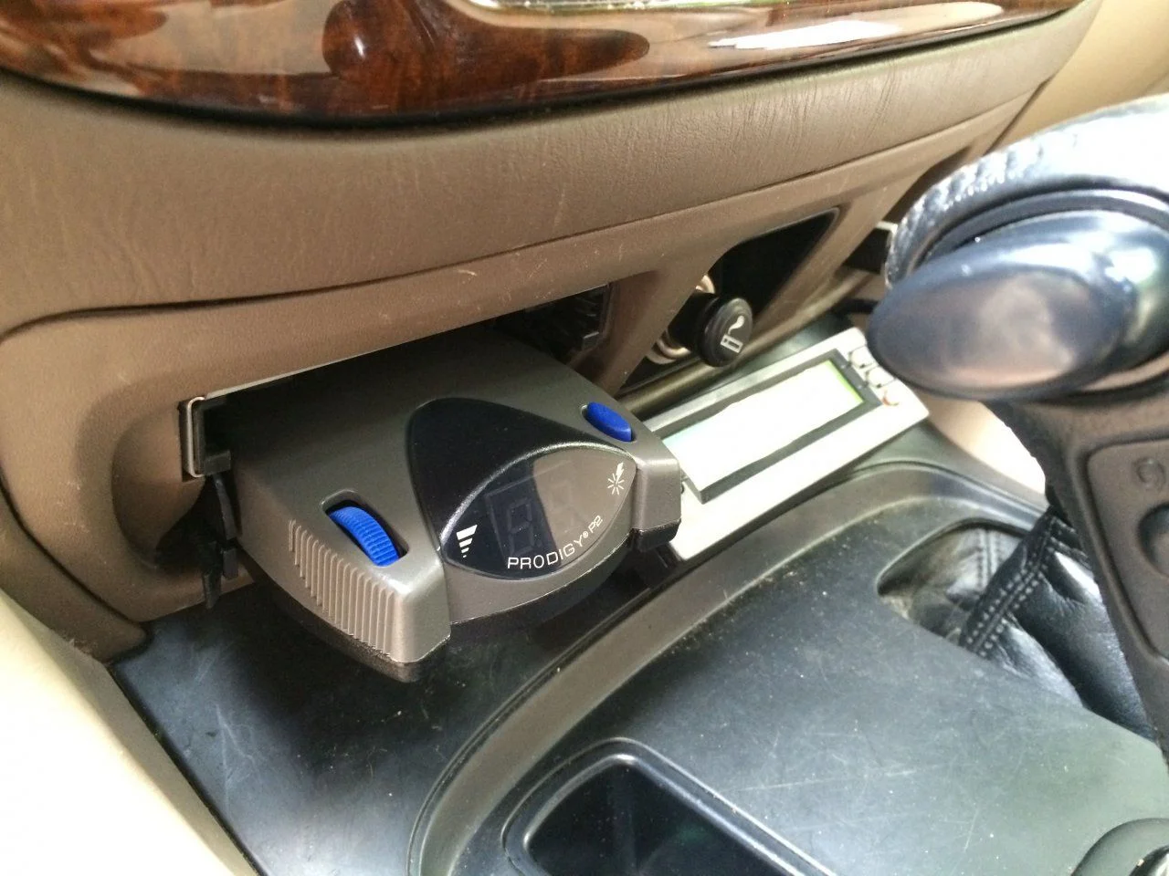

And finally, the brake controller for the Chaser... many folks highly recommended having this for the big hills out west and for modulating terrain off-road.

Nice switches cboyd.
What's behind that panel?
There is nothing behind that panel normally, but now there is a fuse panel distribution block, manual isolator switch and some relays.
There will also be a Kenwood D710 HAM radio mounted back there, but I just didn't get to it yet...
The distribution panel connects with #4 wire with fuse protection (50A both ends of the run) to the the dual battery under the hood.
Using the power pole connectors I can input for charging (solar or AC trickle) or offload power at 30A to external inverter, trailer, accessories, etc.
View attachment 906256 View attachment 906257
Please post up what you used that is fantastic!
