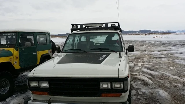

Crick60 we run very tight technical trails and the led bars are great for them. Even the spot pattern has a ton of bleed and acts like a flood. For high speed desert they aren't perfect but a good all around light.
I do like the arb led spot lights. So bright they killed a vampire.

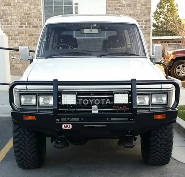

I used to have a $100 set of hella lights that were marginally better than my headlights. Then I found a sale on some off brand light bars and got a 12" spot bar and two pods in flood for under $200 (I think). They blew away my Hella's so much that I pulled them and pretty much gave them away to a friend.
To OP, I don't have a 40" bar, but here's an example of how I mounted mine.

Also re the OP question I'd stay away from roof mounting unless you can control the spill and glare on your bonnet/hood.
This is really good info, much appreciated. I picked it up for cheap and one of the photos in the comments showed a decent flood type light pattern which is good in my opinion. I'll probably mock something up This weekend.
I think I might go bumper /frame mounted, unless I make my roof rack. I don't really want to drill into the roof ya know
I would try and go as low as possible or as far back on the roof to where it doesn't light up the hood when mounting a light bar unless it's a spot only set up. While light bars are pretty amazing and look really good, I find it kind of annoying on the roof. My eyes have to readjust when it lights up my normally dark hood. Not to mention they are terrible in fog, snow, dust, and rain. It does look cool though.

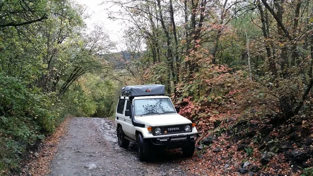

I like it better down low. It's for extra lighting as it's a spot/flood combo light
