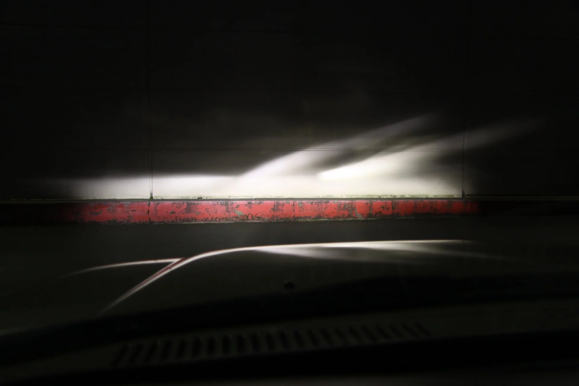

Here are Leppein H4 LEDs in my Depo housings, from 2/2020. 1/6 sec at f/4.0, ISO 400:
Here are the same Leppein H4 headlights on high beam, same camera settings:
I don't know what's going on with the beam pattern in your thread. I saw that earlier, and I assumed you were using the high beam, or poorly made and/or incorrectly rotated bulbs.
For some reason, I don't seem to have any output photos from the Depos with halogen bulbs, although I could swear I took them. The pattern was somewhat clearer with the halogens. The Leppeins were close to an H4 filament's output position, but definitely imperfect, as seen with the poor lower, right light output.

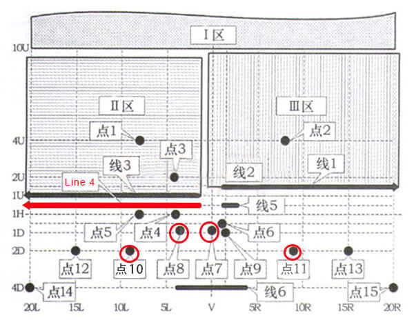

This page has some good details about the difference between different lighting standards:
ECE:
DOT/SAE:
ECE:
DOT/SAE:

That output looks so much better than any of the LED bulbs I tried in the Depo housings.

Would you happen to have a reference of your light output with this setup? Curious as I want more lighting, but not at the expense of oncoming traffic
Did you rotate the bulbs after installing them into the housings?
Just search for Leppein on Amazon. I don't recommend them because they started failing (flickering) after around six months.
Yes. The bulbs I settled with are adjustable and position "6" produced the best pattern. There was still no defined cutoff.
