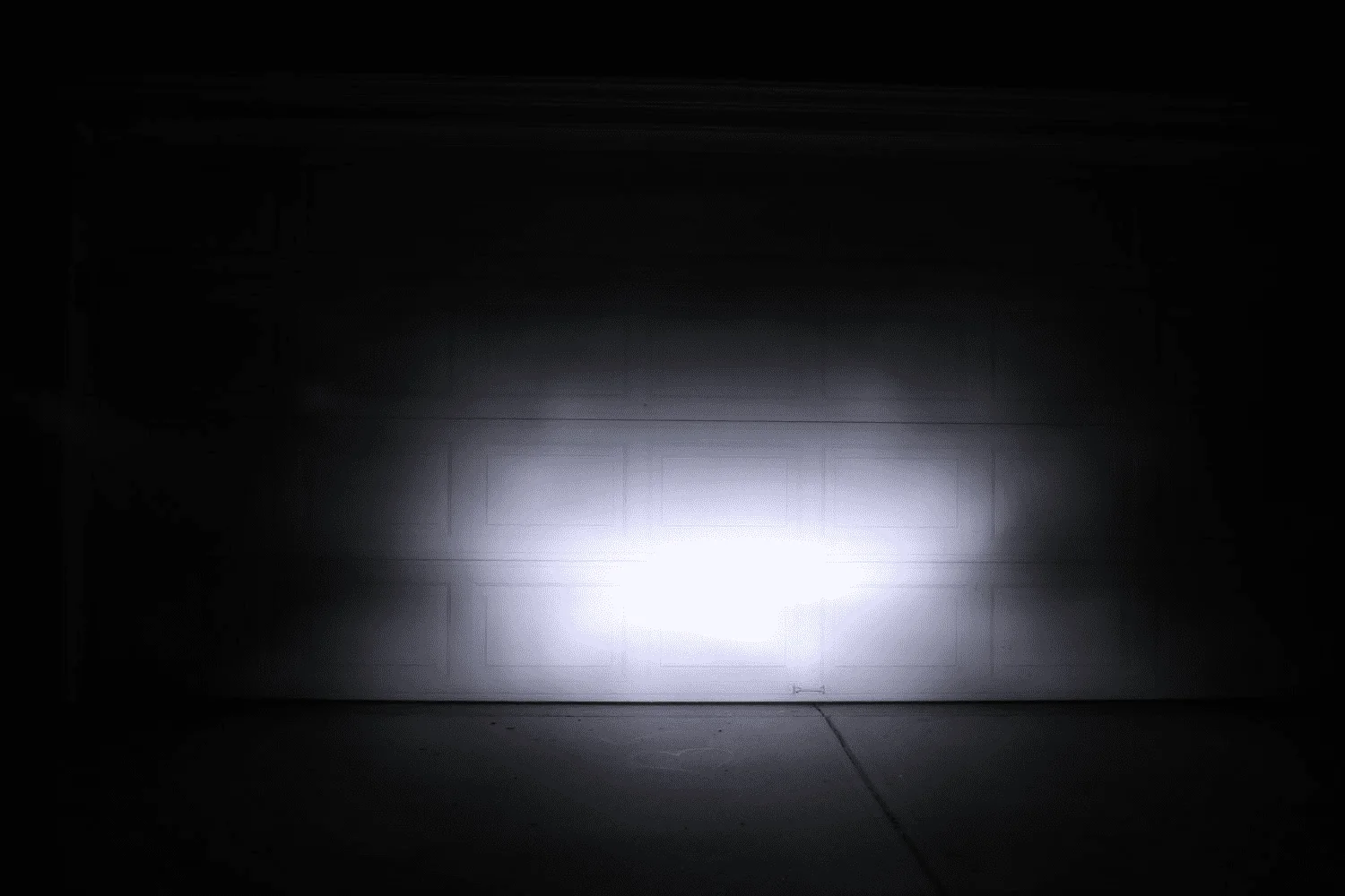

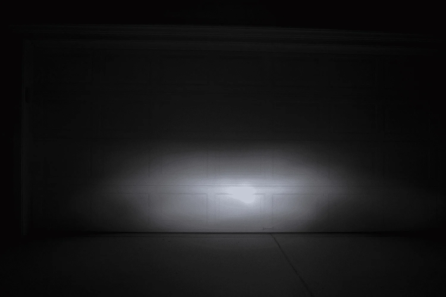

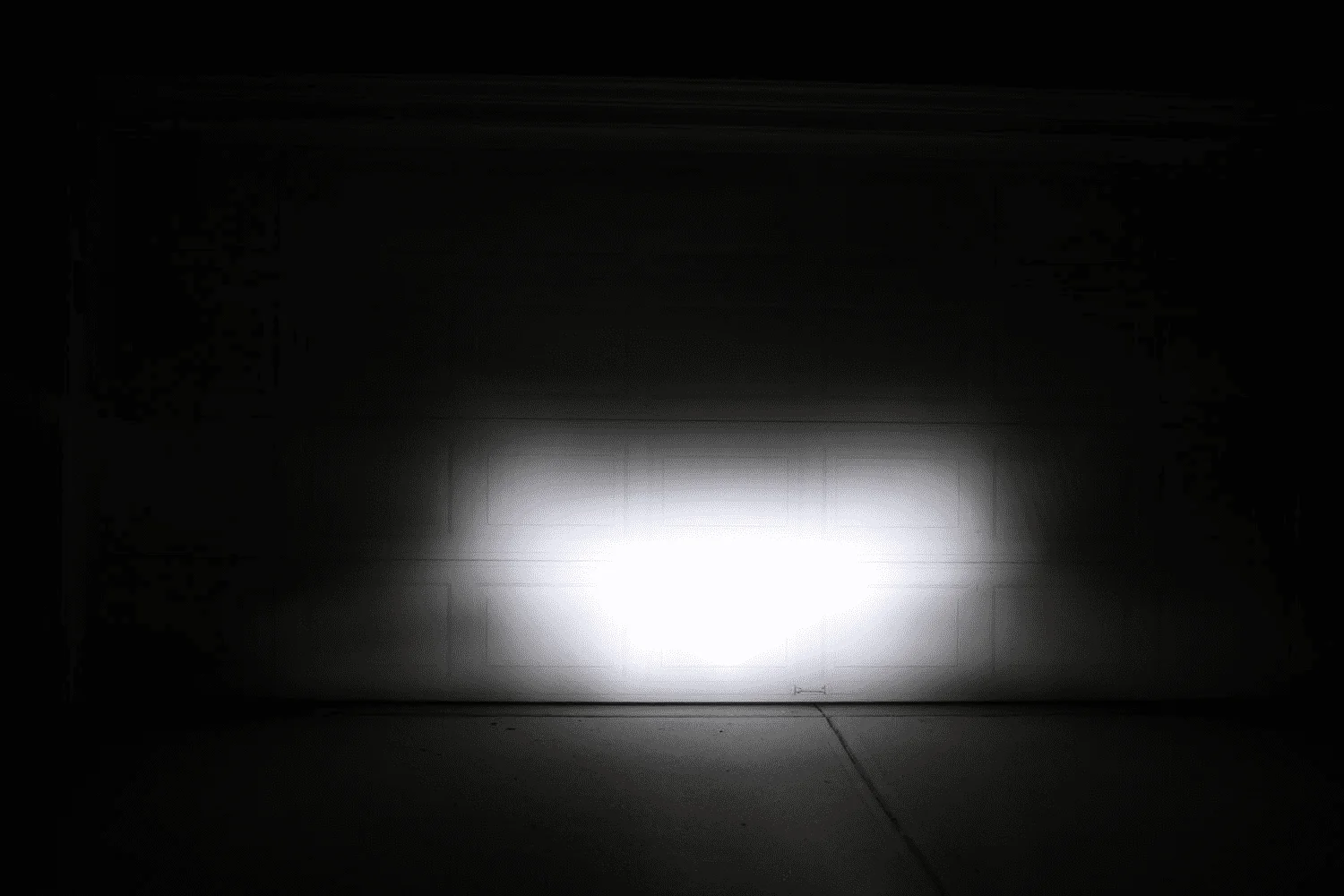

I took a few test shots to make the photo on the camera image preview match what I was seeing in both color and output. Only one bulb is actually on during the test. No other lights were present including the moon. Garage to front of headlight was 17 feet (best I could do). Garage is a paneled garage door (again sorry).
4 LED bulbs with links to each.

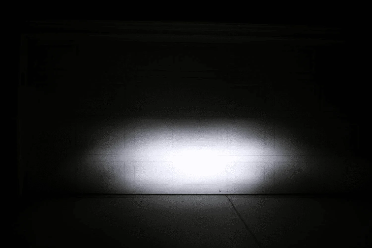

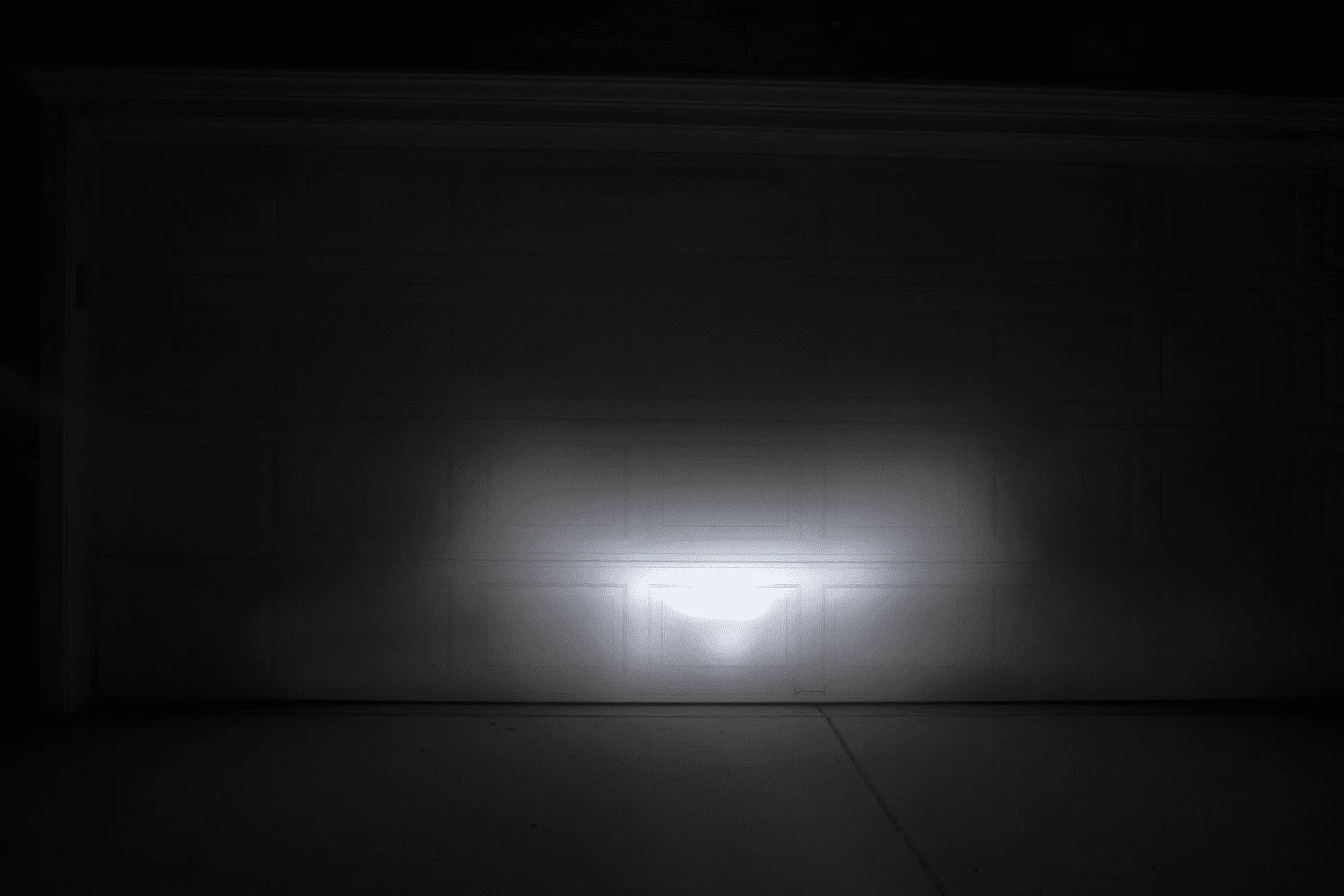

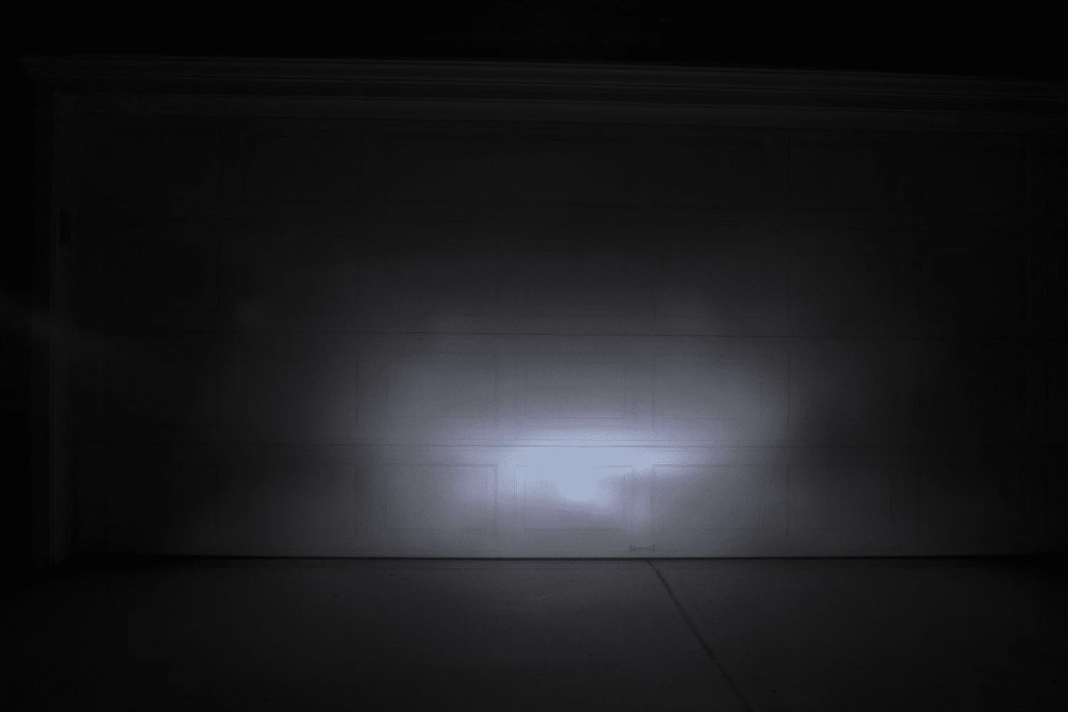

Photos were necessary to gauge how much light spill was present above the cutoff. The cutoff with all of these bulbs was a mess but there were some surprises.
BEAMTECH H4 LED Headlight Bulb, 50W 6500K 8000Lumens Extremely Brigh (9003 Hi/Lo) CSP Chips Conversion Kit
$38.99
Exposure -2.0. Contrast -100
AUXITO H4 9003 LED Headlight Bulbs, 12000LM Per Set 6500K Xenon White for High and Low Beam Hi/Lo Plug and Play, Pack of 2
$49.99

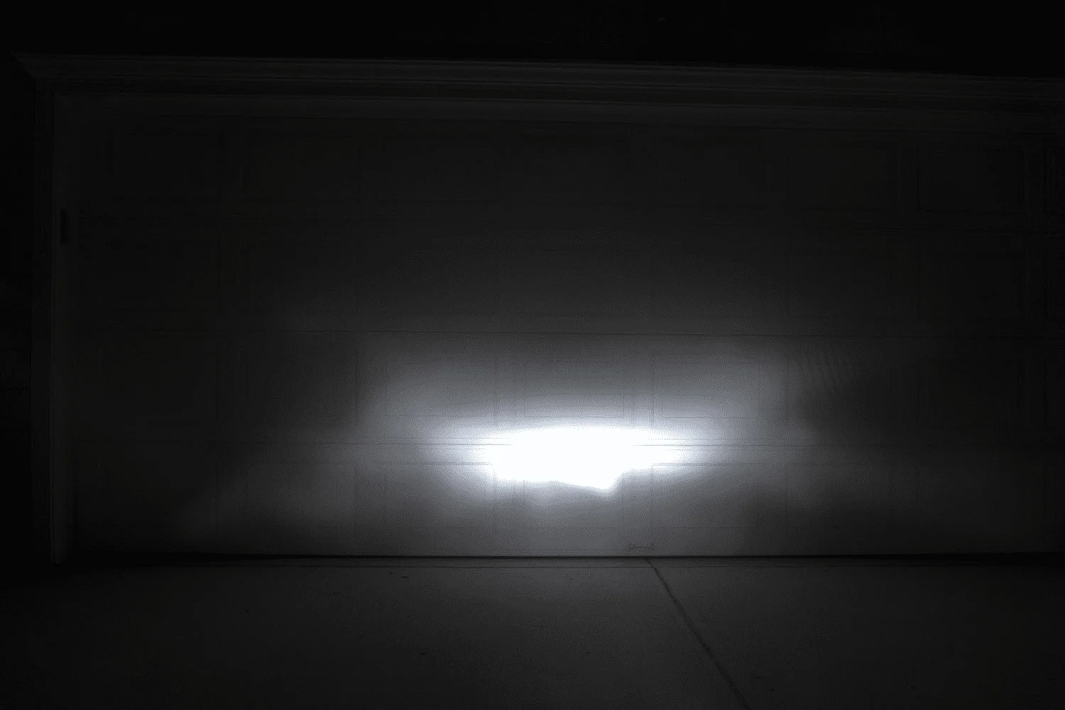

Bevinsee H4 9003 LED Headlight 60W 10000LM 6000K White Bulbs Kit,2pcs
$21.77

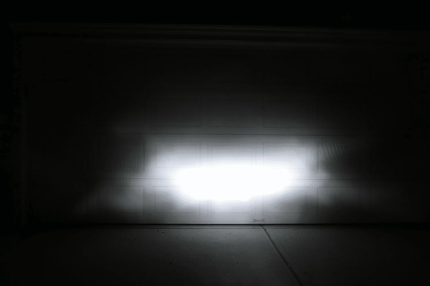

AUXITO H4 9003 LED Headlight Bulb Fanless 9000 Lumens Adjustable Beam 6500K Xenon White High Low Beam HB2 Conversion Kit Pack of 2
$39.99
Full rotation. This bulb is adjustable unlike the rest. There are approximately 8 to 9 settings.
Same as above but rotated to notch 6.

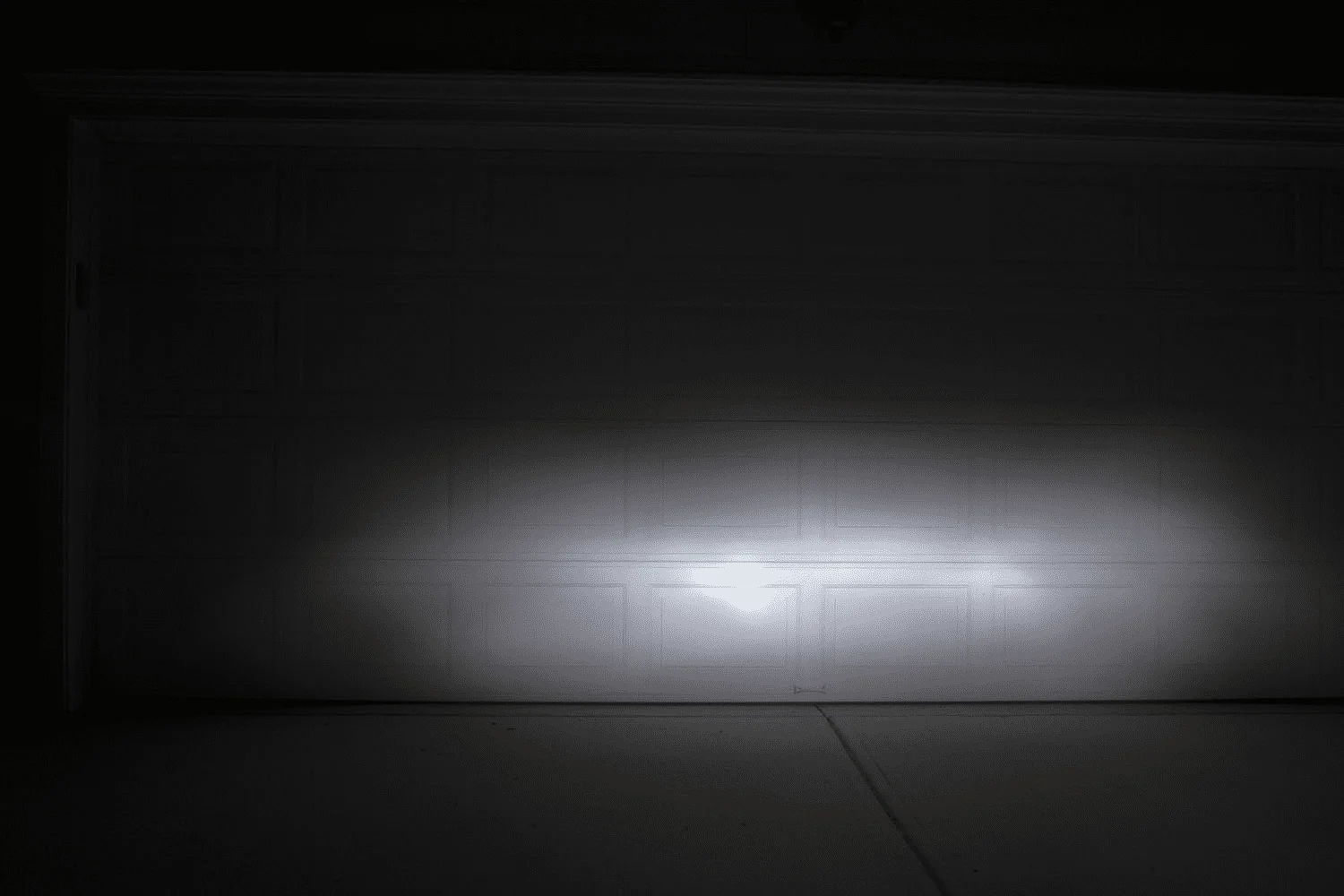

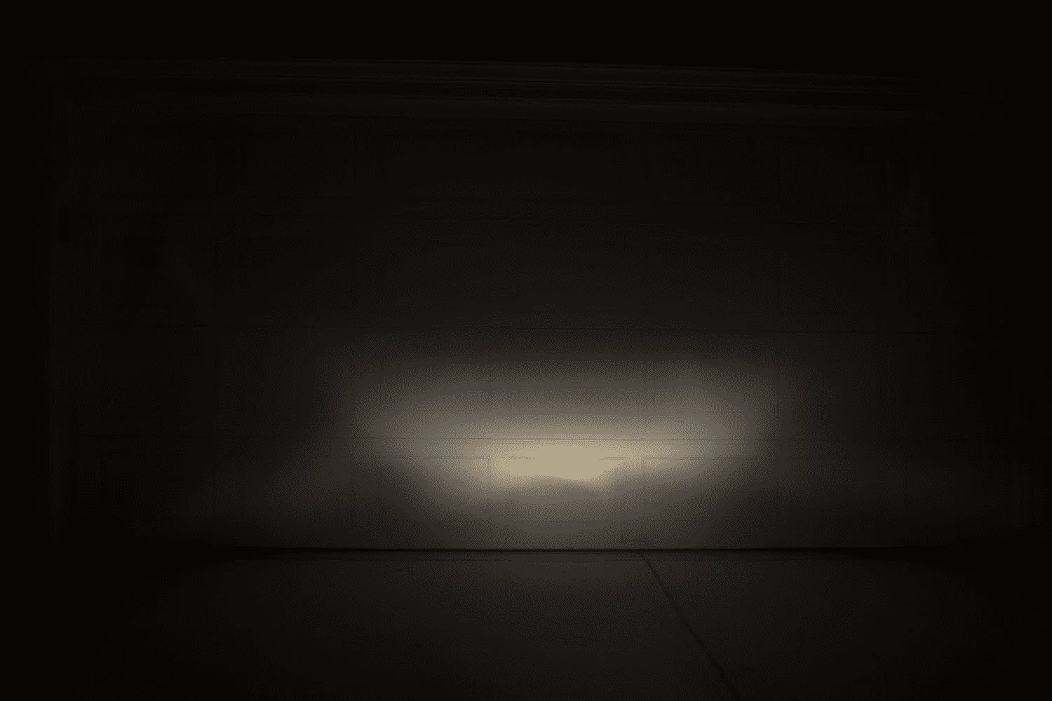

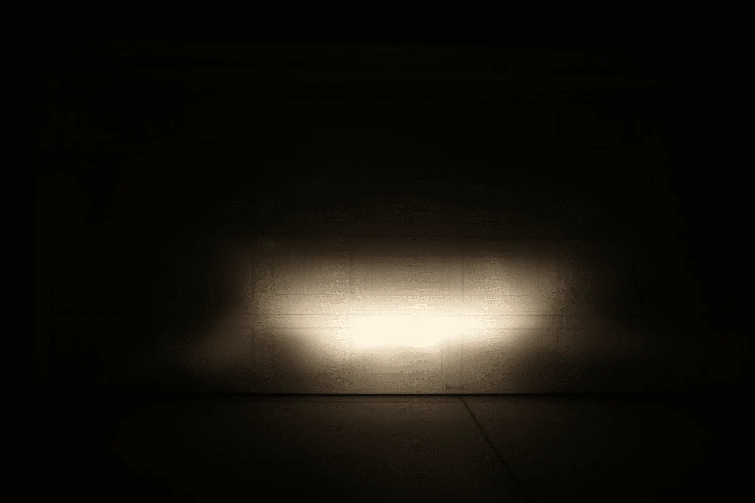

For comparison, I purchased these.
Philips X-treme Vision +130% Headlight Bulbs (Pack of 2) (H4 60/55W)
$18.00

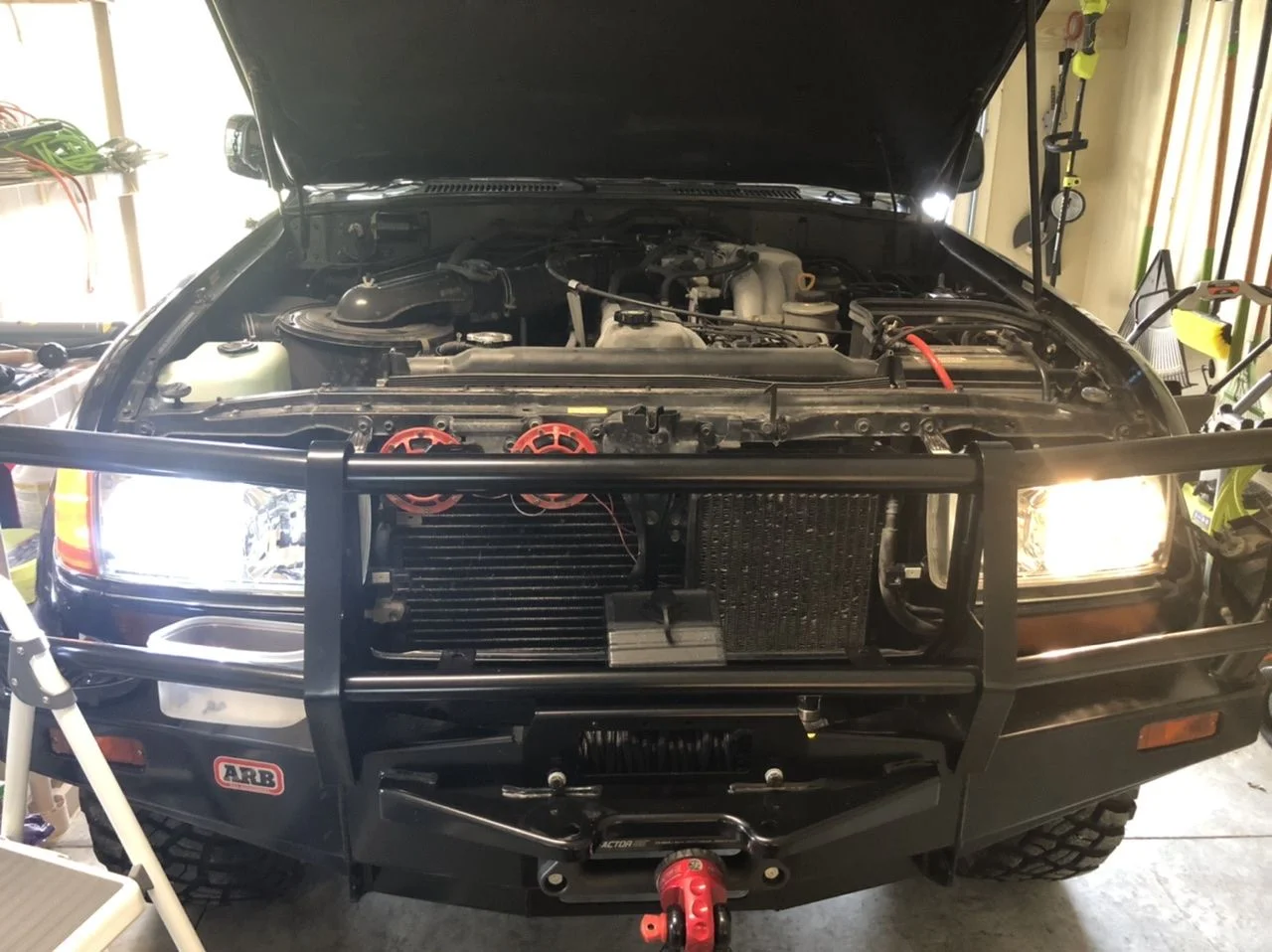

AUXITO H4 9003 LED Headlight Bulb Fanless 9000 Lumens Adjustable Beam 6500K in both driver and passenger side headlight assemblies.

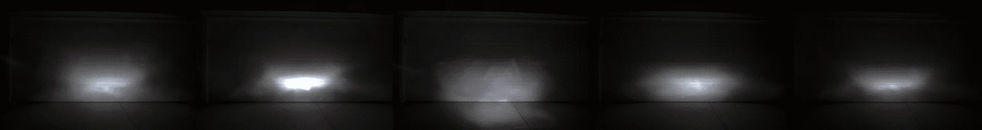

The full lineup in the same order as above.

  • The Beamtech was a non-adjustable LED bulb with a removeable collar and a large heatsink for passive cooling. The light pattern was controlled unlike the Bevinsee but was tall and narrow with lots of spill.
  • The non-adjustable Auxito looked promising. I drove with this bulb to dinner one night and was surprised to be able to see the light from the LED on the ground. The hot spot is super bright but the output is strange. The cutoff is actually at the bottom and quite jagged with scattered light above. Driving with this light I noticed spill on the back of cars which I didn't like. This is also a VERY old design with poor construction to match but it did better than Beamtech and Bevinsee.
  • The Bevinsee was just a mess. I'm not a fan of active cooling due it being one more component that can wear out and the Land Cruisers in general are subject to pretty extreme conditions. The fan on one sample was not balanced and I could feel vibrations through the fender.
  • The adjustable Auxito was a nice surprise. It was the last light to be installed and actually shocked me how smooth and controlled the light output was. The removeable collar made installation easy and the passive heatsink might be the largest of the bunch. I didn't think the adjustment would make much of a difference but again I was surprised as I rotated the bulb and the output went from tall and narrow to thin and wide with a better hotspot. Projector quality? Helllll no but better than the four other options.
  • Halogen. I have nothing nice to say about these. Short life, brown light, dimm, and runs very hot. There's no additional wires and so installation is easy but don't touch the bulb.
Subjective ranking:
  1. Auxito adjustable (by a FAR margin)
  2. Auxito non-adjustable (probably a short life LED that has to be aimed further down)
  3. Beamtech
  4. Halogen
  5. Bevinsee
I am actually a bit disappointed in my photos. It doesn't capture the real life in person experience of each LED. The difference between halogen and really any of the LED's is drastic in both terms of color and output but the photos don't show that. The light spill from the Beamtech is much higher than what is captured in the photo. The non-adjustable Auxito hot spot is not that bright and the light output was like a crown with strong light at the bottom but fingers that rose up. I'm pretty happy with the adjustable Auxito bulbs but will continue to watch the H4 market for new contenders.
Would a pair of $180 LED bulbs have been that much better than the samples I reviewed? Nope. LED location on the PCB is hyper critical. A 2 or 3mm difference in the fore or aft location of the LED's makes the light output jump from a narrow spot to a giant circle. The big contenders like GTR ($180) use the same LED's and quality control is better but once the light leaves the chips, it's up to the reflector to focus the light out the front. In all honesty, the GTR could look like the Bevinsee sample above.
I hope this information helps and would love to see someone else step up with recommendations for H4 LED bulbs for the Depo headlight assemblies. Last step for me is to adjust the height of the light output on the Auxitos to find the balance between viewing distance and blinding oncoming drivers.

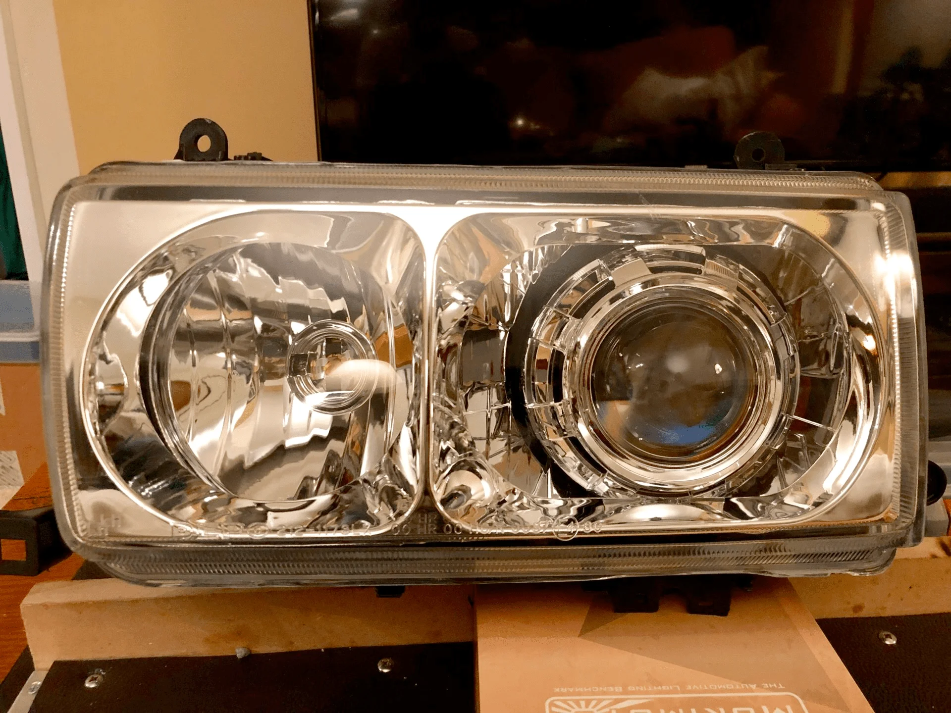

I know some of the higher end LED's are adjustable but I haven't experienced a set to date that work in a reflector without blinding on coming traffic. I hope you find the proper setup. Have you considered retrofitting an HID projector in the DEPO housing? It's a simple retrofit and the output in outstanding.

A projector conversion is $300 to $400 while drop in LED's are $38.99. Eventually I will gut my Depos and install projectors but dual battery, radiator, Depo headlight assemblies, and Depo corner lights ate up my budget for the rest of the year.

What did you do for the rubber boots around the headlight housing and bulbs? I was hoping the LEDs would split at the heat sink so I could slip the boot over, but short of potentially breaking it, I don’t see how?
EDIT: Disregard, I’m a klutz. Here I am trying to separate when they TWIST:rofl:

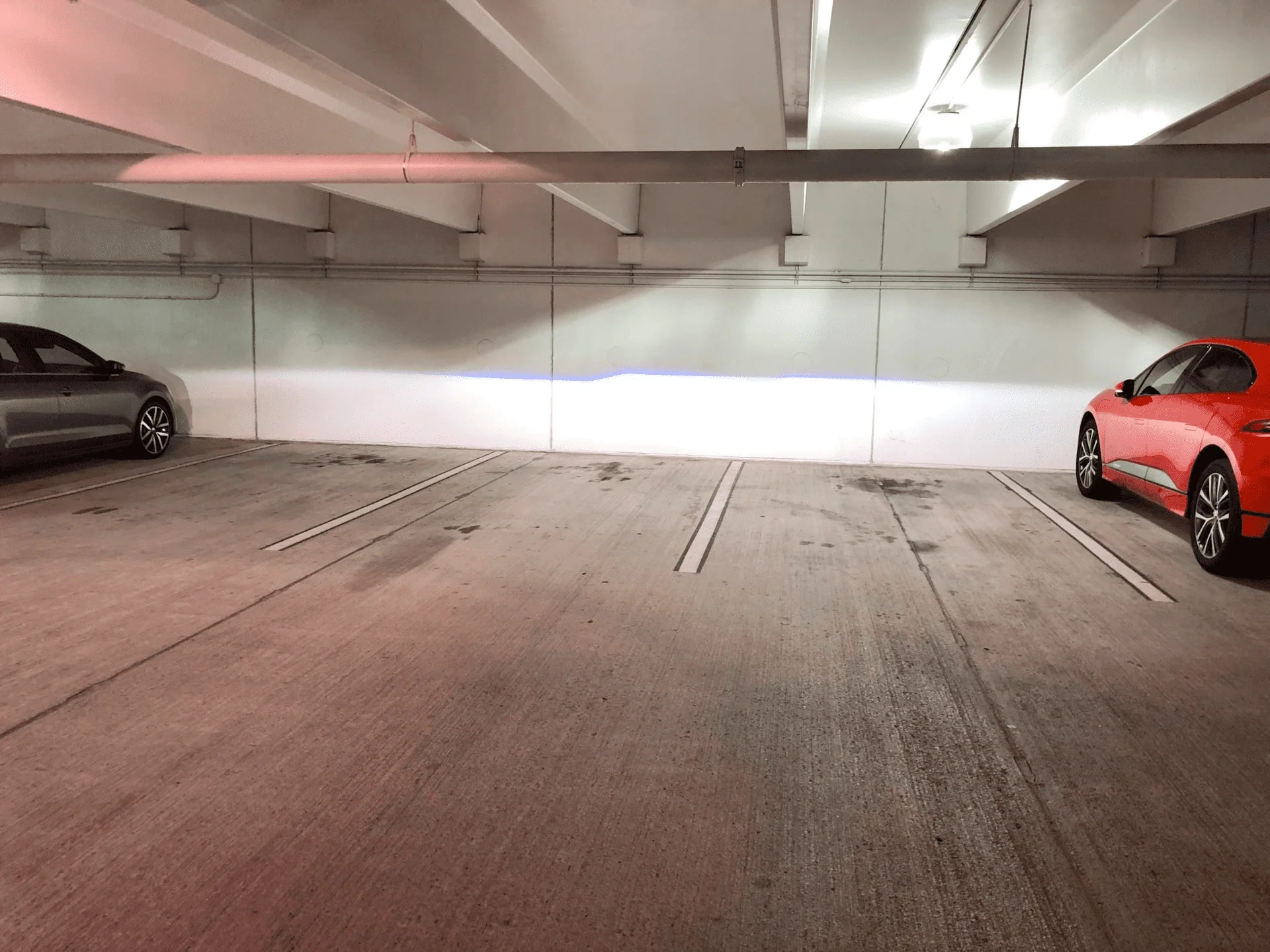

Also, new Silverstars in driver’s and Auxito adjustable in passenger...
