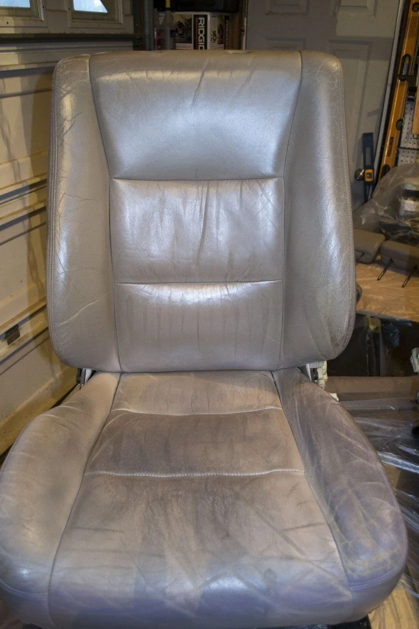

Initial results were awesome, and for the most part, it seems to be holding up really well. In the first pic, you can see my DS bolster is really worn..both the foam and the leather. I attempted to smooth out some of the creases with the crack filler before I re-dyed, and the dye has started to crumble off there. Specifically, in the creases. To really fix that area, I should have replaced the foam, reinforced the leather there by gluing a piece thick suede to the underside and not used the crack filler there. Leatherique also makes a clear coat for high-wear areas. I'll try that when I touch it up.

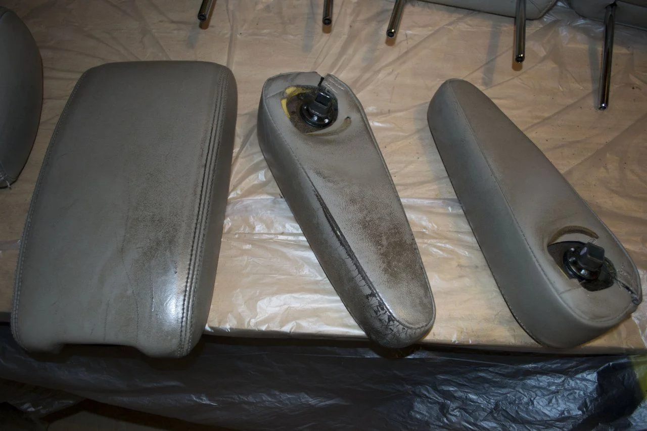

If you zoom in on pic 2, the center console had some deep scratches and the armrest was in rough shape. Those "cracks" are what the crack filler is intended for and they are still perfect, but also not as high-wear as the bolster. I also had a few spots on the rear seats where I used the crack filler where it's still invisible and no issues with the dye adhering.
For the first week or so, the seats had a rubbery feel, but that has since gone away. So I think extending the time between the re-dye and using them will increase durability by allowing more cure time.
I'm very happy with my results, and I made a bunch of little mistakes along the way. The main one being not taking advantage of their color-matching. That would have made for a lot less work.

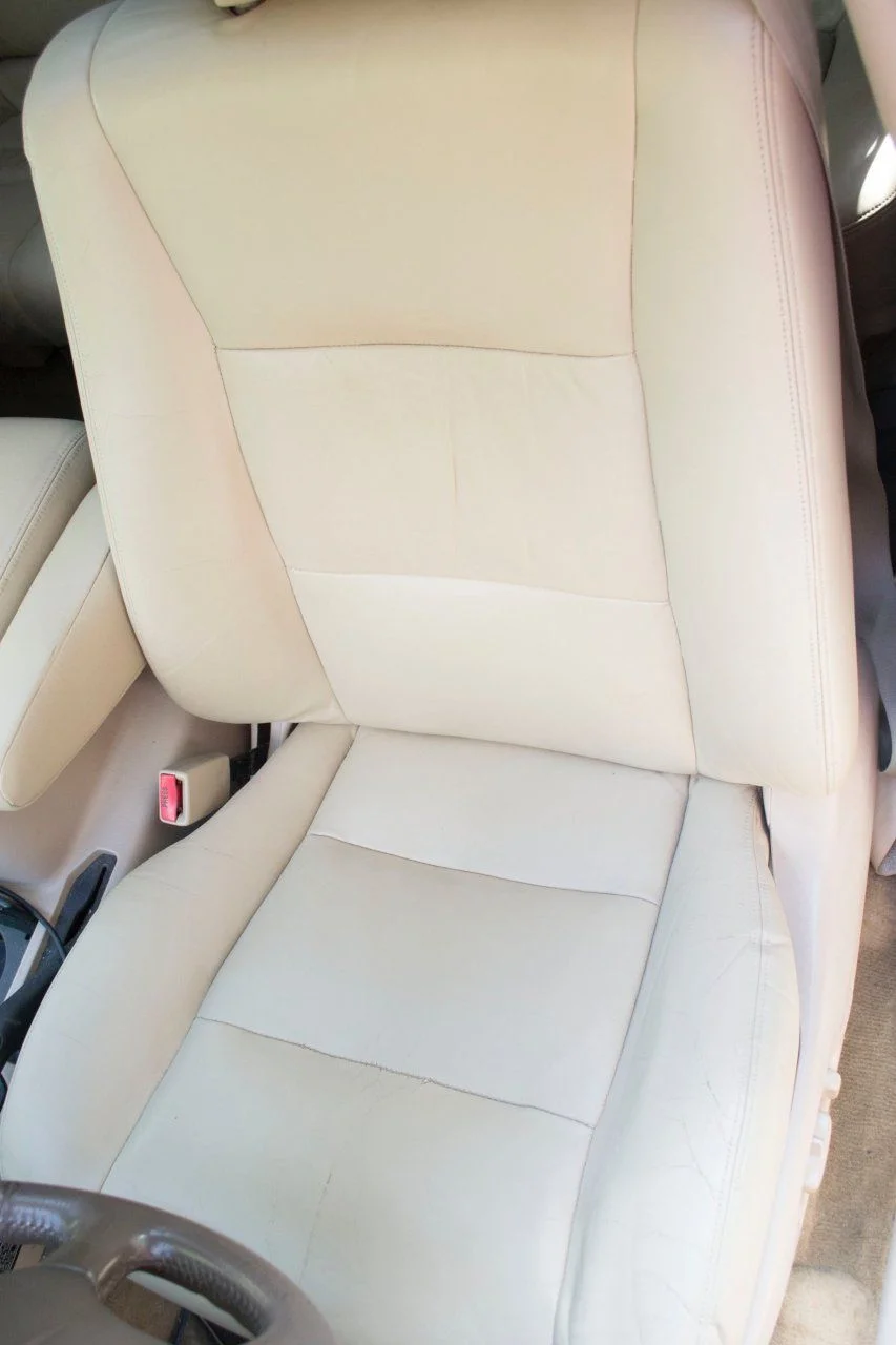

Here is what the DS seat looks like 3 months later:
Again, I believe it was more user error than product.

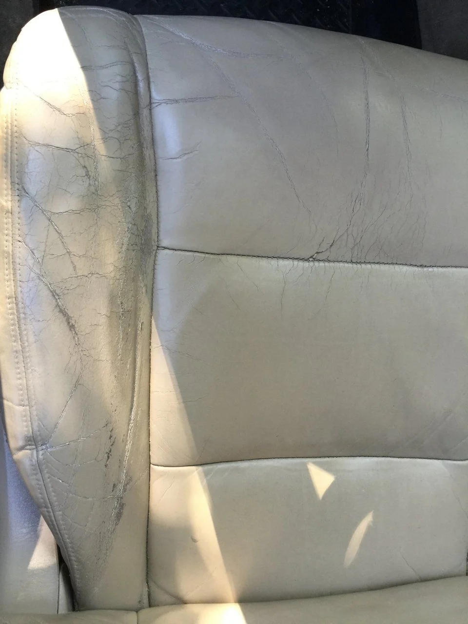

I assuming all the darkest spot/cracks that we now see are where you used the filler? I also see some fading/wearing off of dye in lower center of back area, that I assume only die was used here (no filler)?

...I assuming all the darkest spot/cracks that we now see are where you used the filler? I also see some fading/wearing off of dye in lower center of back area, that I assume only die was used here (no filler)?
Photo above is the seat bottom. "lower center of back area" is not fading/wearing, but no crack filler was used on it either.
