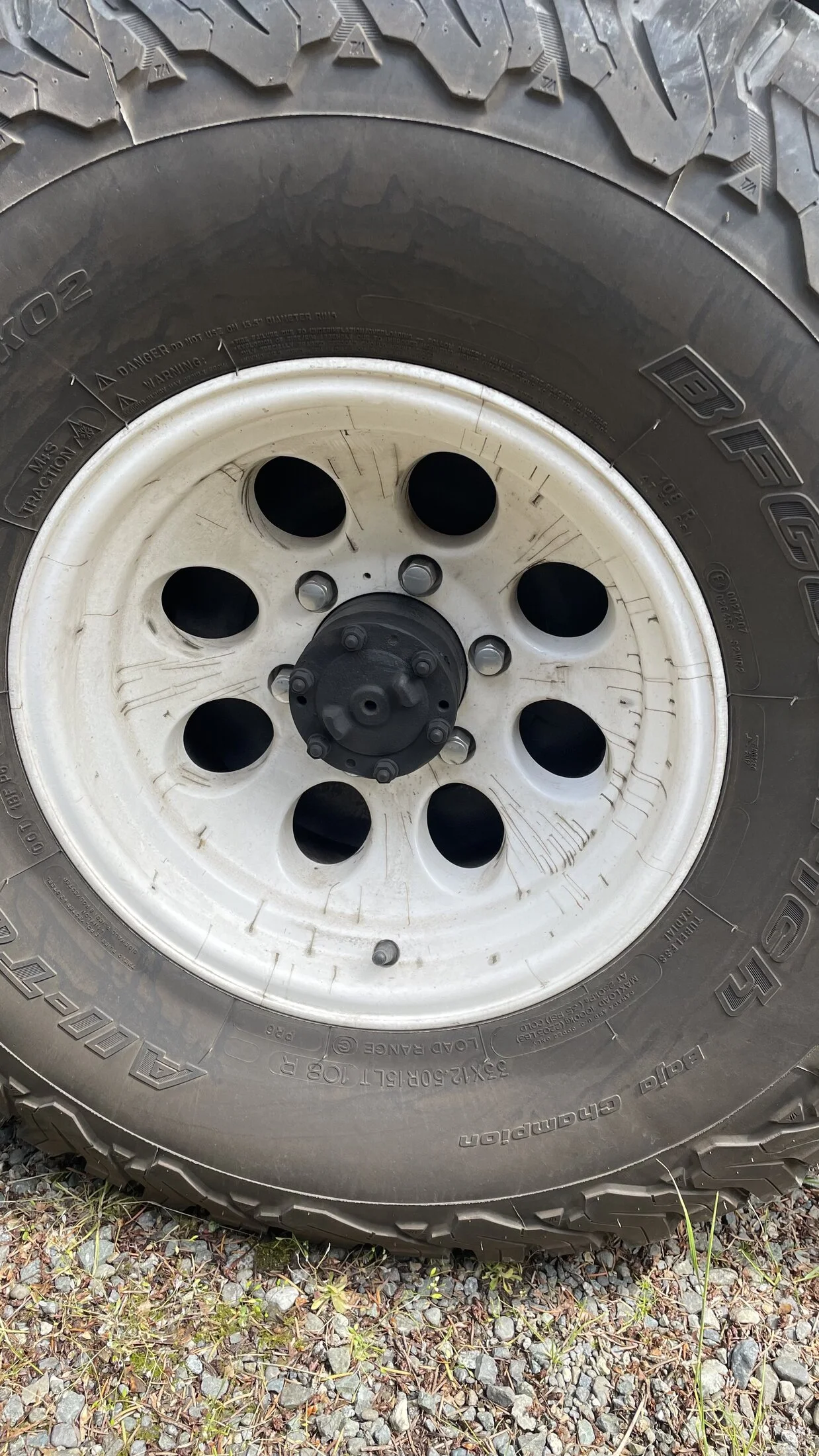

Hi Folks,
Just acquired an '85 BJ60 a few weeks ago and have put on ~1,500 km getting it home. Mechanically everything seems very good but I've noticed that the hubs are leaking grease (back hubs are full float). The strange thing is that is is ONLY on the passenger side... drivers side is clean.
Should I be concerned about this or am I overthinking and only noticing as the rims are white?
Thanks,
Jeff
check the tightness of the rear axle shaft
the front could either be oil separating from the grease or oil leaking into the knuckle housing which should be grease. what does the back side look like? pic of the knuckle ball
