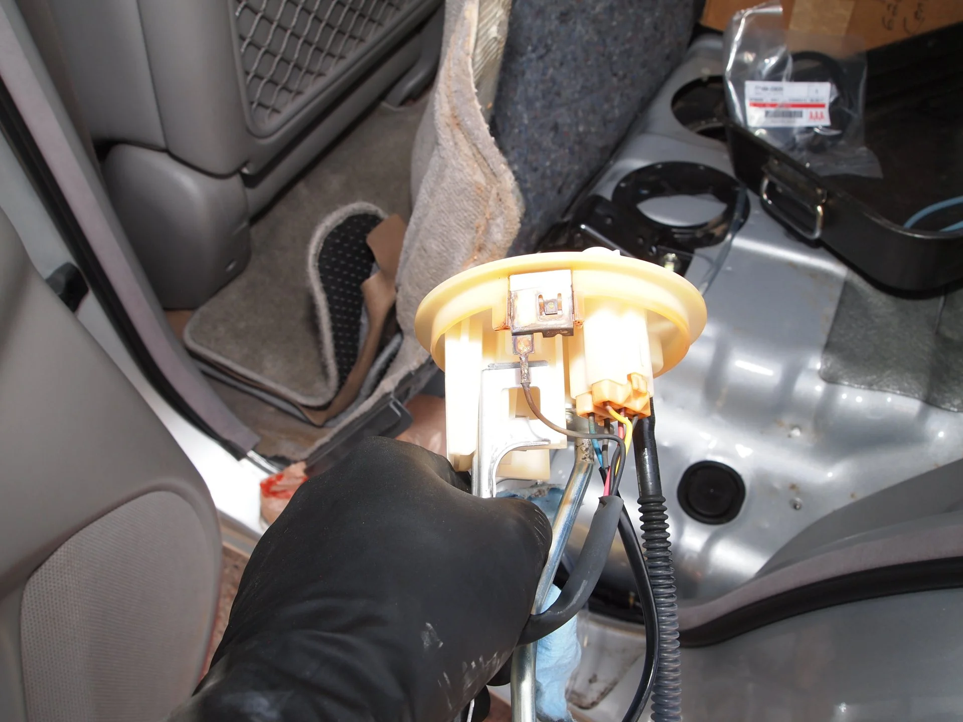

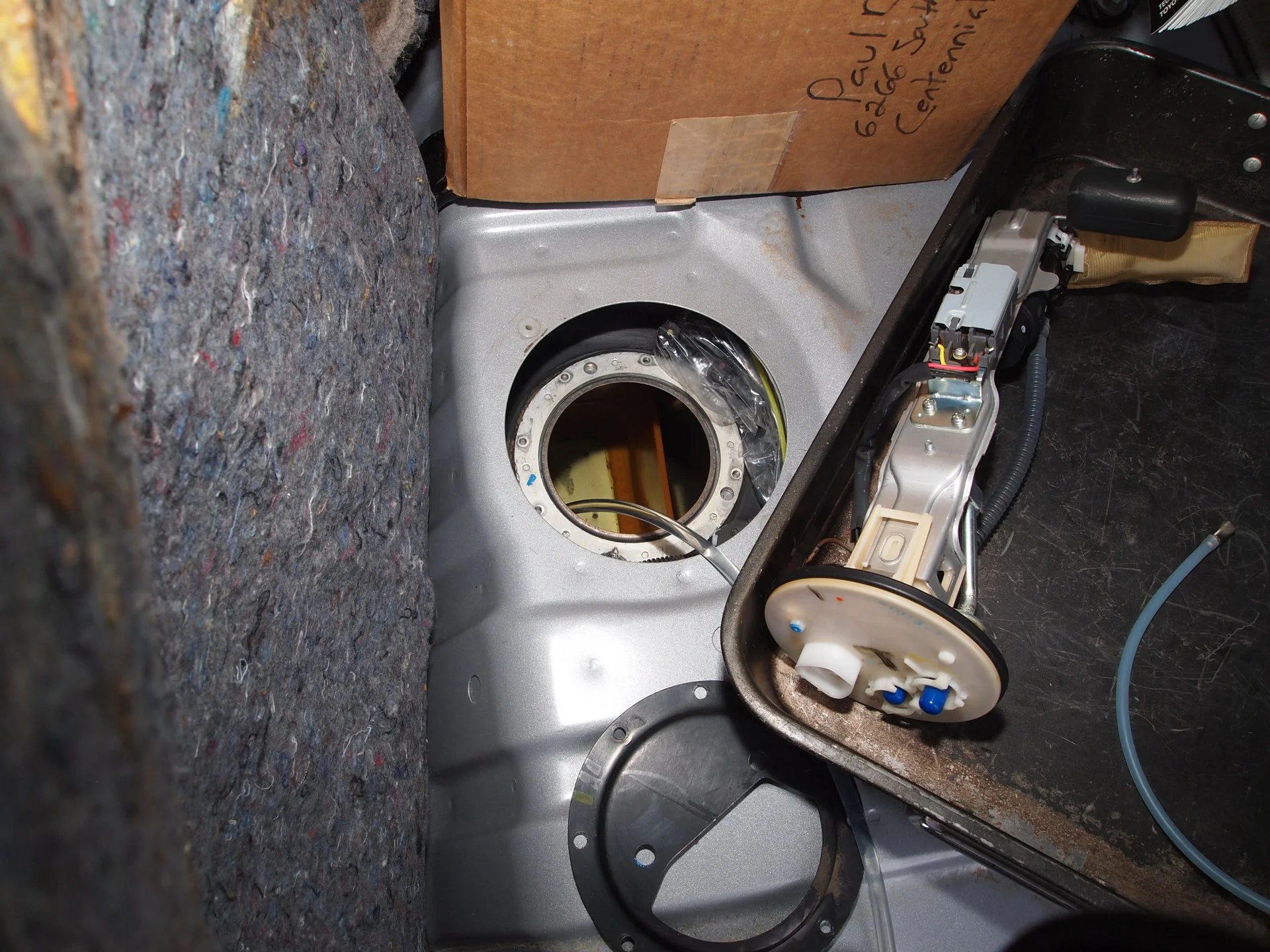

Best way to see top of tank, is through the hatch under second row seat. It same hatch we pull to replace fuel pump.

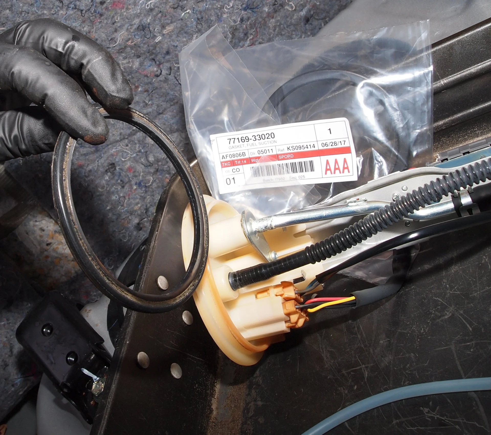

Sometimes when fuel pump replaced, old seal reused or seated poorly. But as you can see there are other points that could leak, after worked on.
