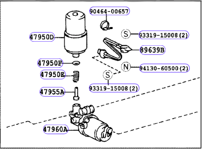

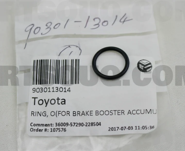

Your tech is lazy and causing (and costing) you unnecessary repairs and potential damage to your new master. Never a good practice to re-use "non-reusable" items especially a 22 year old o-ring. Installing another O-ring that "looks close" err... not good.
2 min of searching for the correct O-ring revealed
Shown below as 47950F
While the new o-ring the tech selected may have fit, was it also the same thickness and material composition as the OEM one? I would be concerned the one used may not be rated for use with brake fluid. I would honestly only use the correct part for the o-ring and I would not consider anything else as a potential issue until that was corrected and the issue continued.

If it is the seal between accumulator and pump. Use only the Toyota seal. Brake fluid will damage rubber not made for brake fluid. Which @abuck99 posted for you. Very easy replace.

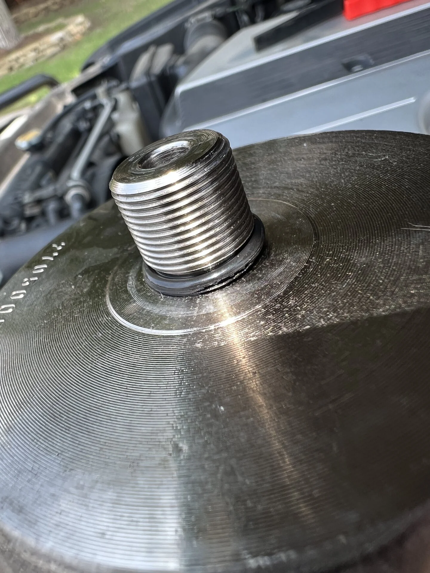

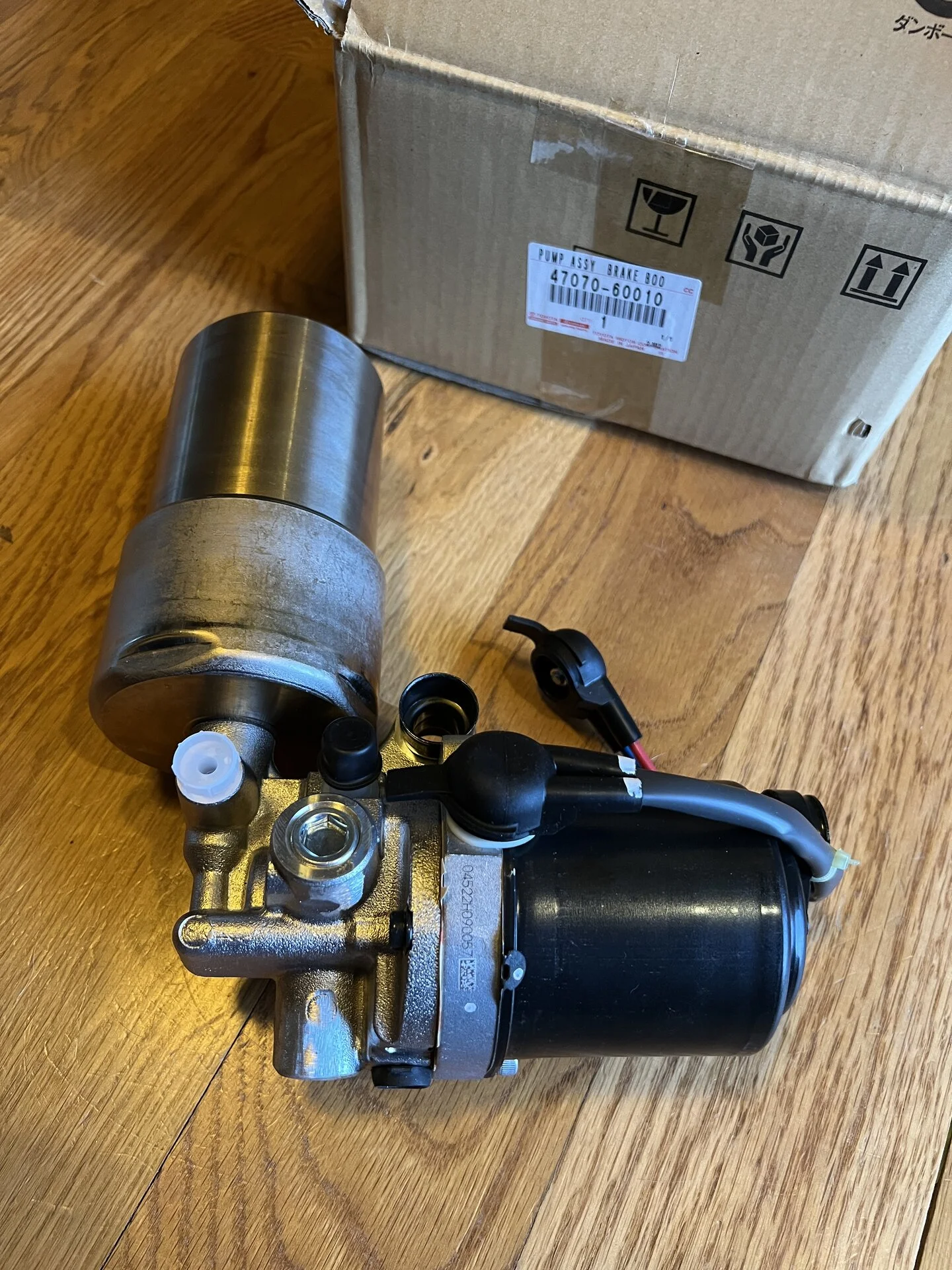

How do you replace this o ring? Pull entire master cylinder I’m assuming? I replaced my accumulator and motor about 15k miles ago (max) and my accumulator is pouring brake fluid out this morning. Drove 300 miles yesterday and no issues this came out of nowhere. This is a new oem unit.
Actually I was way off on my mileage. I replaced it 4k miles ago.

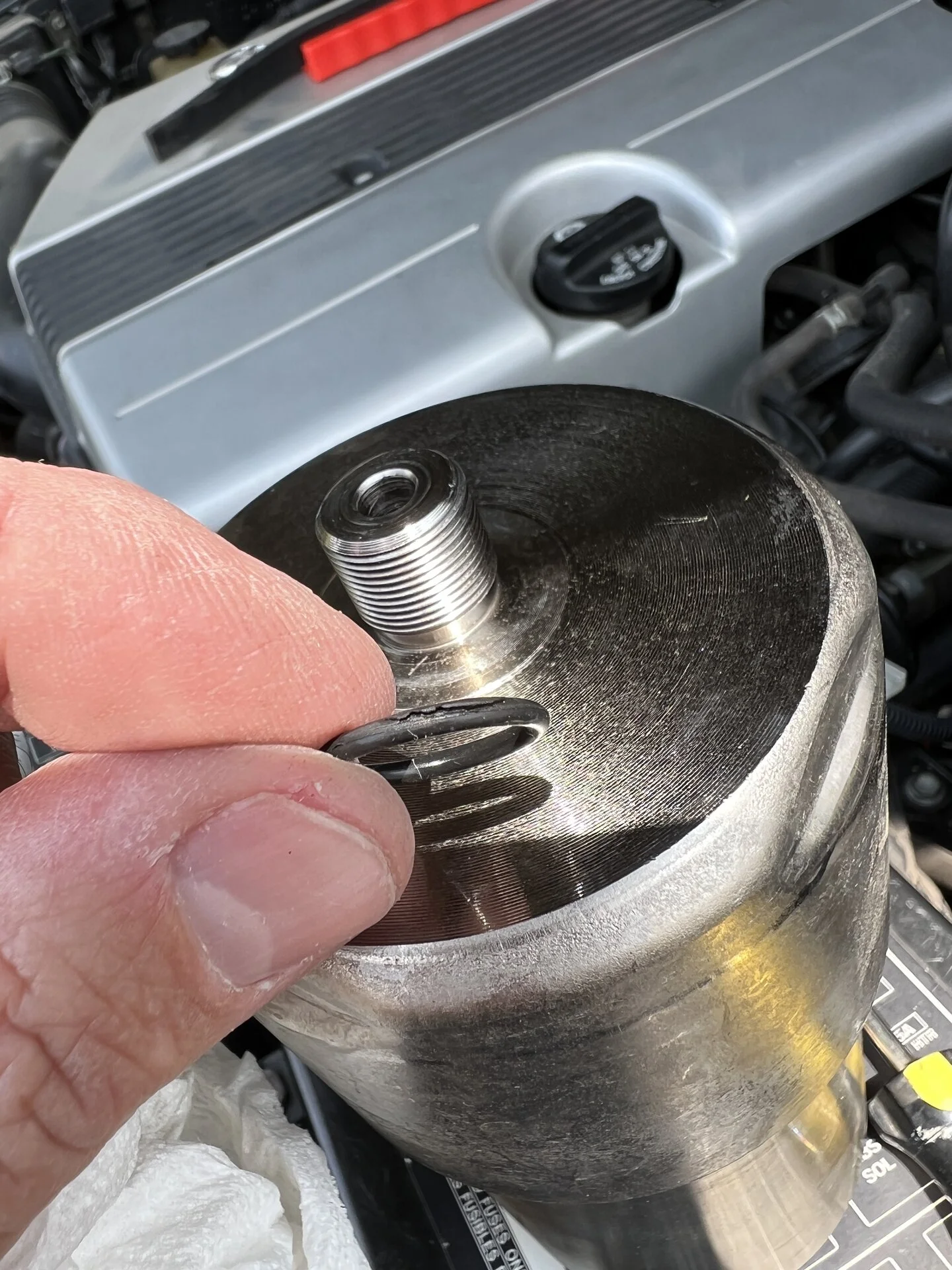

More info: pulled out the accumulator and the o-ring is damaged from the factory. I’ve got a new o-ring ordered from local dealer. What a PITA for an $800 oem part.

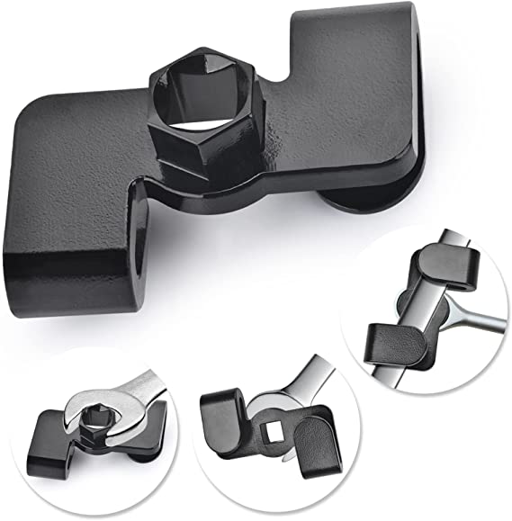

I wonder if this would work, I may try that.
Amazon product ASIN B000N37EEY
Do you have a leak too or just replacing accumulator? The only issue I had was when replacing the accumulator I couldn't tell if I had the right torque. I never really looked for the SST but I see they are pretty high.
I'm replacing the accumulator. That Performance Tool W1272 is the one I was going to pick up at O-Reilly's. It's 1/2 the price on Amazon but it wouldn't have gotten here by the time my parts came in. It'll work in place of the Toyota SST, which has 8 removeable roll pins where as the W1272 tool has 4 roll pins. I don't know if the roll pins are removable so you may have to cut 2 of them off to make it work with the accumulator.

I ended up just buying the PT W1272 tool which made the job a breeze. The pins must be held in place with loctite because they came out fairly easily once I heated them up.
