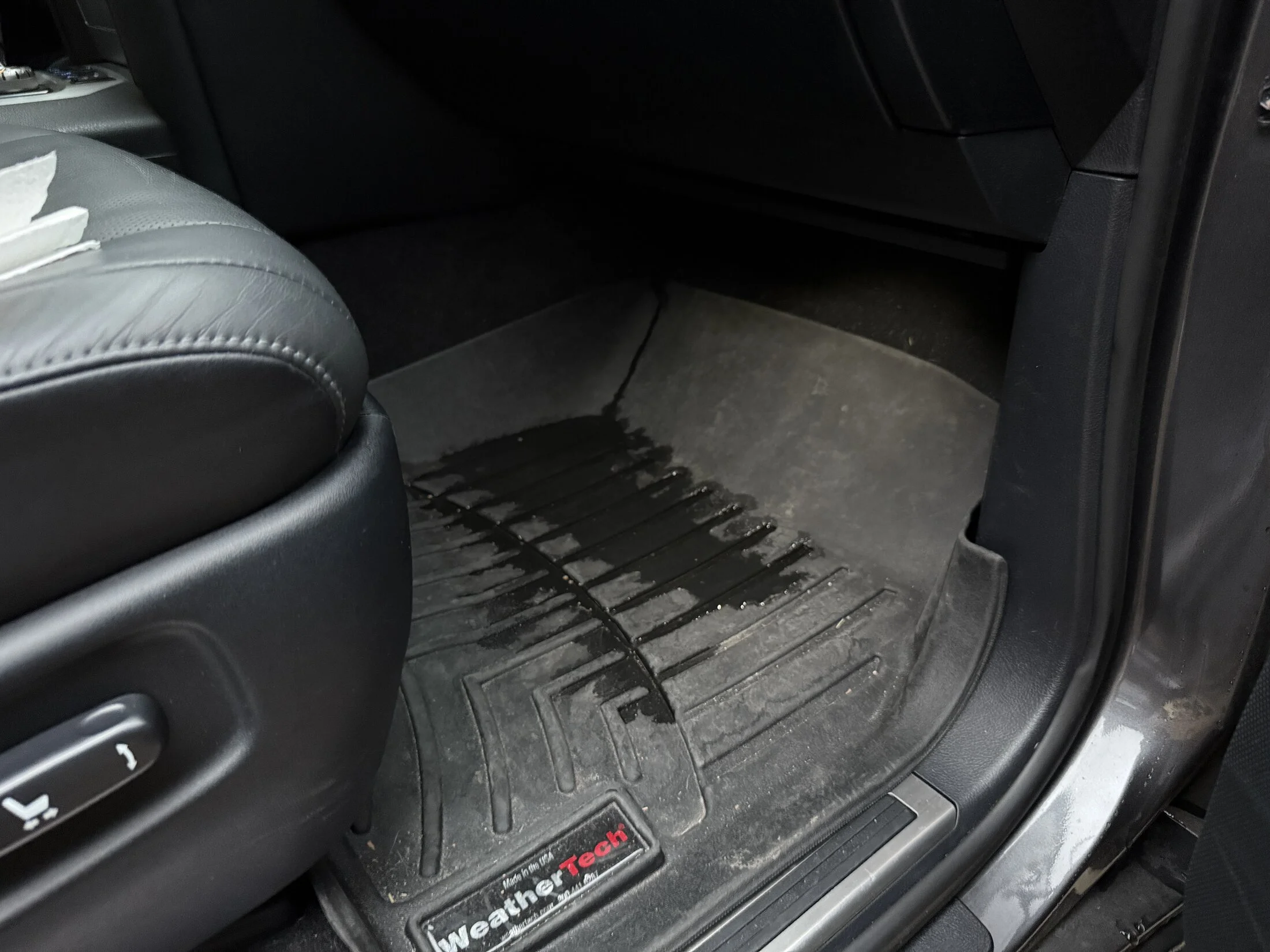

I have a 2021 LC and noticed water on the floor mat under the driver’s side glove box. It rained a lot last night. I had the windshield replaced about two years ago at a Lexus dealership and did not notice any leaking until now. Could this be anything other than a windshield issue? I have noticed the ac smells musty when run. Could this be an ac issue? Clogged drain? Thanks for any input!
This is the infamous cowl leak. There's a thread here somewhere with how to fix.
agree ⬆️ likely cowl issue. was either not replaced with the windshield install or the the cowl not installed correctly (possible broken tabs)
I would strongly advise pulling the door sill trim on that side and removing any water that has collected around the wiring harness and connectors.
There may not be any, but if there is it can damage your floor harness, and it is quite expensive.
The cabin air filter is soaked.
Makes sense. The water leaks along the bottom of the plastic cowl cover into the fresh air inlet for the AC, which is directly above the cabin filter. It then drips down through the AC system into your floor board.
Thank you all for your replies and all the helpful information. I specifically took it to the Lexus dealership knowing I would overpay for the peace of mind they would do it right. I assume they will deny they did anything wrong. Very frustrating.

I'm a little late to the party here but jave been having this issue for months. Spoke to a good handful of toyota parts depts and they all have the same conclusion that it's a design flaw. I also worked with a local glass shop to diagnose the location of the leak. Seals on the windshield were good, drains unclogged, cowl seated fine.
The problem being a poorly designed vent location(below the cowl) where the cabin filter draws in air for the fresh air setting. You can easily see the cabin filter from under the hood, and it's a substantial gap under the cowl. Any sort of heavy rain or flow of water will go over the lip of the vent and into the cabin filter area. The seal on the plastic flap that flips over above the filter when you change the setting is definitely not rated for water. I'll try to throw up a video to show what's going on in there any time heavy water ran down the windshield at the wash if the post allows.
