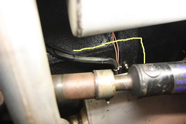

There is a gradually worsening fuel line leak, which I have isolated to the
actual line from the main tank (under passenger seat) to the Aux fuel switch.
Here's the line going up towards the main tank.
I located the drip, and gently wiped the line. There is a small oval patch that
looks either burnt? or somehow weakened? The line does not touch the exhaust,
but does run nearby. Immediately after wiping off the line, gas seems to seep
thru the actual wall of the rubber hosing here (see 2nd pic below, close-up)
So it's really stinking up my garage, and even my house. I went to a local 24hr
autozone to see if there was a way to fix this without replacing the whole line right
now. The guy told me that probably wasn't a good idea. True? I was hoping I could
just get a bigger tube to place over like a sleeve and ring bracket down to seal the
leak, possibly temporarily. I'm not sure if the main-aux switch works, but if so, as a
last resort, I guess I could siphon out the gas from the main, and put it in the aux?
Any ideas on how I can quickly get this fixed? Thanks in advance for your expertise!!

I'm no expert, but it appears from your pictures that the fuel line is very close to the exhaust. If you can reroute the line a little further back, there appears to be a step up in the tub and would give you some breathing room.

I decided to go under and just clamp the line, but couldn't find anything that could fit in such a tight space. I ended up using a few spare surgical clamps I had from my job, that worked out great! I cut out the leaking segment, which was about 1.5 inch of tubing, and put in a small metal $3 inline filter which actually fit nice. This fixed the leak and got my wife off my back for now. :princess:
So, it's no longer leaking gas all over my wife's driveway for now. But, I'm not entirely comfortable driving it, with this inline filter patch job so close to my exhaust. For now, it's on injured reserve list on my driveway until I can get a better fix. So far, almost 12 hours and no signs of leak on the cardboard. :clap:
I don't know why this line was routed like this. This is the only area where the tub gets close to the exhaust. The line gently loops around and heads back towards the front where it joins the fuel switch. The inlet to the fuel switch is actually in line with the hole where this main line entered the tub, and there is more "breathing room" here (and further back by the aux tank). I want to just run the main line directly here, but I'll need some kind of right angle elbow off the fuel switch. Do they make that? I don't know if I can just use fuel line, because I think it will kink making this sharp turn.
My question, where can I get steel-braided fuel lines to replace this entire line and fix this right? I asked at the local autozone, and the guy didn't seem to know what it was, and didn't any in stock.
Sorry for the long post w/ no pics. I'll edit and post pics of my hack job, as well as the segment I cut out. There are diagonal scrapes, as if it rubbed against something? It was also right at the gentle bend, which was kind of close to the exhaust (but seems like at least 1.5 inches clearance away?). Could just be an area of weakness at the bend close to heat? Regardless, I don't trust the entire line now. May also change the other fuel lines too while I'm at it.
