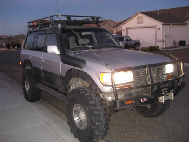

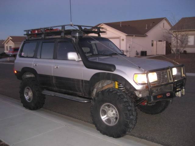

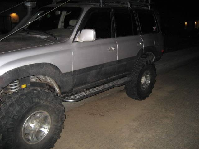

There are 3 mounting points on the PS slider.
One is a couple of plates that wrap around the frame below the rear PS door. In the middle is a fixed plate with 2 holes that screw into the frame. The front mount is a longer control arm bolt to a fixed plate.
The front mount is obviously immobile, and the rear mount just wraps around the frame. The center mount with the 2 bolts doesn't line up by about 3/4" - so I can't get those in.
When I remove them for paint I'm going to have to redrill those holes so I can bolt up the center mount.
