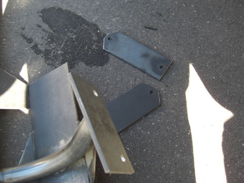

Yeah, I'll try to get some pictures and measurements tomorrow. The holes on the plate seem to match up with the frame as far as distance apart - but the mount itself seems like it may be mounted a bit off on the sliders tube itself.

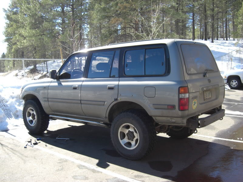

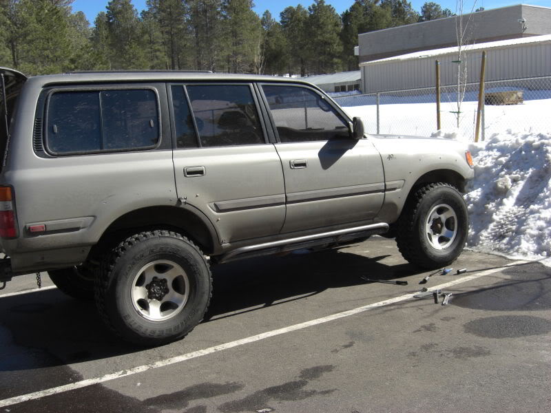

Threw them on...

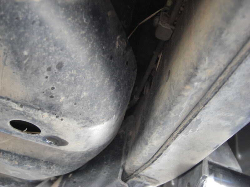

Question, how does this work: In the middle (drivers side) I had to slide the plate between the frame rail and the brake lines but I doubt I can fit the nut and plate through the lines and everything.

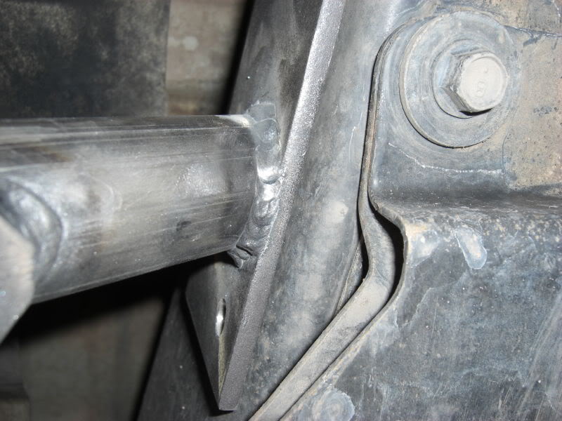

Passenger side, how am I supposed to secure the center rigger?

Chibo - I took a flat screwdriver here and gently pryed near that screw clamp thing to get enough clearance for the plate and secured nut to go through:
For that center piece on the passenger side, there are secured nuts inside of the vehicle frame. You should have 2 small bolts (14mm) that if they line up will screw that plate to the frame.
I have no holes in my frame where the plate is. :meh: I think I'll just MIG the thing on at work, it's close enough.

Ok, upon reinspection I do have the holes in my frame. One lines up fine but the bolt doesn't thread, the other is off like 3/4". I'll mess with it when I have a warm garage to use.

Notes upon actually driving the truck - these stiffened the frame more than stock or something - I feel more through the chassis. I think this is a good thing. It gives me hope for my 240sx noodle chassis and the cage going in it. :flipoff2:
Yeah, I felt the stiffness feeling too with them on compared to before I had them.
