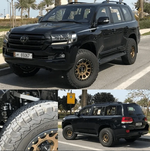

In the street, I dont noticed much even when closing the bypass tubes and compression adjusters or CDC(icon), mainly tire pressure plays the role of comfort during potholes and speed bumps, but again maybe thats just me. 3.0 Coilovers had the same issue as the 2.5, Not enough lift. However offroad the 3.0 feels smoother on the big hits, and the 2.5 smoother on the small stuff. Maybe thats just valving.
My current setup, ICON Coilover, Filthymotorsports king rear shock, OME Rear springs and camburg UCA. Perfect balance for me.
