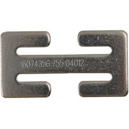

I actually find LATCH in the Prius more cumbersome to install. The FZJ isn't a vehicle that requires a seatbelt lock as one is built in (the case of my old 95 explorer was NOT the same, it did not have a lock).
Whether you use LATCH or the seatbelt, you have to put your weight into the seat to tighten it down.... it just won't be tight enough just putting it onto the LATCH hooks and tightening, you're still having to get the seat down into the pad a bit. The FZJ makes it surprisingly easy to get tight.... once your knee is in and the seat is buckled through, pull the bottom as tight as you can, then pull the top ALL THE WAY OUT to engage the seatbelt lock. Slowly let the top pull the remaining belt through. Pull tight as needed.
