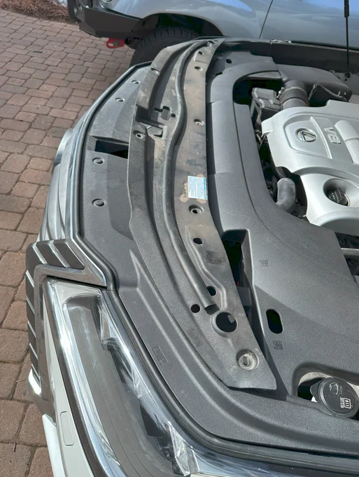

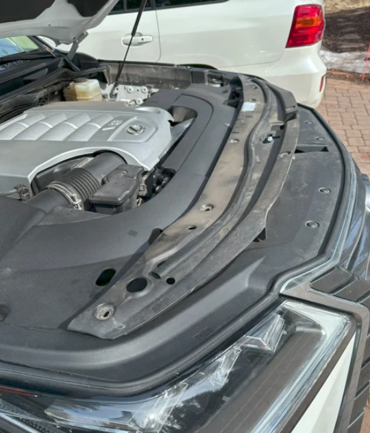

I removed the underhood plastics on my 2010 lx570. I noticed the landcruiser version has a fender to fender rad support plastic shroud while the lx has a very small center section and relies on the side panels to connect to the center section. Does the 2010 LAND plastic panel work on the lx? Just to clarify I'm talking about the thin plastic cover not the fan shroud
I bet it would clip right on. Haven’t seen it done though. A couple have just chopped the back 2/3of the side shrouds for the lx.
The Land Cruiser front profile is quite different and not likely to fit the LX.
Here's a thread with some examples of cuts to the LX570 covers
Oh, yeah, the front ends do differ. Good point!
Just chop up the LX panels. When doing so you can also trim the center piece so the radiator is more visible for inspection. As long as you don’t go past the hood-mounted gasket it won’t impact airflow management through the radiator.
Different years, but a huge difference. 13 LC overlayed on a 16 LX.
