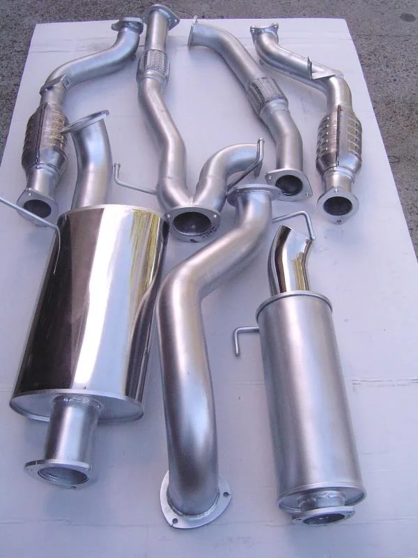

Hi aliq80,
It does not matter whether the steering is on the left or right with the Beaudesert Exhaust. I think it will be the same for the other brands as well. I have attached a picture of the system.
